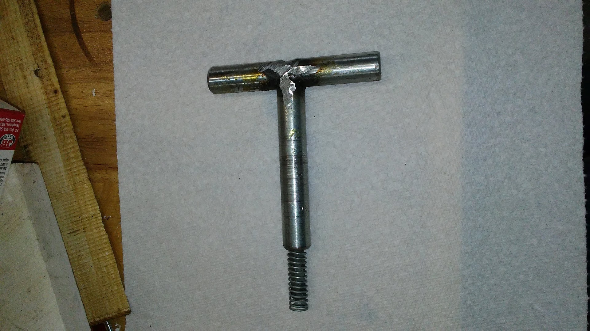

I (roughly) made a spring loaded chuck tool.
Attachment 22907
Kinda rough but works well.

functionality for me always wins over form.
how does it work actually?
The spring pushes the tool out of the chuck so that one cannot leave the tool in the chuck when you turn it on, I personally know someone who has done that a couple of times.
Thanks for the clarification. Intelligent safety related idea.
