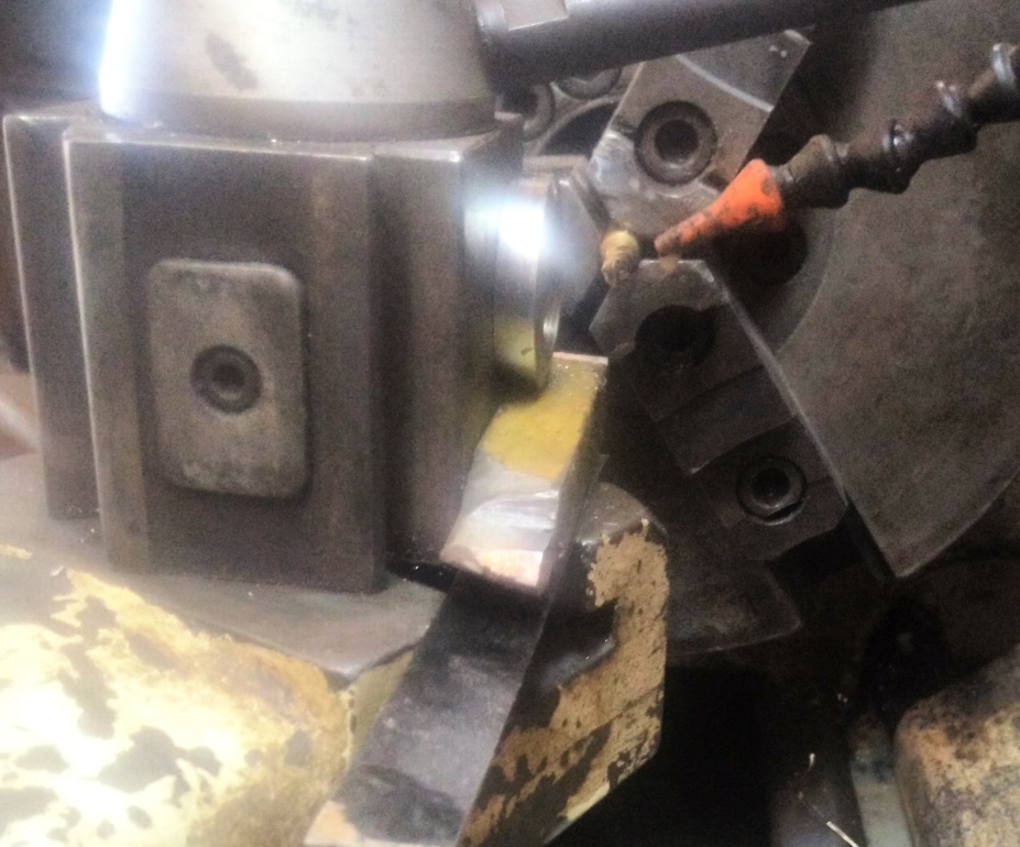

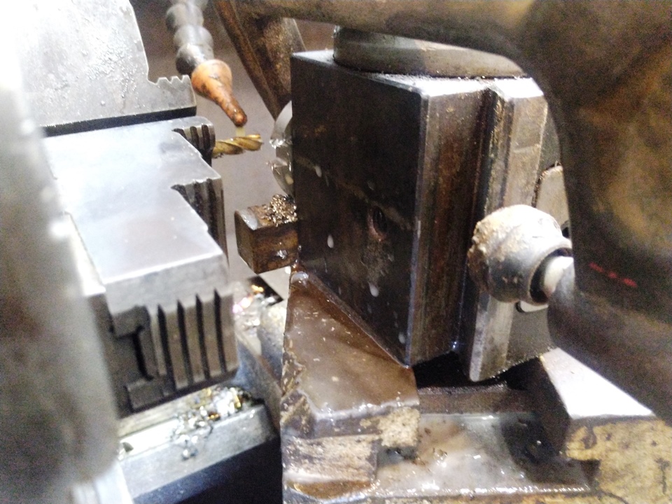

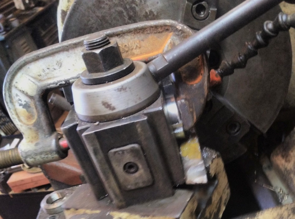

But today I just used a C clamp and a tool shank for height to hold the quill nut I made
Attachment 41238
Attachment 41239
To set the height after the first slot was cut, I used a piece of banding material and placed the slot in the bottom position on the tool shank
Attachment 41240
