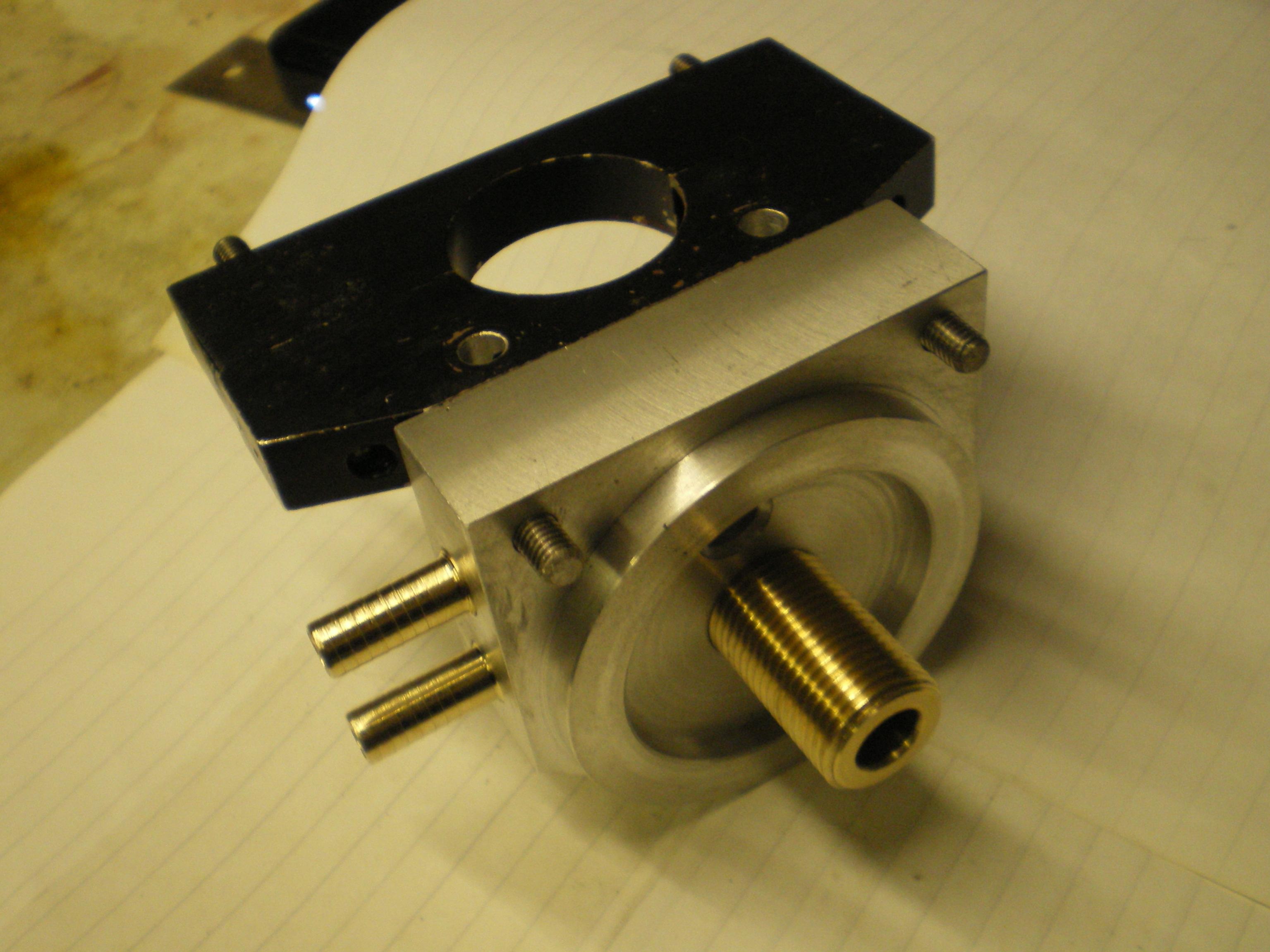

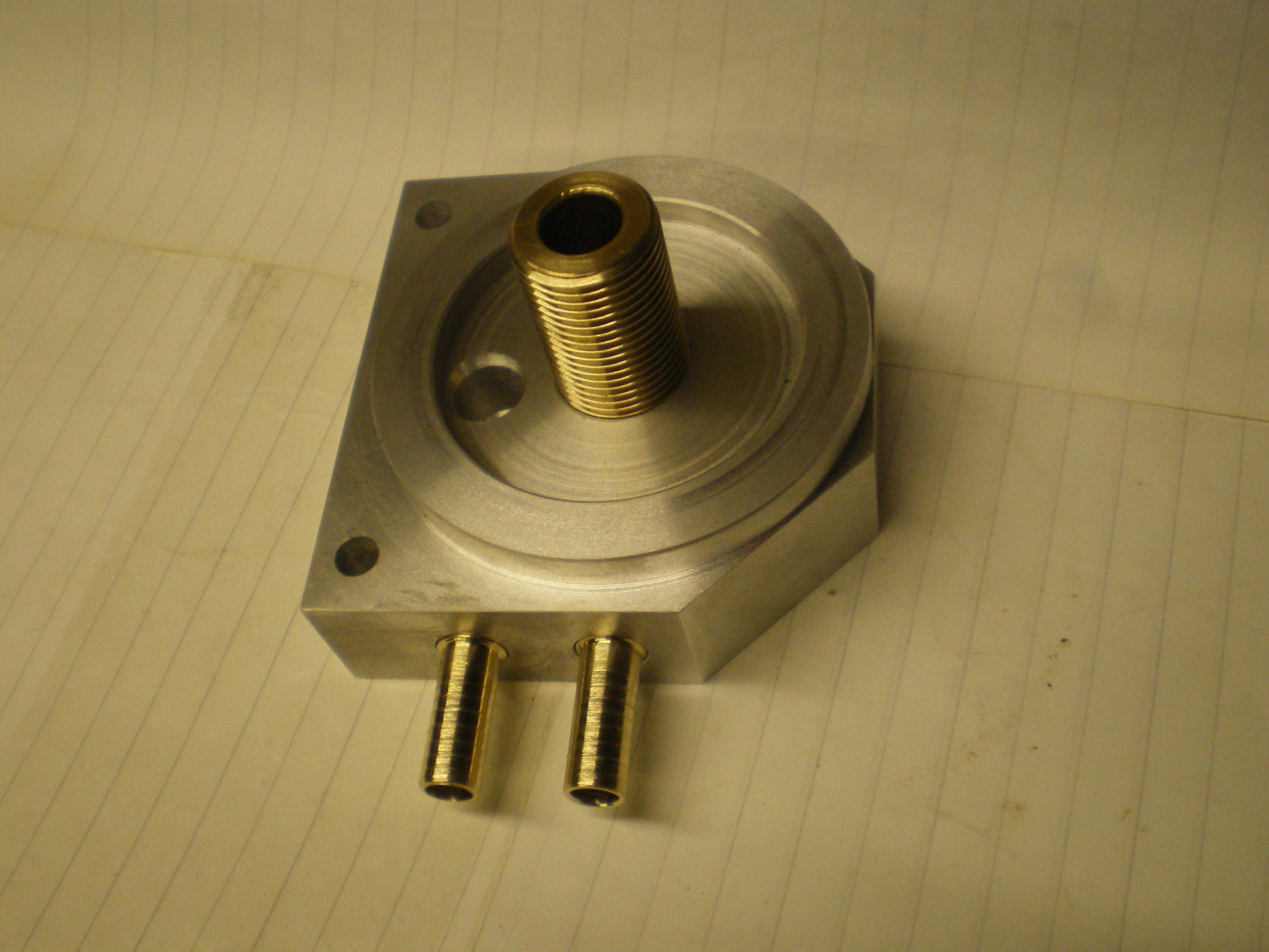

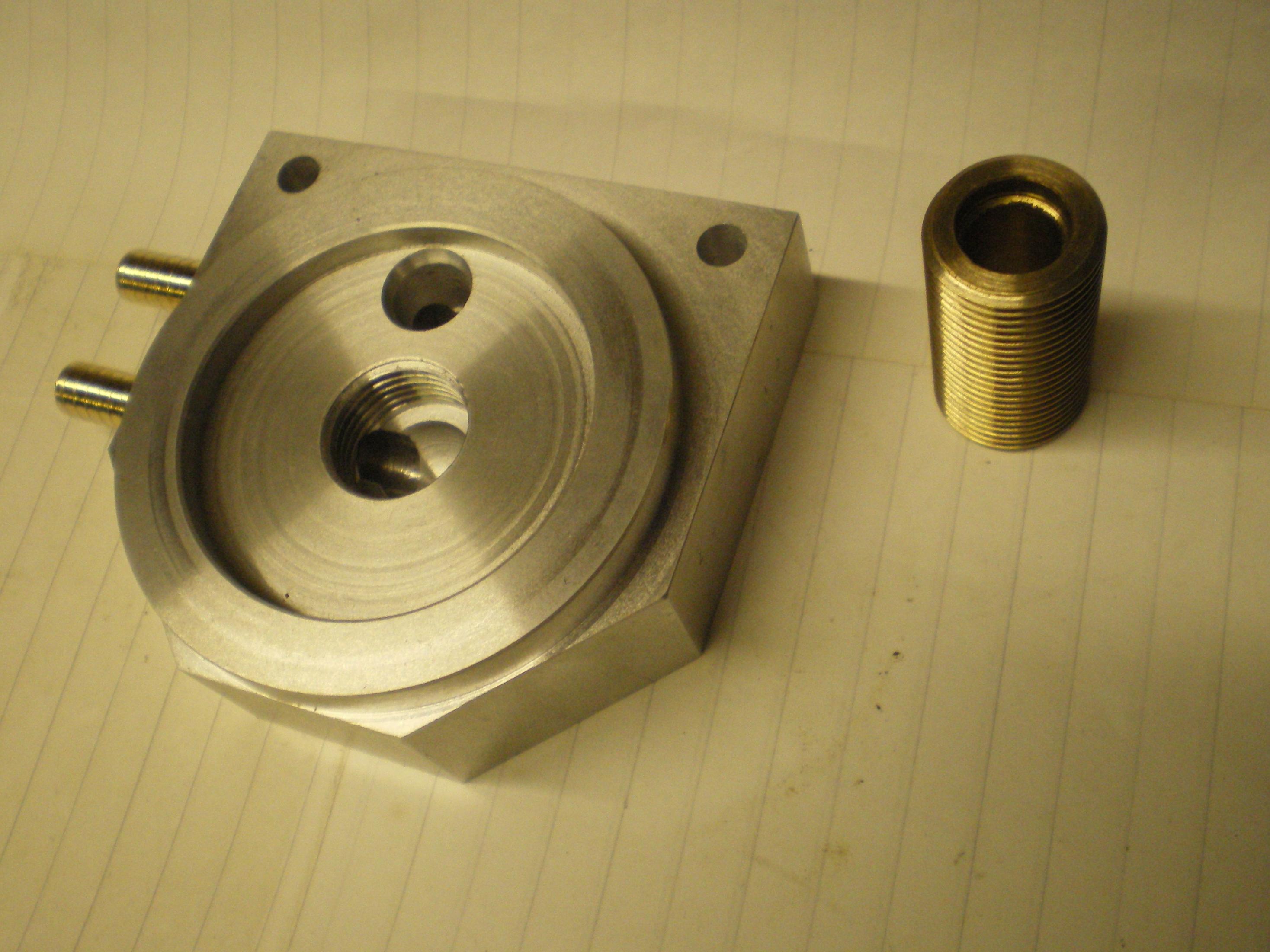

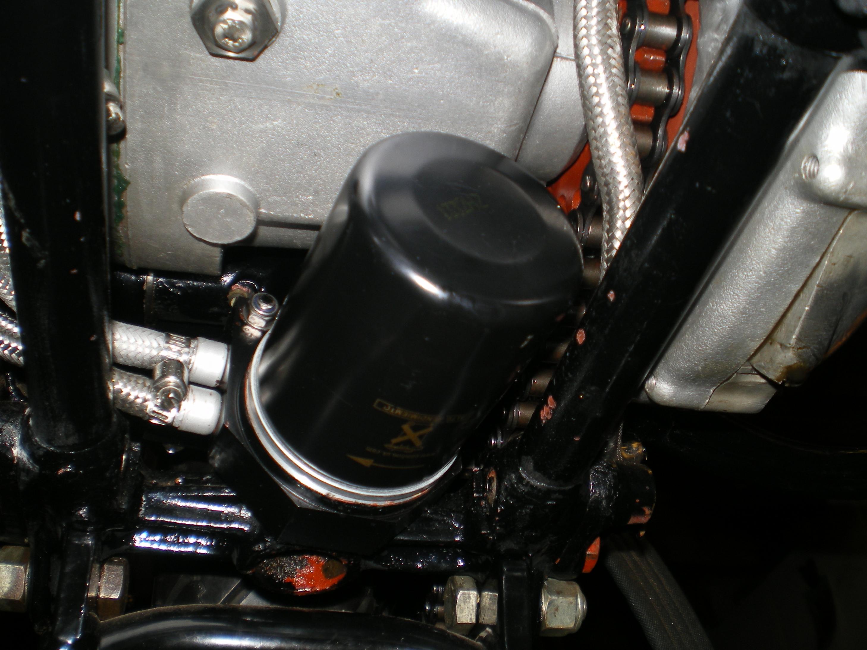

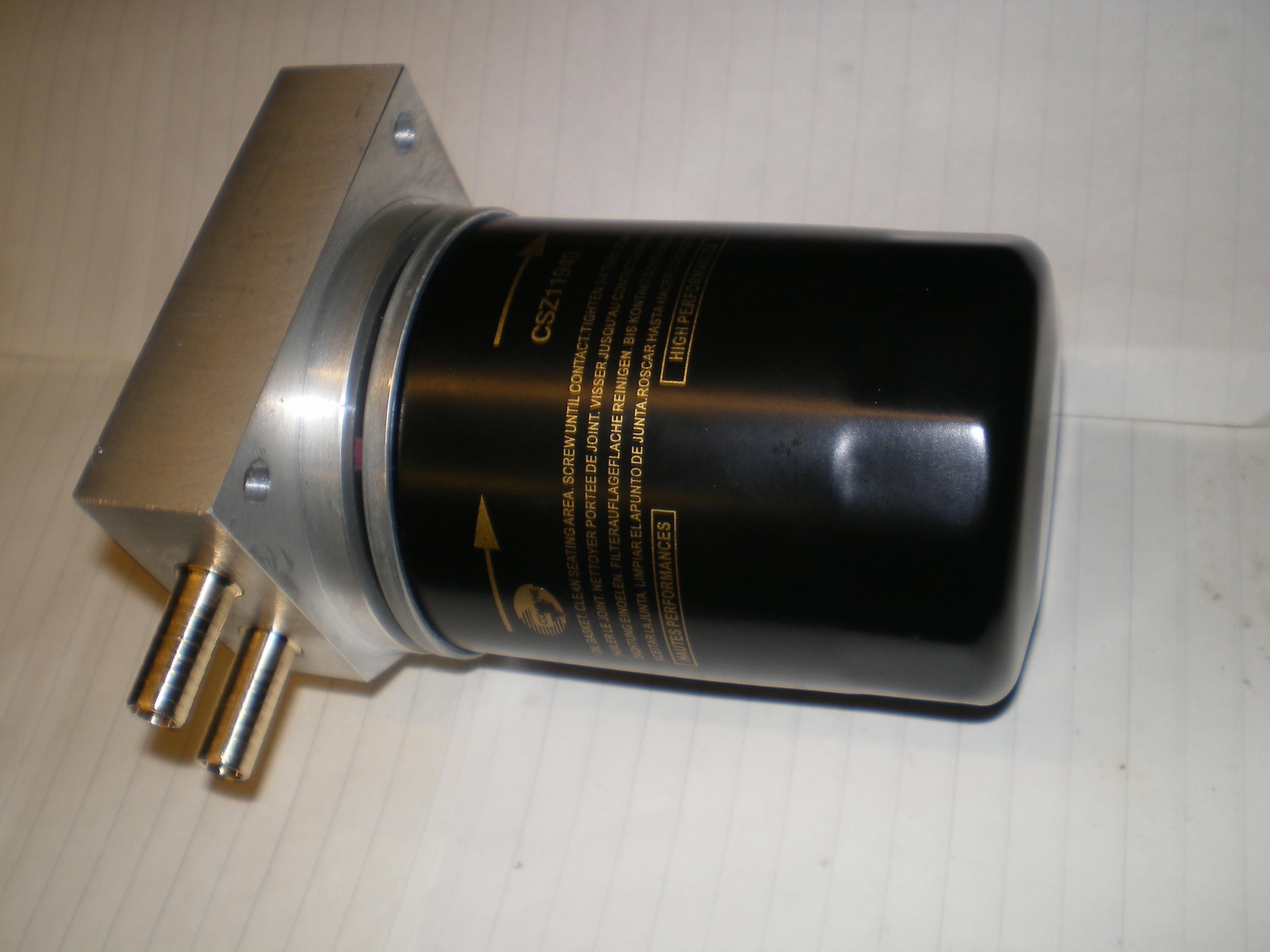

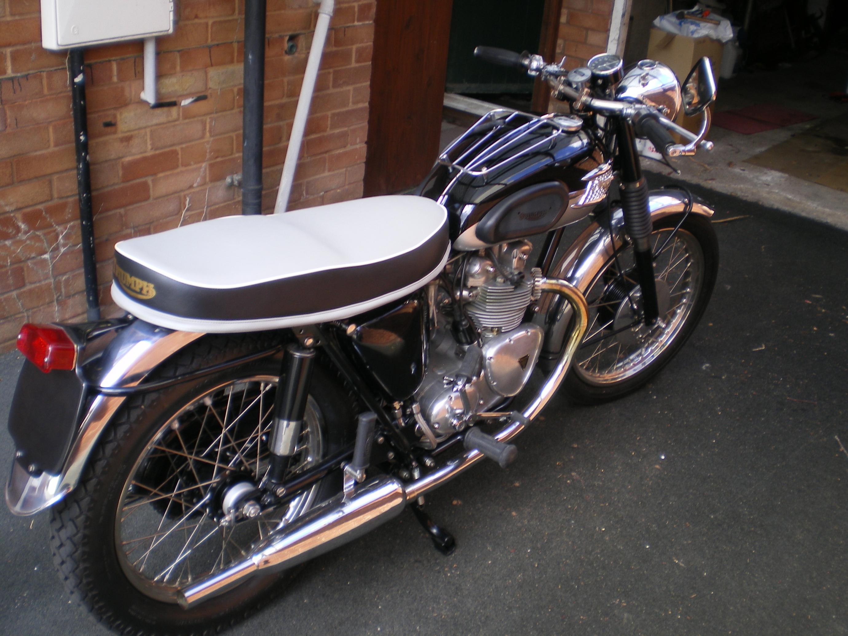

Needed an oil filter for my classic Triumph T100SS but the usual conversion is a Norton type which puts the filter cartridge in a vertical position. I felt this to be vulnerable as it drops below the frame rails, I also wanted the oil pipes to enter and exit on the gearbox side and so came up with this billet horizontal version.

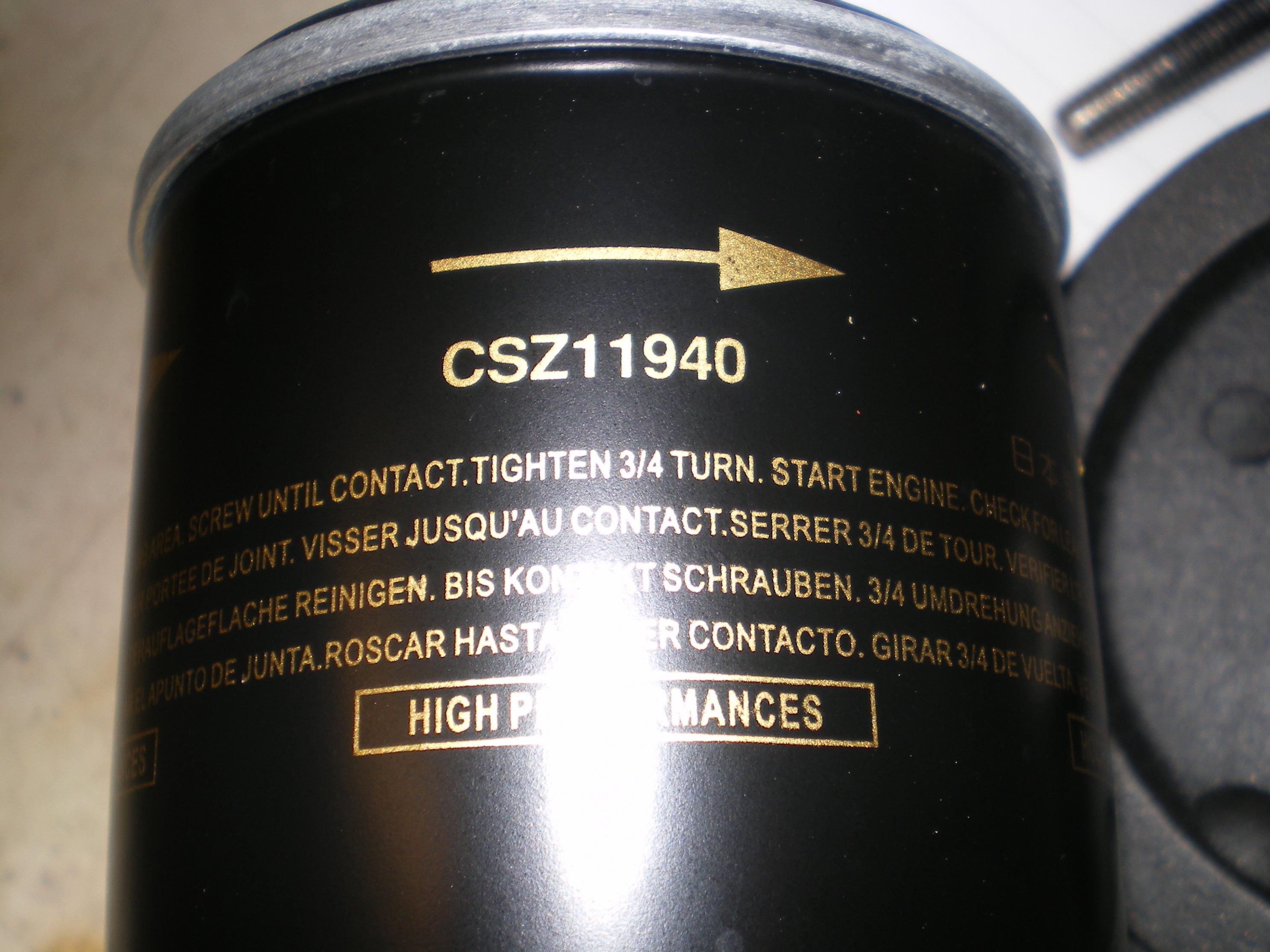

I used the smallest diameter cartridge available at my local motor factors but I believe there are smaller to be had, this dictated the sizes for me.
It looks a little bulky but is cast alloy so weight is not an issue, the mounting bracket clamps on the down tube behind the gearbox and is not visible when looking at the bike and is now out of harms way.

Very sano install and beautiful bike! :thumbsup:

Hey olderdan, Great job on the oil filter adapter! I got a 1970 TR6C Triumph Bobber project that I found an aftermarket adapter that will work on my bike, but sure like the one you made. Those old engines will last alot longer if we filter that oil! Thanks for sharing!
Oh yeah almost forgot the most important part, LOVE THAT BIKE!! Take care!
Really excellent build Olderdan! :clapping: Simple, clean and well thought out. Beautiful ride too, looks pretty stock except for the mirror and bars. Thanks for sharing this with us.

Well spotted about the bars, they are stainless as is pretty much everything on the bike, mirror is an essential in the UK these days.
Usual mods ie rotary oil pump, electronic ignition. unleaded.
Dont need speed any more at my age just a nice smooth ride.
Interesting that they are stainless and not nickle plated. Look like a comfortable set though. Nice mods too!
