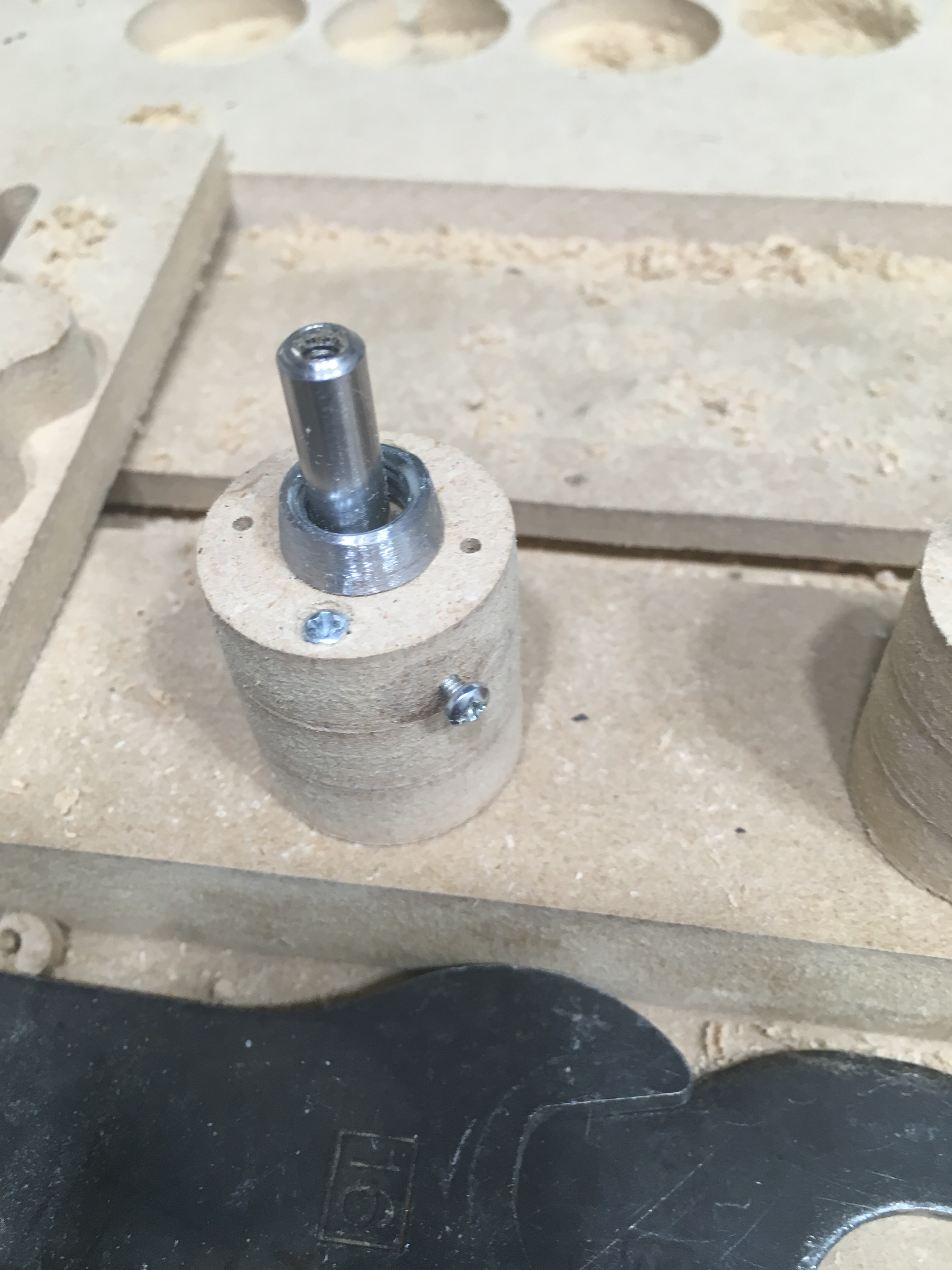

    I designed these jigs so I could mount tool bits of varying length faster and more precisely on my cnc router. I use mostly bits with 1/8 and 1/4 shanks, so these jigs have not been tested with larger diameter tools. Also, from the pictures, I've tested these jigs with an engraving tool, a PCB drill, and a single flute end mill. All three tools vary in length, and the pcb drill uses a Bosch 1/4-1/8 shank adapter. The 4th round piece on the right is an mdf made locking washer to help me pull out the tool when my fingers are slippery or if the tool sits too tight in the jig.
    I have two jigs for different shape tools. The jig on the right accomodates the Bosch adapter, so it has a pocket to accomodate the adapter's head.
    The fourth piece on the far right is not a jig. I use it to pull the tool out of the jig when fingers are slippery or the tool is tight. I made the clearance washer from a threaded 1/4-20 nut.

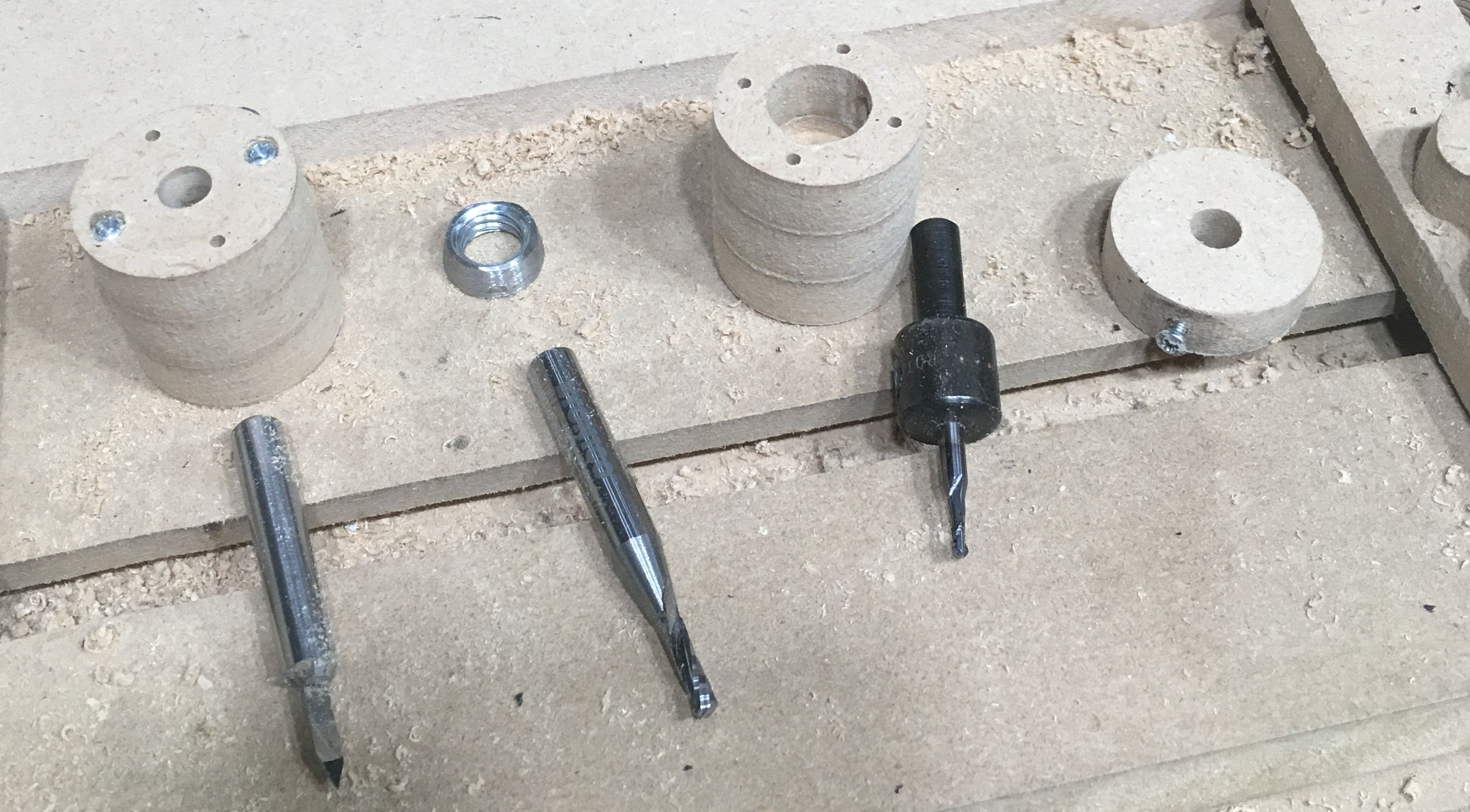

    The two jigs with tools inside. Notice the tool tips flush with the bottom of the jig. Washer is in center.

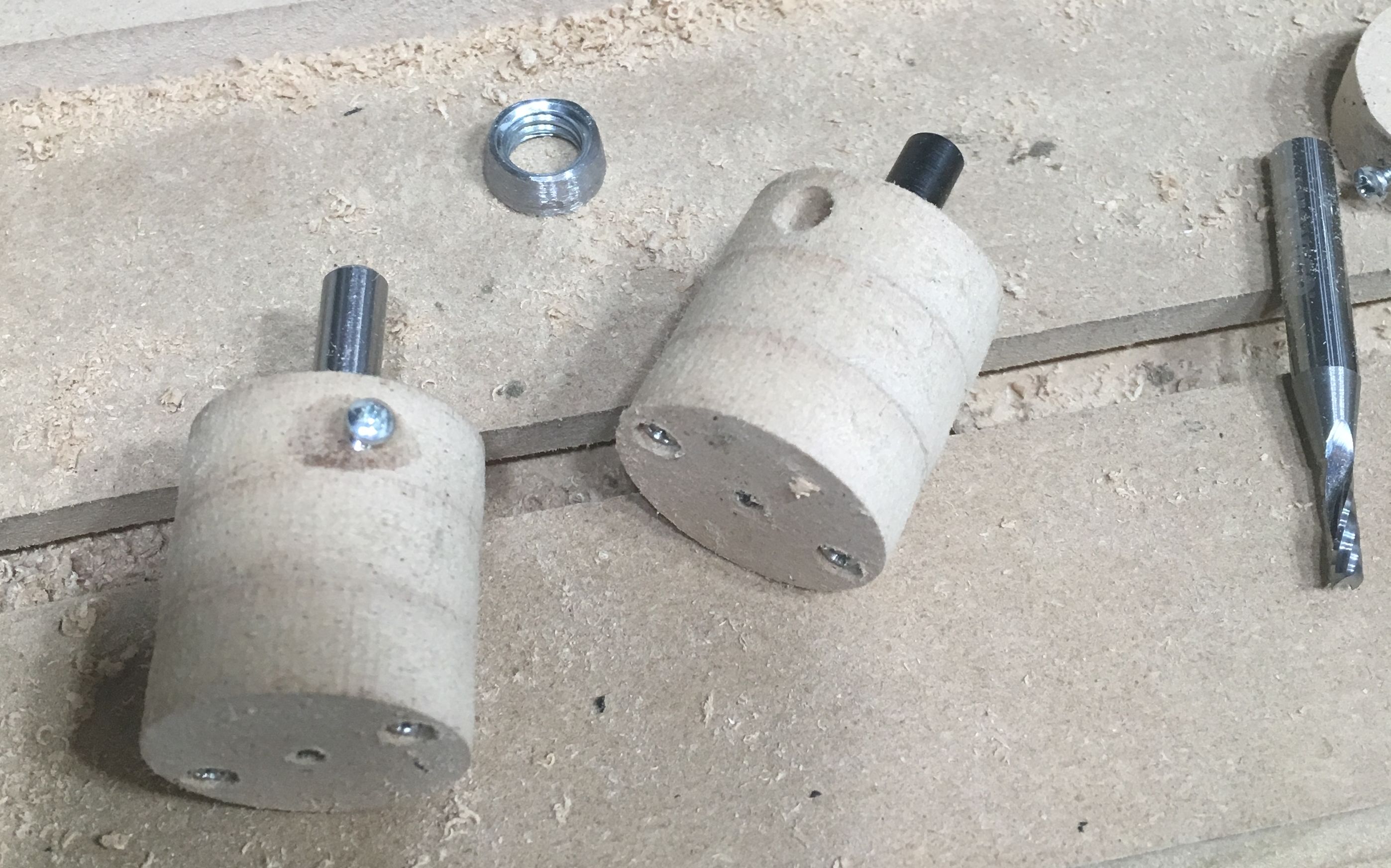

    Jigs are all the same height. Notice different length of tool. Also, notice locking screw on left jig, and access hole on right jig.

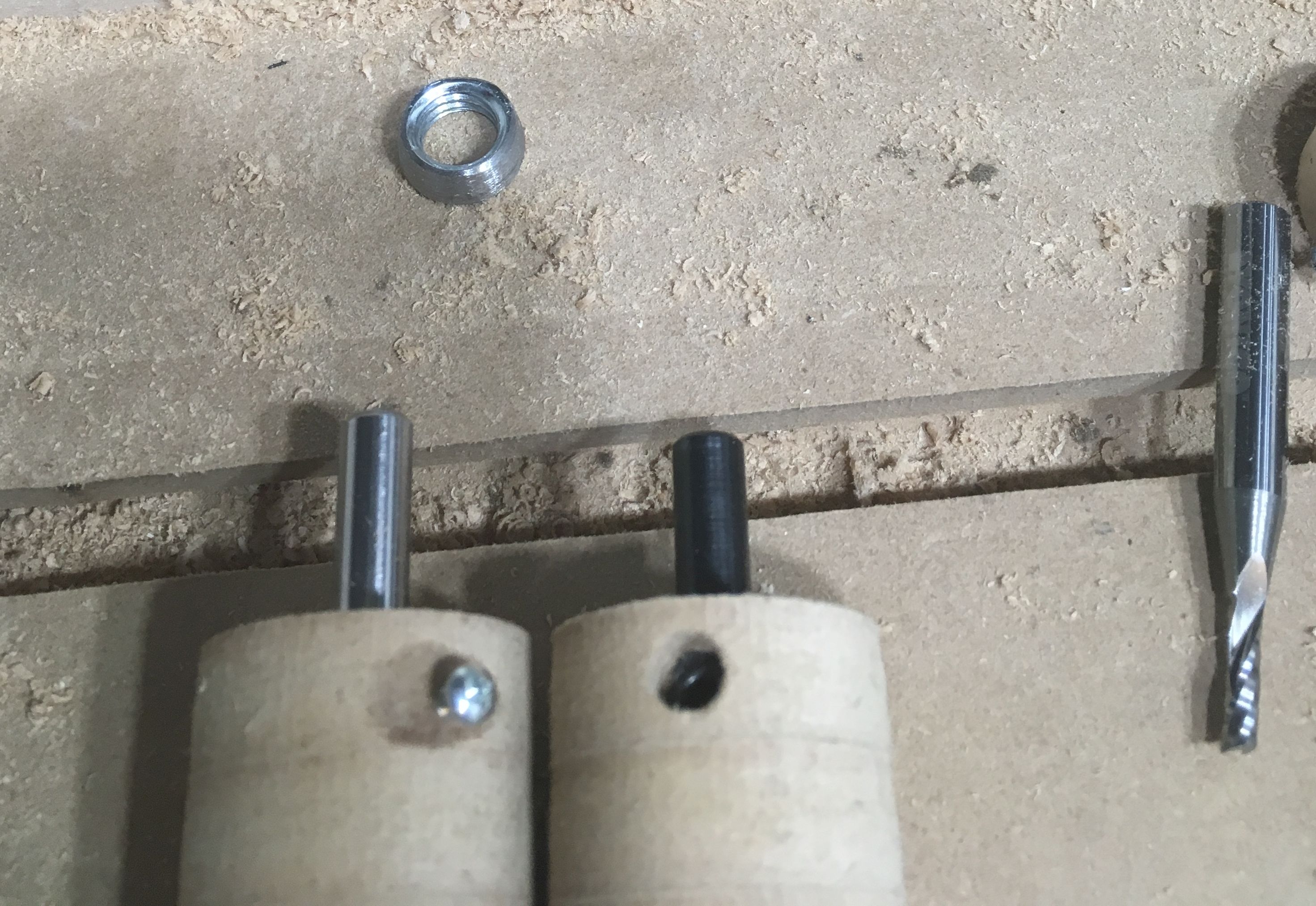

    Washer sitting on top of jig before mounting tool in chuck.
