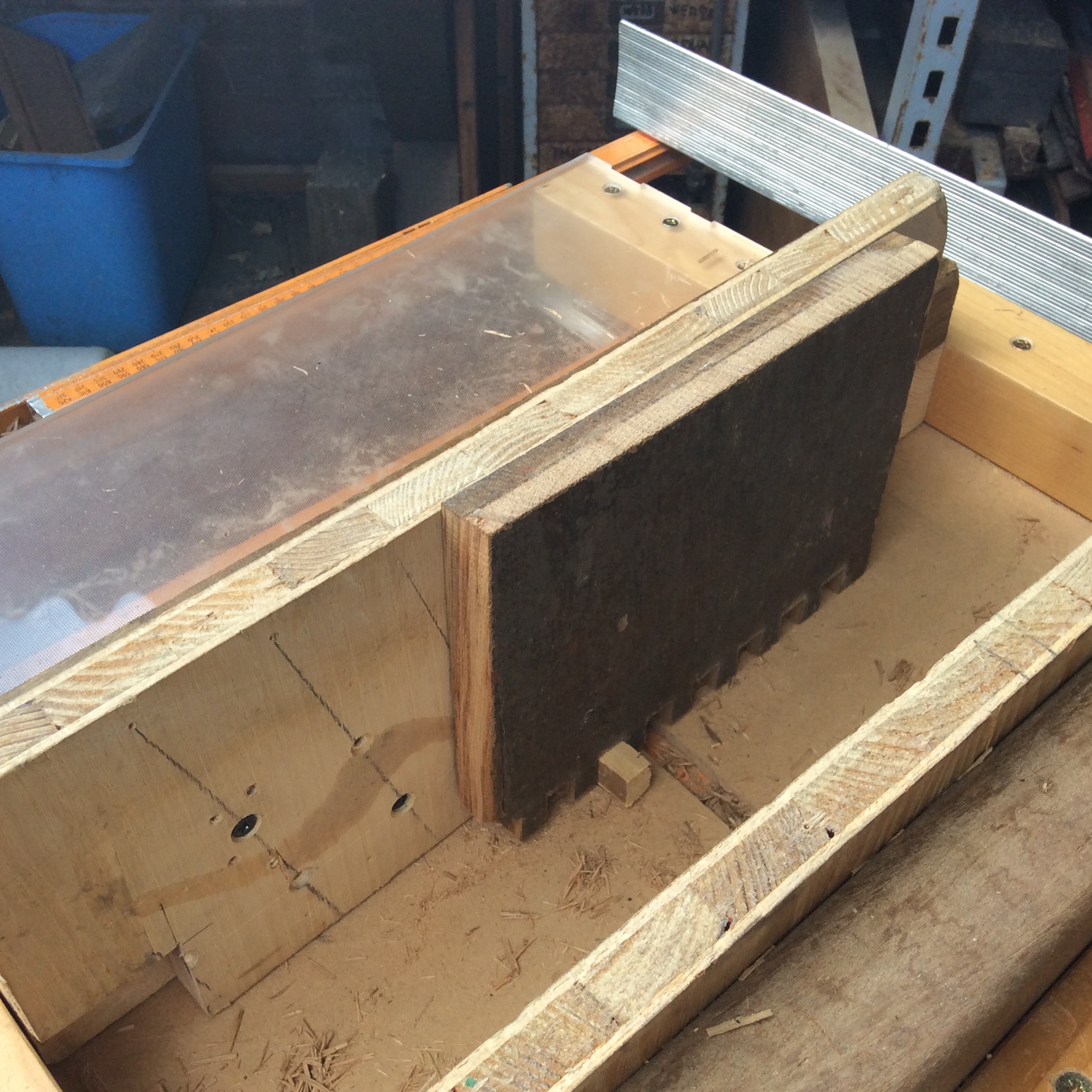

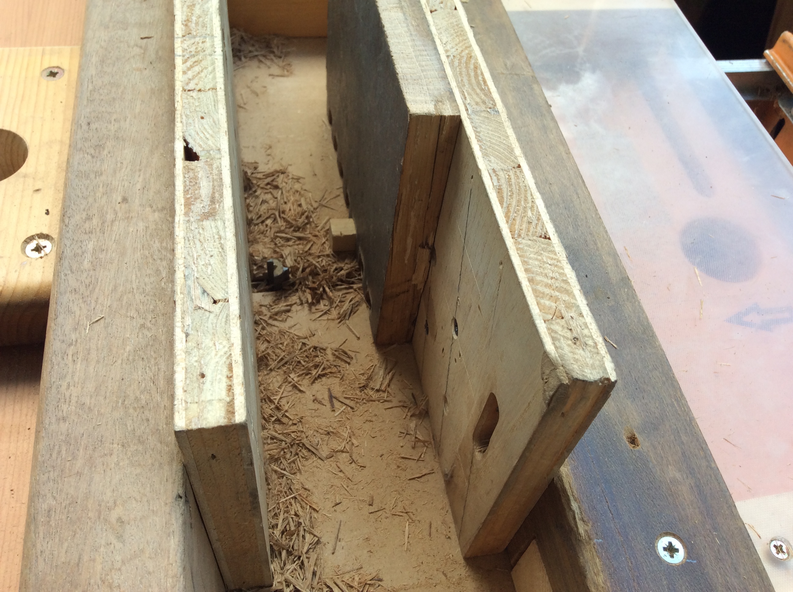

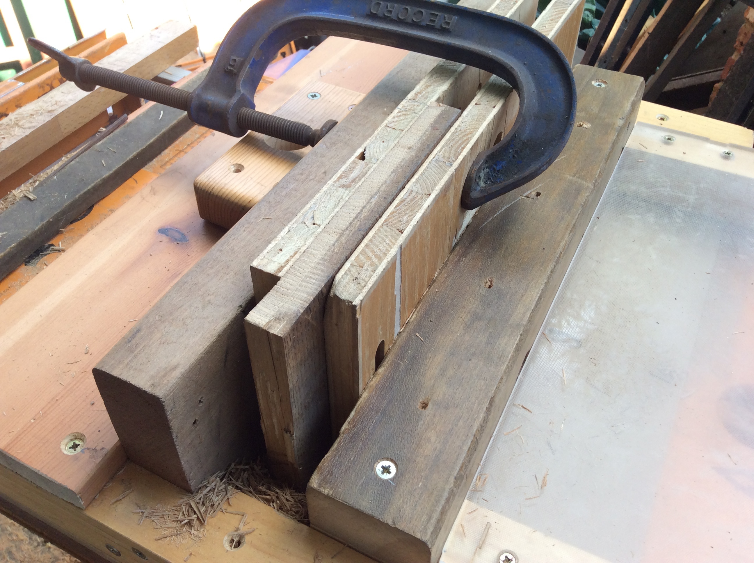

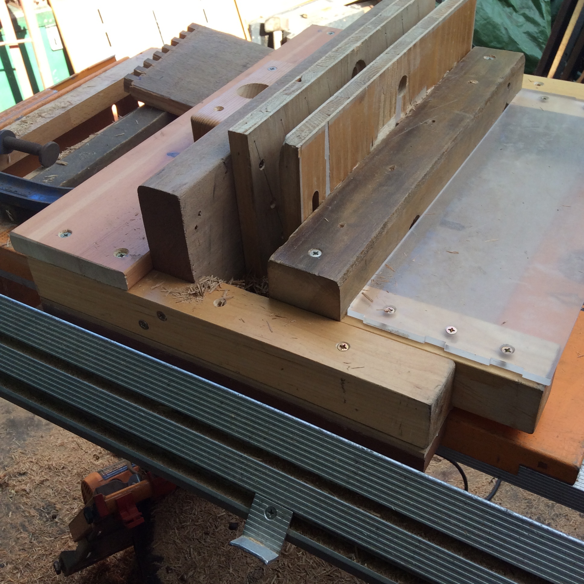

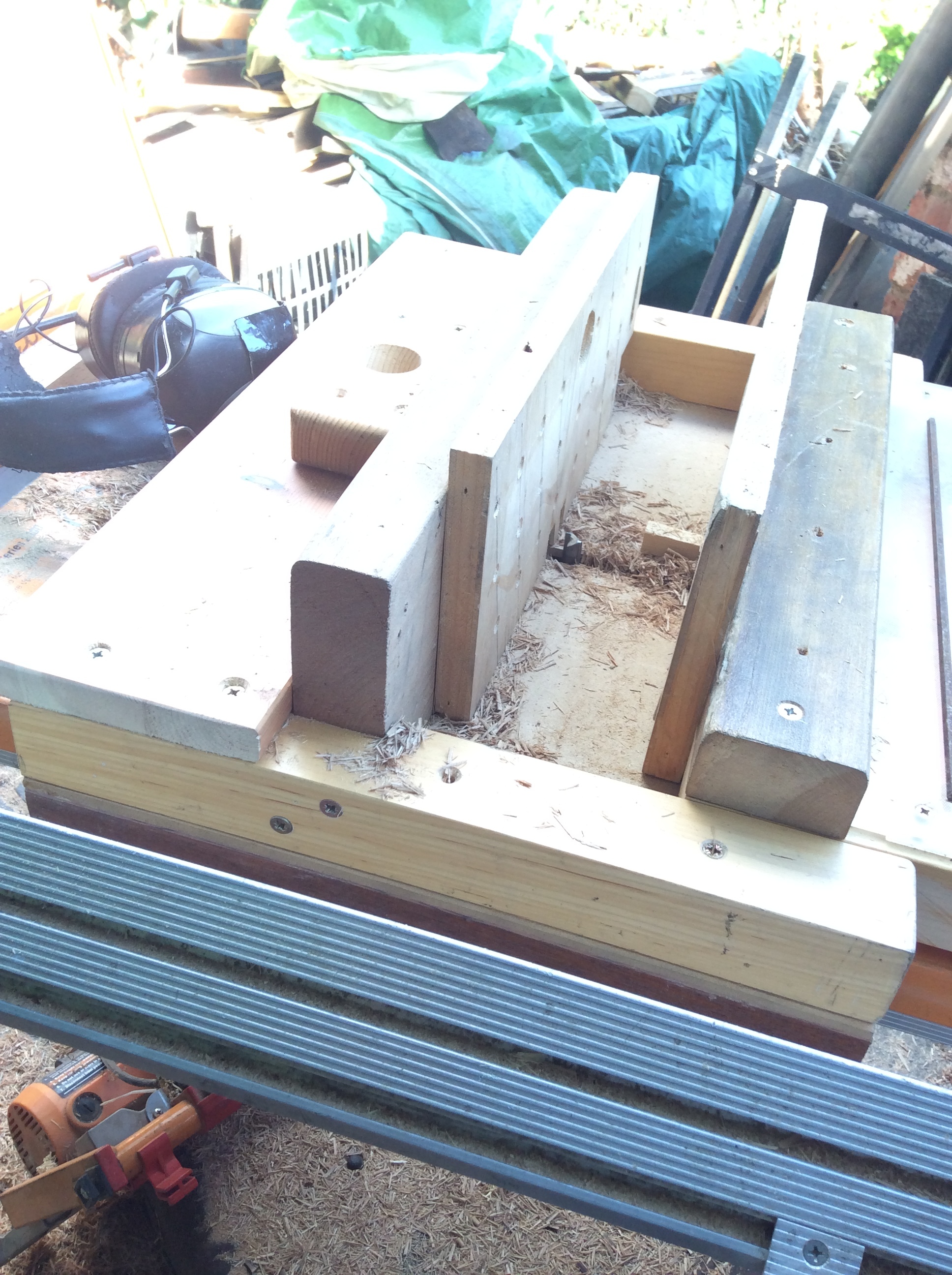

This is a view of the jig. It is made from wood salvaged from broken furniture. It is in two parts. The saddle slides on the table. It has a hole for a vacuum , but this is useless. So is the spigot beneath, nearest the cutter. The front part slides within the saddle and is used to sandwich the material between the two false fences. There is a piece of 6 mm acrylic across the top

In the first, third and fifth pictures above you can just make out the notch, which is just slightly narrower than the cutter and is offset by the same amount from the cutter. The notch is screwed to the front fence and slides into a hole in the back fence opposite. You can see all the chippings, from just one pass, which the extractor does not remove.
It will be seen, fourth picture, that the workpiece has to be clamped between the fences. If not, the cutter will kick it askew.
So after each tine, or finger, is cut, the clamp is unscrewed and the workpiece moved up over the notch. But since the debris has already accumulated, it has to be removed, so the front fence is slid towards me and the dust has to be brushed away. Clamp again, switch on again, cut the next tooth.
