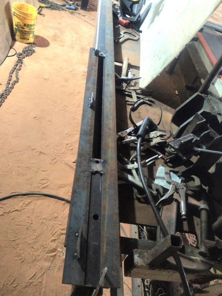

In needing to both cut a long slot and locate a weldment repeatedly I figured why not shoot both varmint's at once with the same guide / fixture,
By leaving one side extra long I can use this plasma cutting guide to locate a part near the opposite end of the formed C beam channel
Attachment 40739
