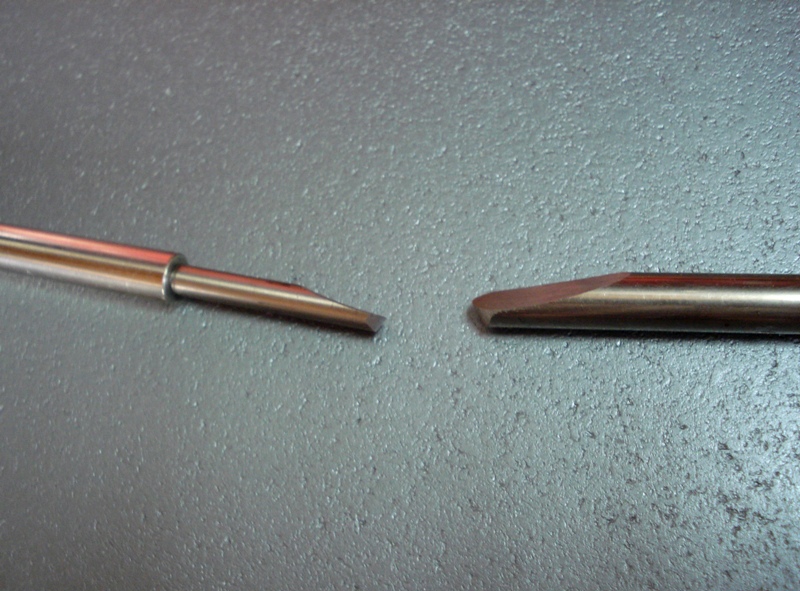

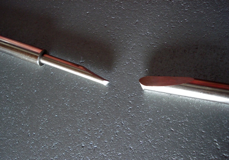

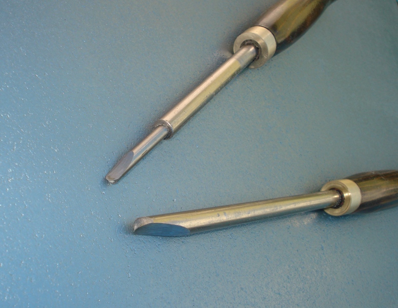

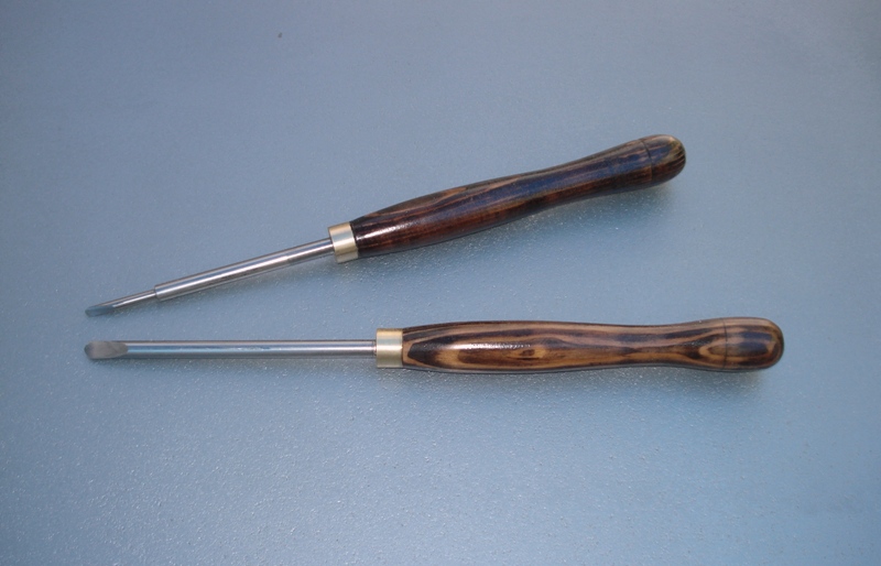

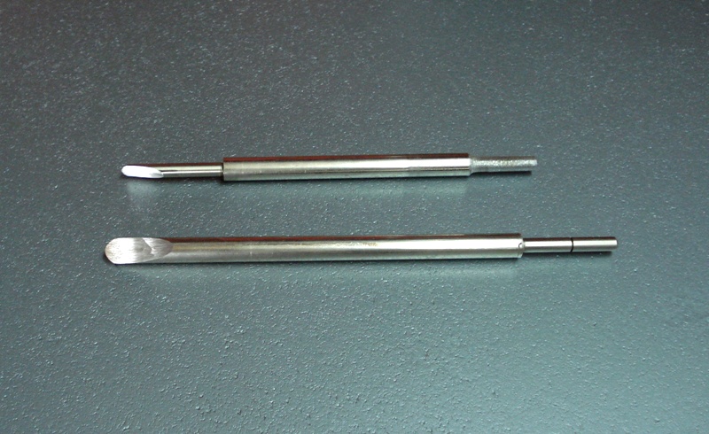

This tool, also called sjewji gouge or skewchigouge, has a combination of the cutting profiles of a skew chisel and a gouge, and hence is a multipurpose tool.
The tools I show were made from a discarded printer 3/8” Ø steel bar, which had a reduced diameter to 1/4 "at both ends. The handles were made in pine and a brass ferule was added.
This tool is based upon the article “Unconventional Tools” by John Siegel. It is possible to buy these tools in several commercial firms that sell woodturning supplies, and there are several homemade models on the net.
