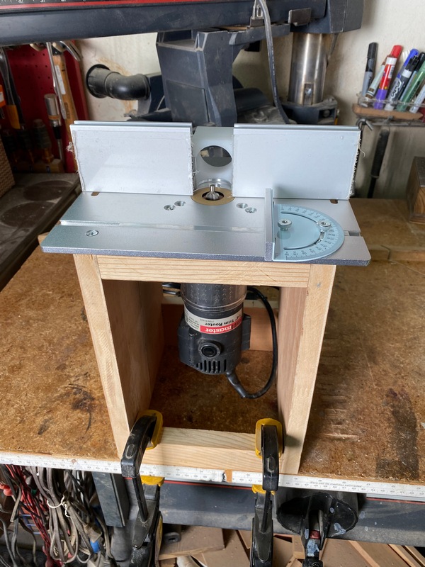

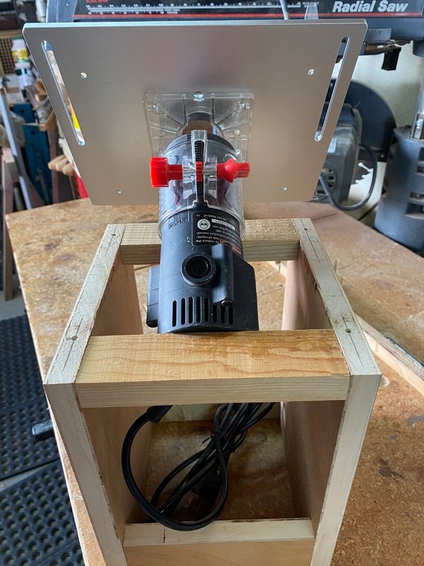

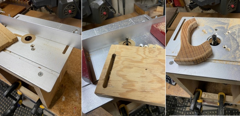

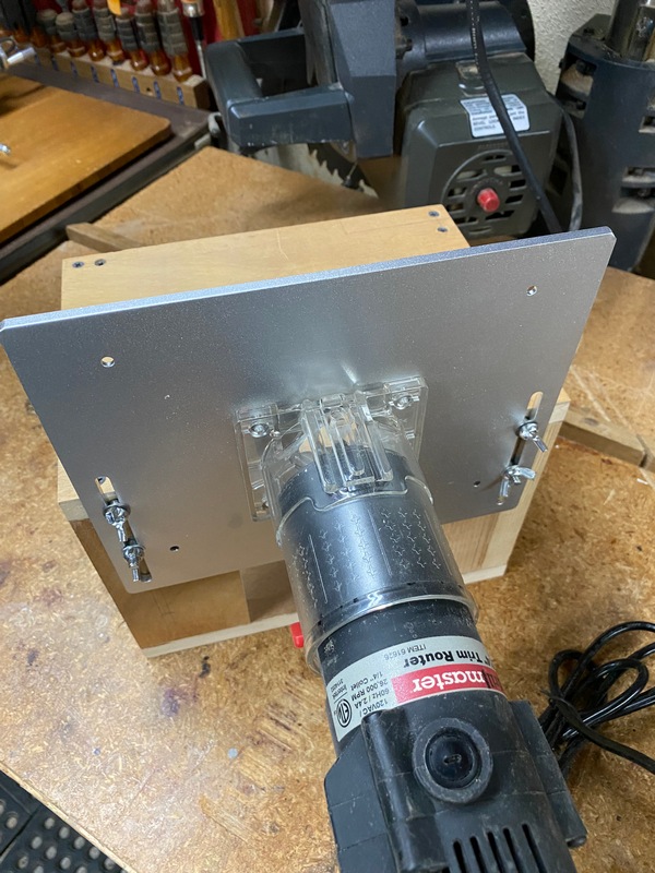

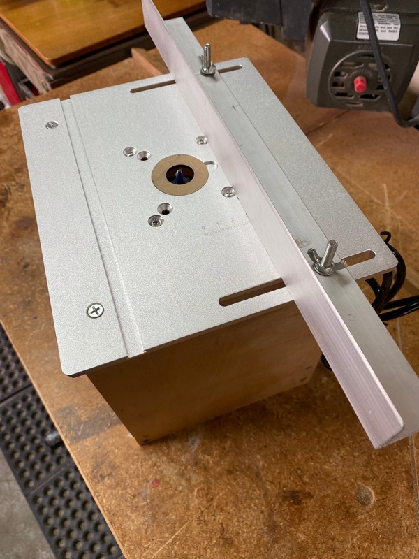

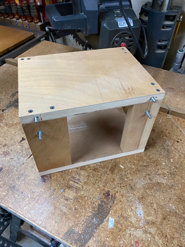

I made this compact router table (aka mini router table), using a trim router, because I needed a table for medium cuts, keeping in mind that I have the Craftsman router table (60 x 36 cm) for regular cuts, and the Dremel Rotary Tool Shaper and Router Table (20 x 15 cm) for cutting small parts.

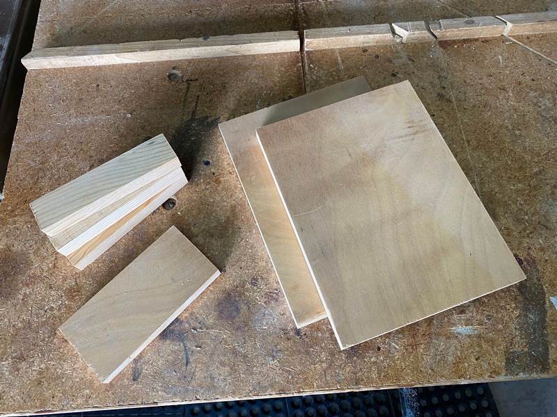

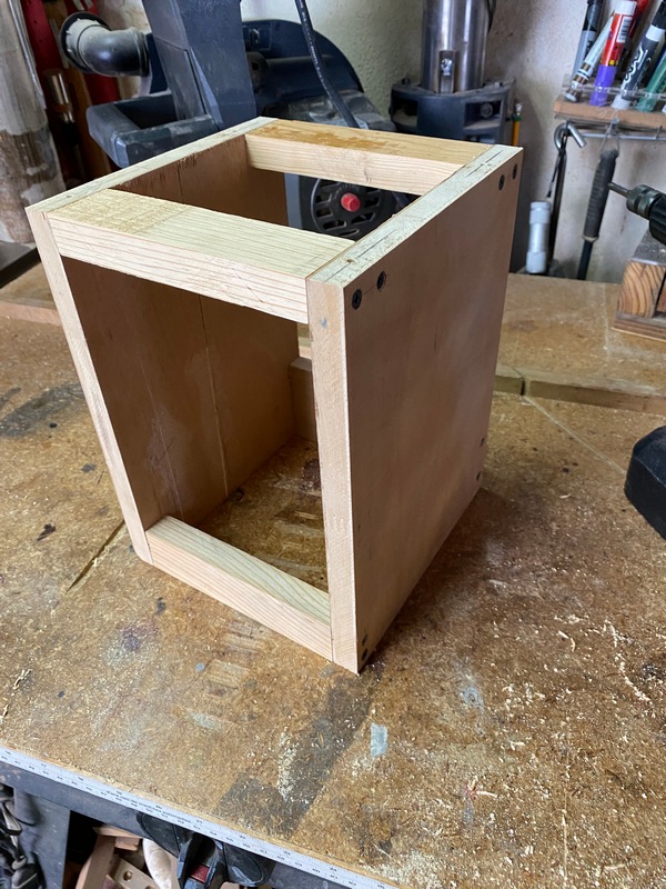

I used a router table “insert”, although instead of using it as an insert, I used it as a tabletop. In this way, the insert measurements determined the length and width of the table (20 x 19.1 cm), while the height was determined by the height of the trim router (27 cm).
Attachment 44580
Attachment 44581
Attachment 44582
Attachment 44583
Attachment 44584

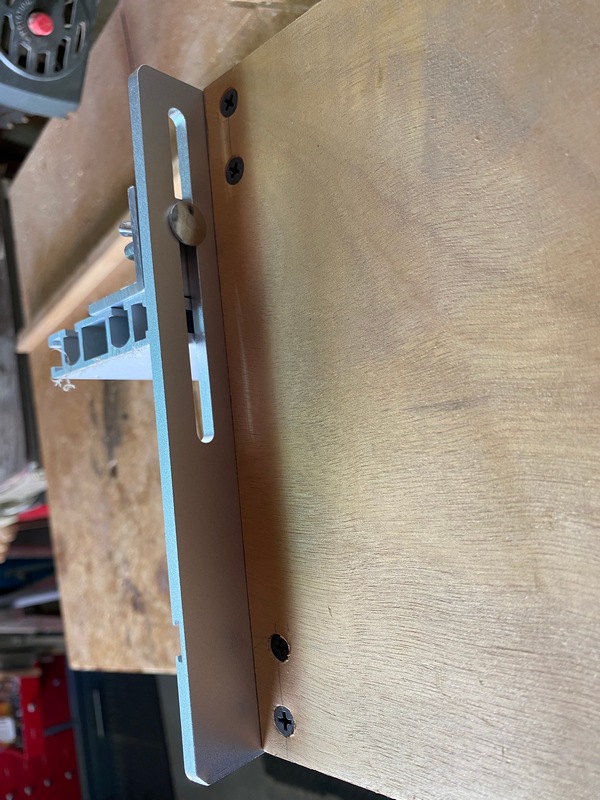

In addition to the split fence included with the insert, I made a continuous fence for cuts where it is most convenient.

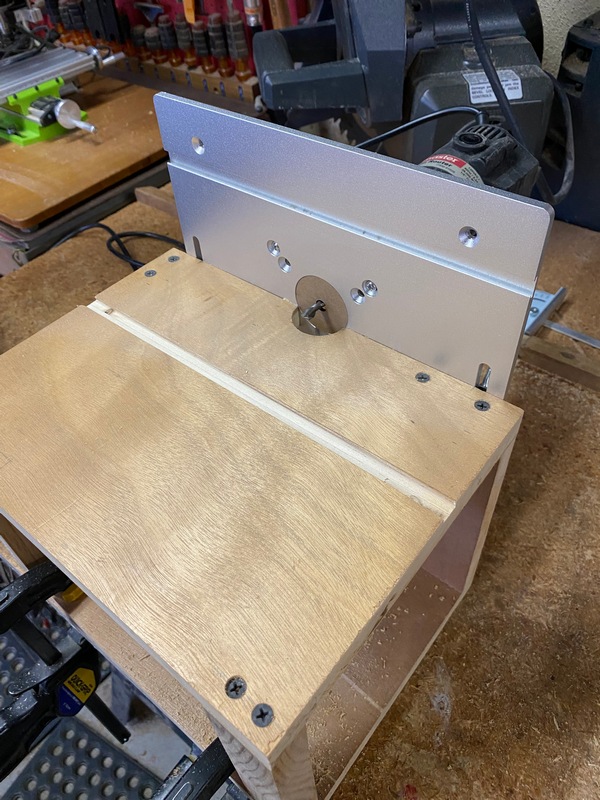

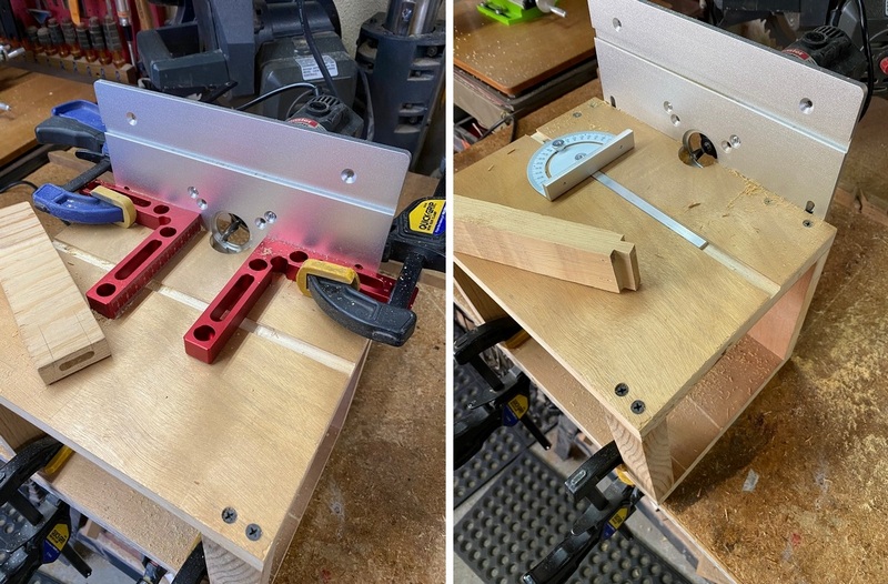

HORIZONTAL ROUTER
On the other hand, by placing the table horizontally, and holding the "insert" vertically, you have a HORIZONTAL ROUTER, which is useful for cutting tenons and mortises.
