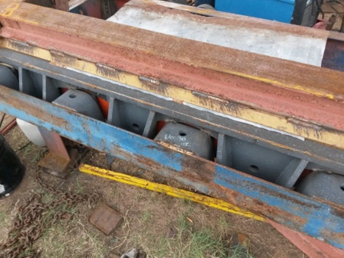

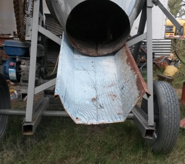

Everyone knows that cement mixers are hardly use friendly without using a wheelbarrow. when you tip them to dump the mix on the ground the mixer is right in the mud unless you dump into a wheelbarrow and cart it away.
Well since I have my mixer mounted on its own trailer it can be moved right to the pour but as with all mixers it dumps almost under-itself. I don't want to dump into my wheelbarrow only to move that a few feet then dump it so I made a chute for my mixer
My folder break is not finished but finished enough to make a few easy bends
Attachment 19925
the chute is triple bent on both sides for strength and taper bent wide to narrow shallow to deep for directional flow and control
Attachment 19926
