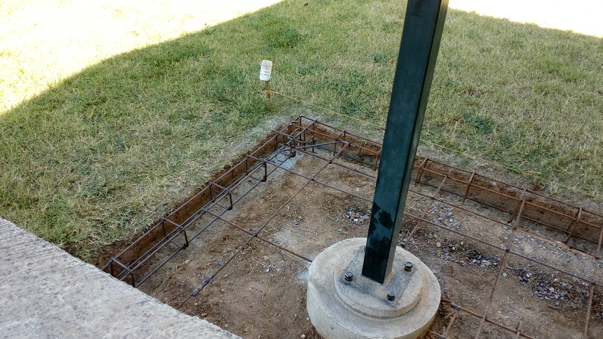

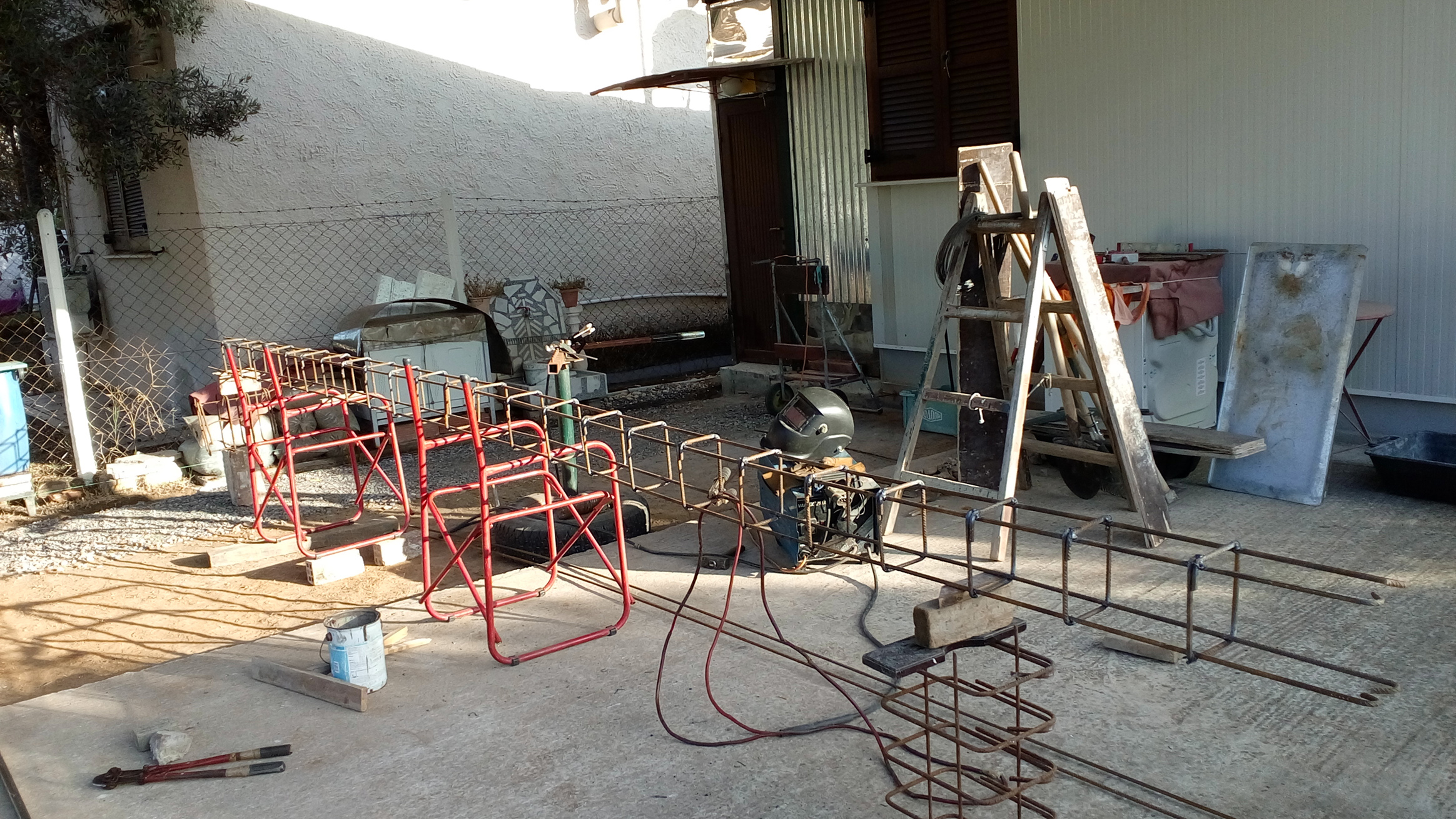

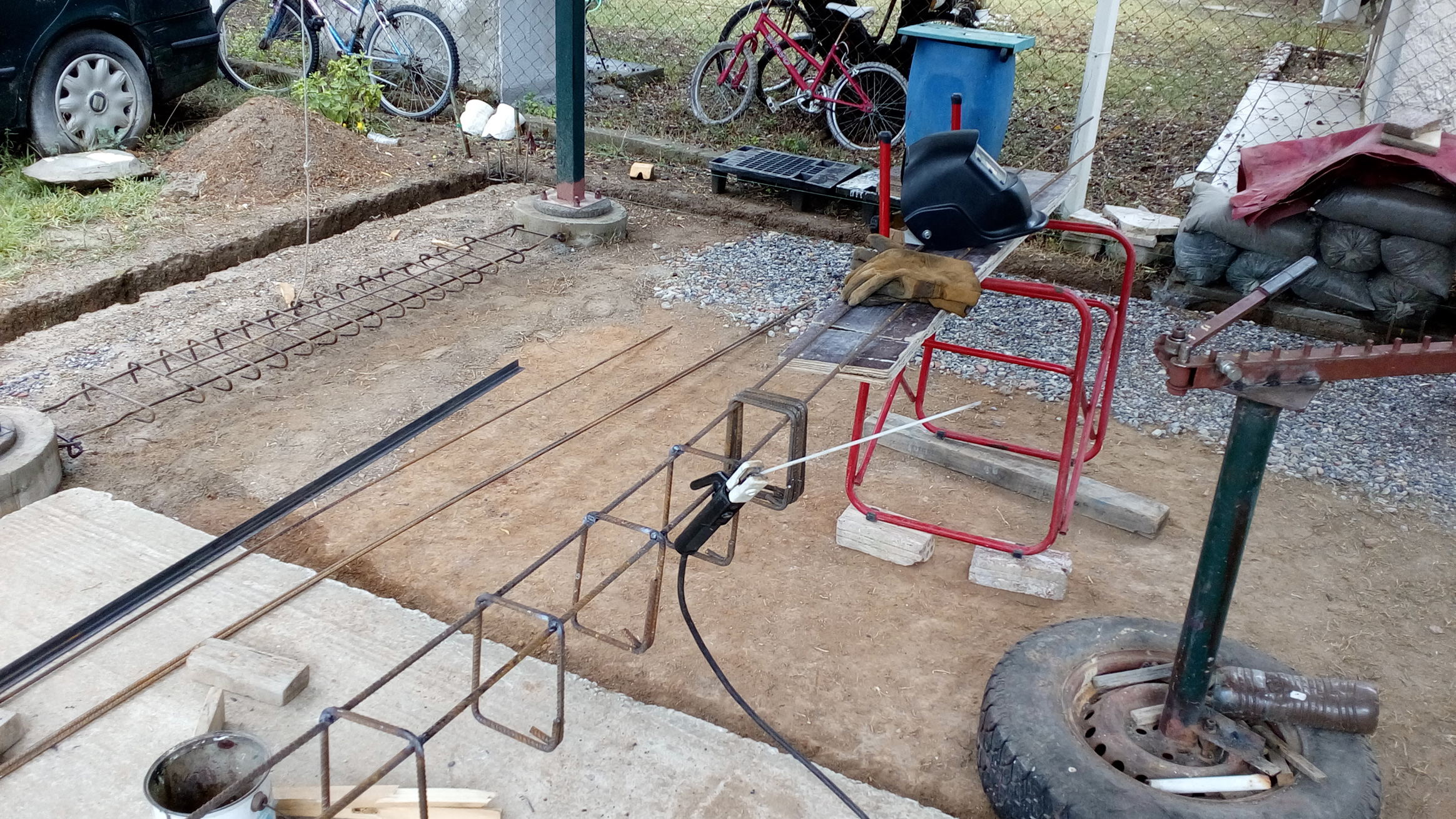

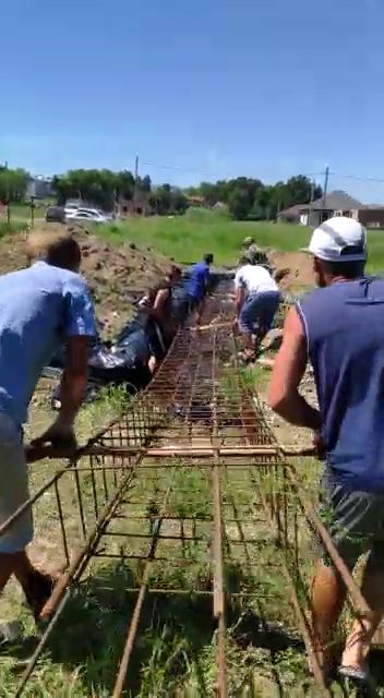

    Concrete Slab Extension

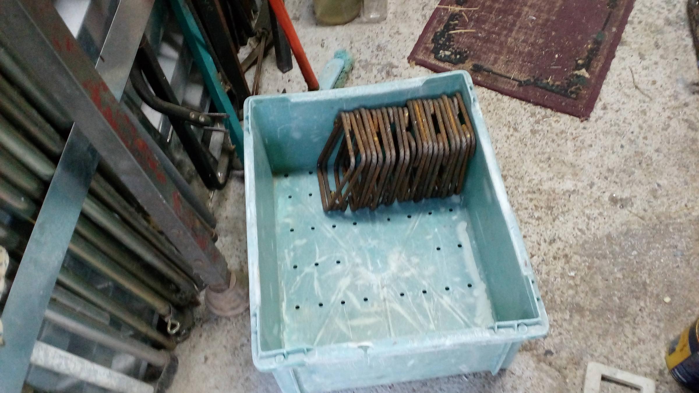

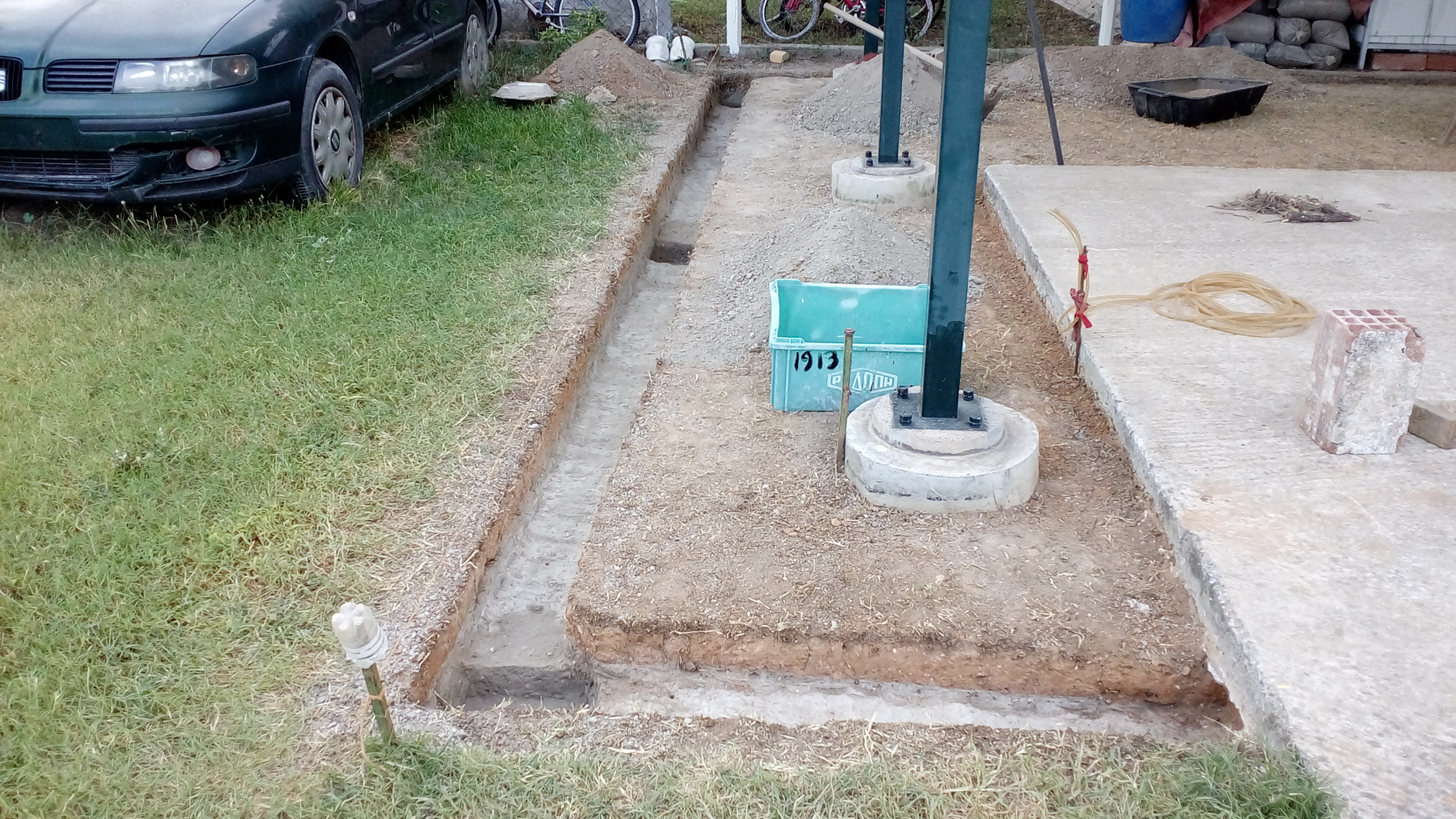

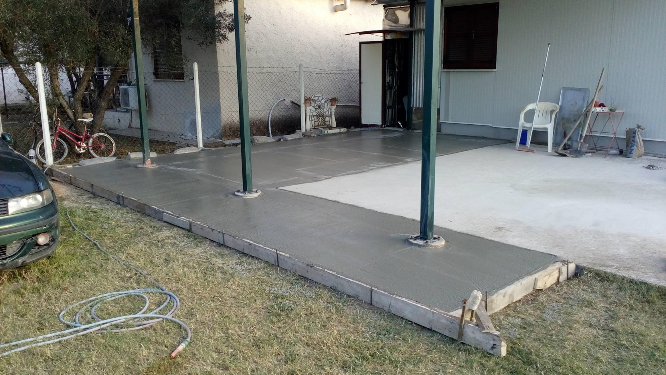

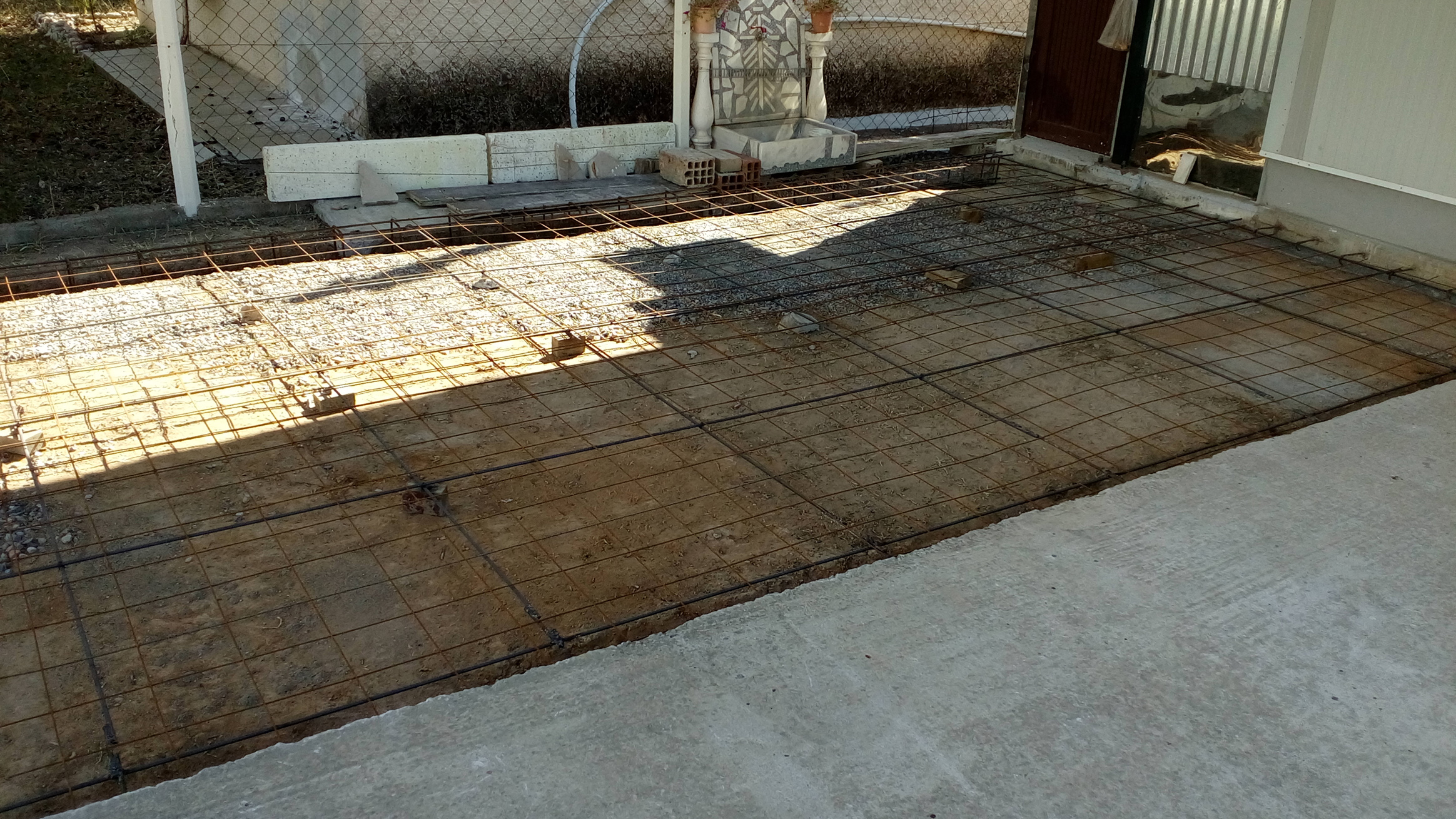

    Step by step from Digging to Making of Reinforced Cages the wooden mold and the Pouring of Concrete slab.
    Materials:
    Reinforced steel bars Ø8mm

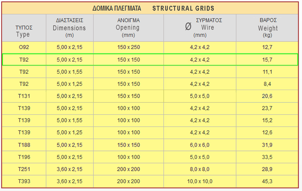

    Sructural grids Num T92
    Wire
    Electrods 3,25mm/6013
    Sandgravel
    Cement
    Sructural resin
    Concrete Slab Extension-img_20200914_081404.jpg Concrete Slab Extension-img_20200914_121533.jpg

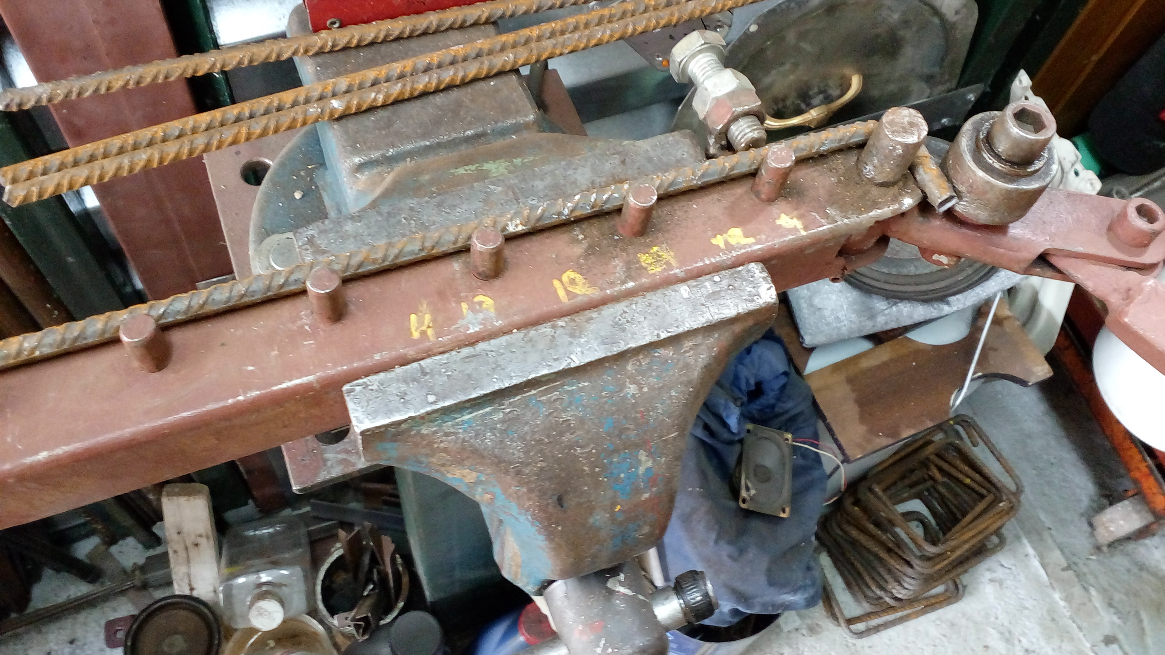

    You can find the build of my metal bender here in HMT DIY Metal Bender
    Concrete Slab Extension-img_20200905_193624.jpg Concrete Slab Extension-img_20200926_145724.jpg
    Concrete Slab Extension-img_20200926_175526.jpg Concrete Slab Extension-img_20201012_123732-s.jpg
    Concrete Slab Extension-img_20201012_123808-s.jpg Concrete Slab Extension-plegma2.jpg

    A word to the wise from a structural engineer. First welding of reinforcing steel should only be done on weldable rebar or by determining the carbon equivalent of the steel with proper preheat and temp verification. Welding of rebar a bends is forbidden, otherwise you should expect steel failure under load levels below design allowable values. Appropriate wire ties are preferred are are less time consuming versus welding which may or may not be permitted, depending where placed. Wire ties should have ends bent into the concrete member, away from the exposed faces to avoid wire tie rusting and faces marred by rust.

    @road-warrior
    Thanks for your advice.
    The loads will be very light, as the walls will be made of polyurethane panels, and the construction will be used for summer house.
    In this area we have no seasons with snow neither strong winds and the altitude is between 50~100 meters from the sea surface.

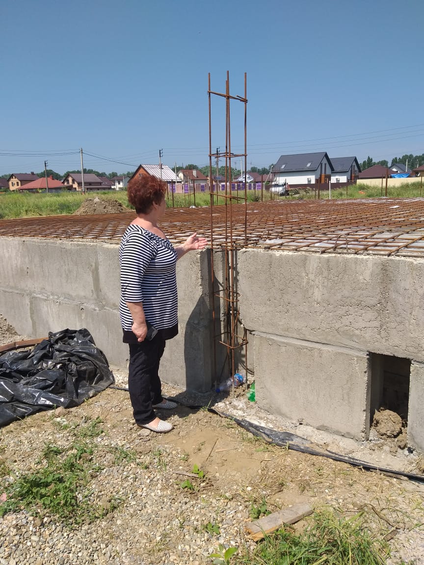

    Here's the rebar for our new house, all tied
