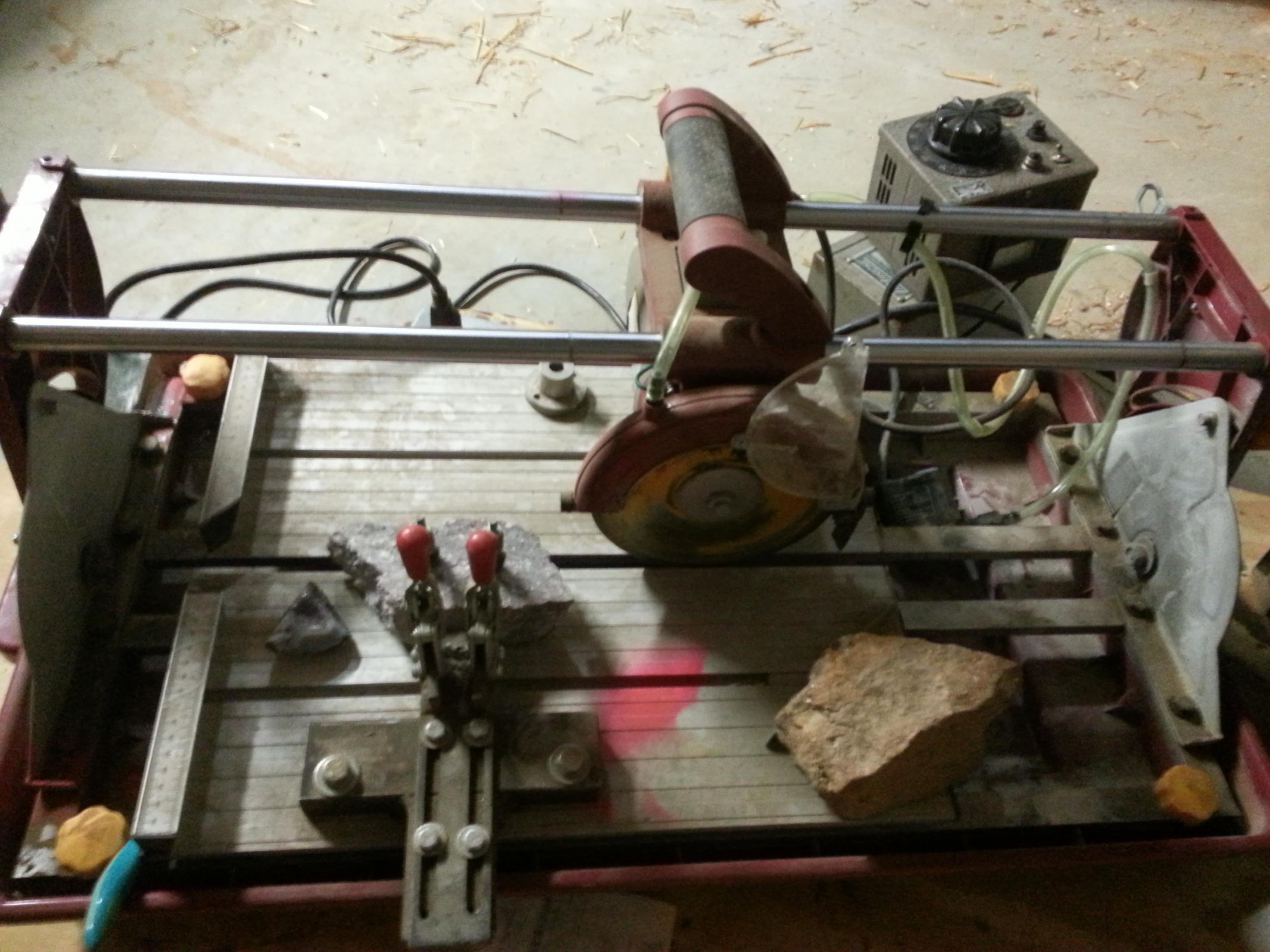

Converted a Broken Tile Saw To A Diamond Slab Saw...

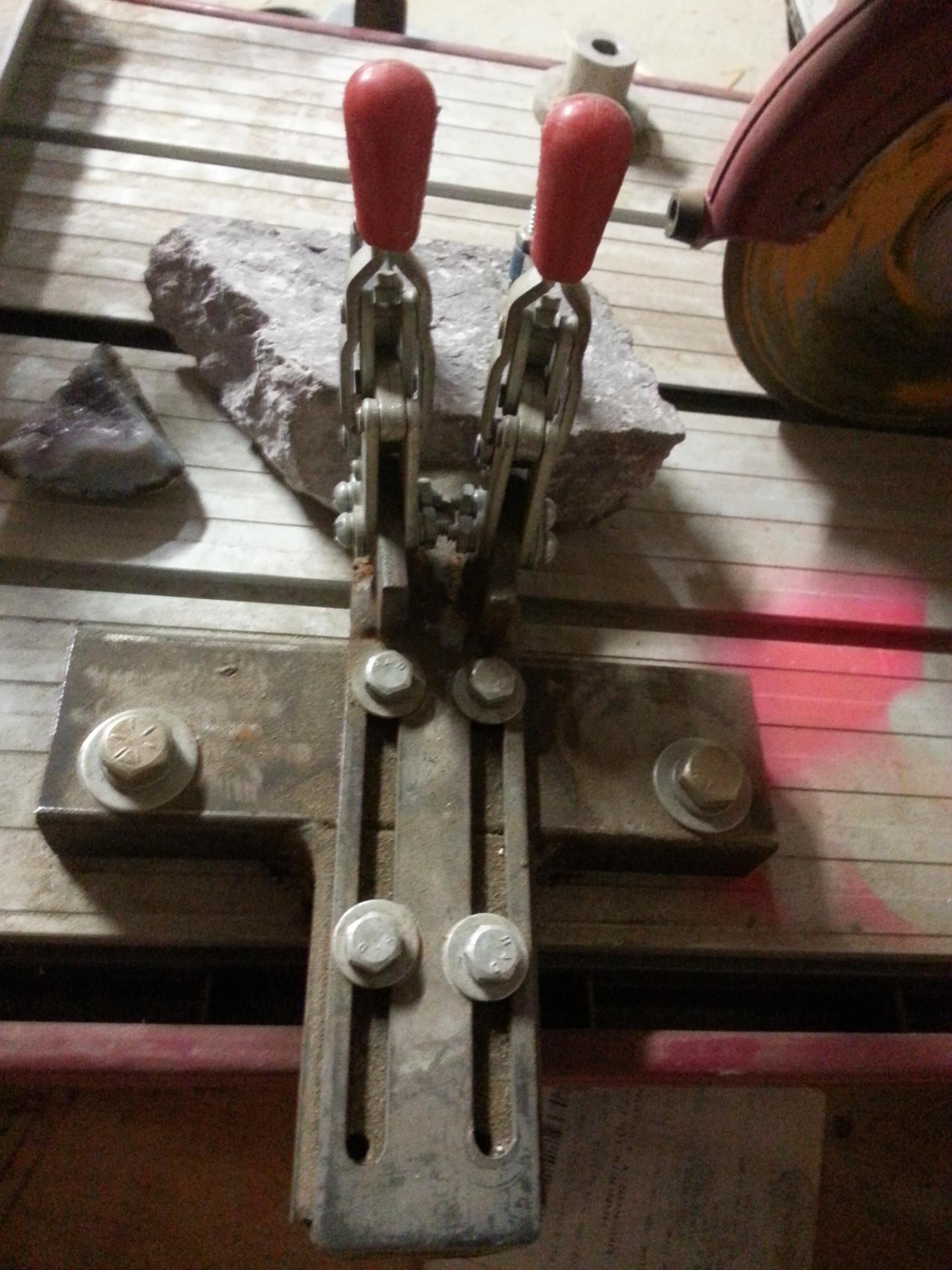

With a New Material Clamp I Welded Up...

cool martialfollower2004. I'm all about re purposing HFT's. Sorry I don't mean to hijack your thread but.....
What was broken on the tile saw?
And what is the box with the knob etc on the other side of the saw?
I have one of those HFT saws and so far it's been great. My one immediate mod though was I couldn't seem to get what I thought was enough water to where the blade was actually cutting. So I took off that little bumper on the front of the guard and drilled and plumbed it for the water and no more dust and burning of the blade. But the way the motor pulls in air then exhausts it inside the guard makes it seem like it pulls a lot of the mist from cutting into the motor. Is this what broke?
The motor would stall at load.... especially cutting rough Sapphire. I increased the blade size and modified the motor to a larger HP a bit tricky to keep the original housing. The Variac variariable transformer is for load and a feed screw system to feed the motor, it also has an isolation transformer at the input. Your lube system is an easy fix with a small pond pump.
Hmm, thanks. So it sounds like the motor died just like I thought. Hope mine doesn't. Would be nice to see the detail of how you installed a new motor.
My pump was working, but IMHO I didn't like where it put the water. With the pump wide open and plenty of water coming out it didn't seem to be putting the water where it needed to be. Since I moved the outlet to right over the front of the blade it works fine now. YMMV.
