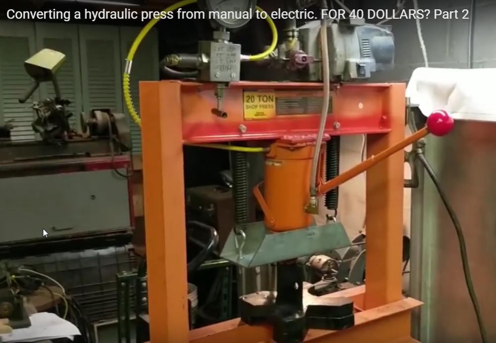

Converting Hydraulic shop press to electric. For 40 Dollars.

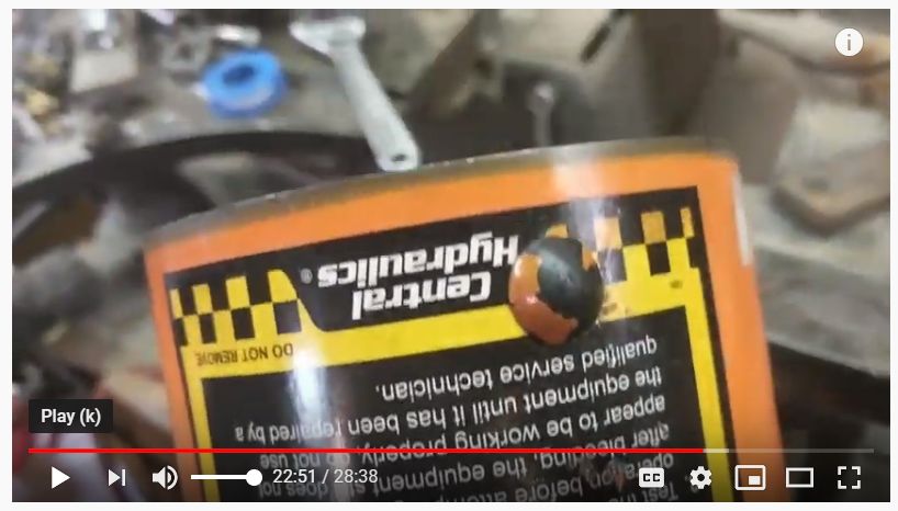

How to add electric power to any manual shop press that is based on a bottle jack, using an airless paint sprayer as the hydraulic pump.
Includes a discussion of bottle jack basics, how to invert a bottle jack, and how to turn a bottle jack into an hydraulic cylinder.

Part 2 of 2, press frame modifications, hydraulic fitting creation, final assembly and testing.
https://www.youtube.com/watch?v=X5GsS471sf4
