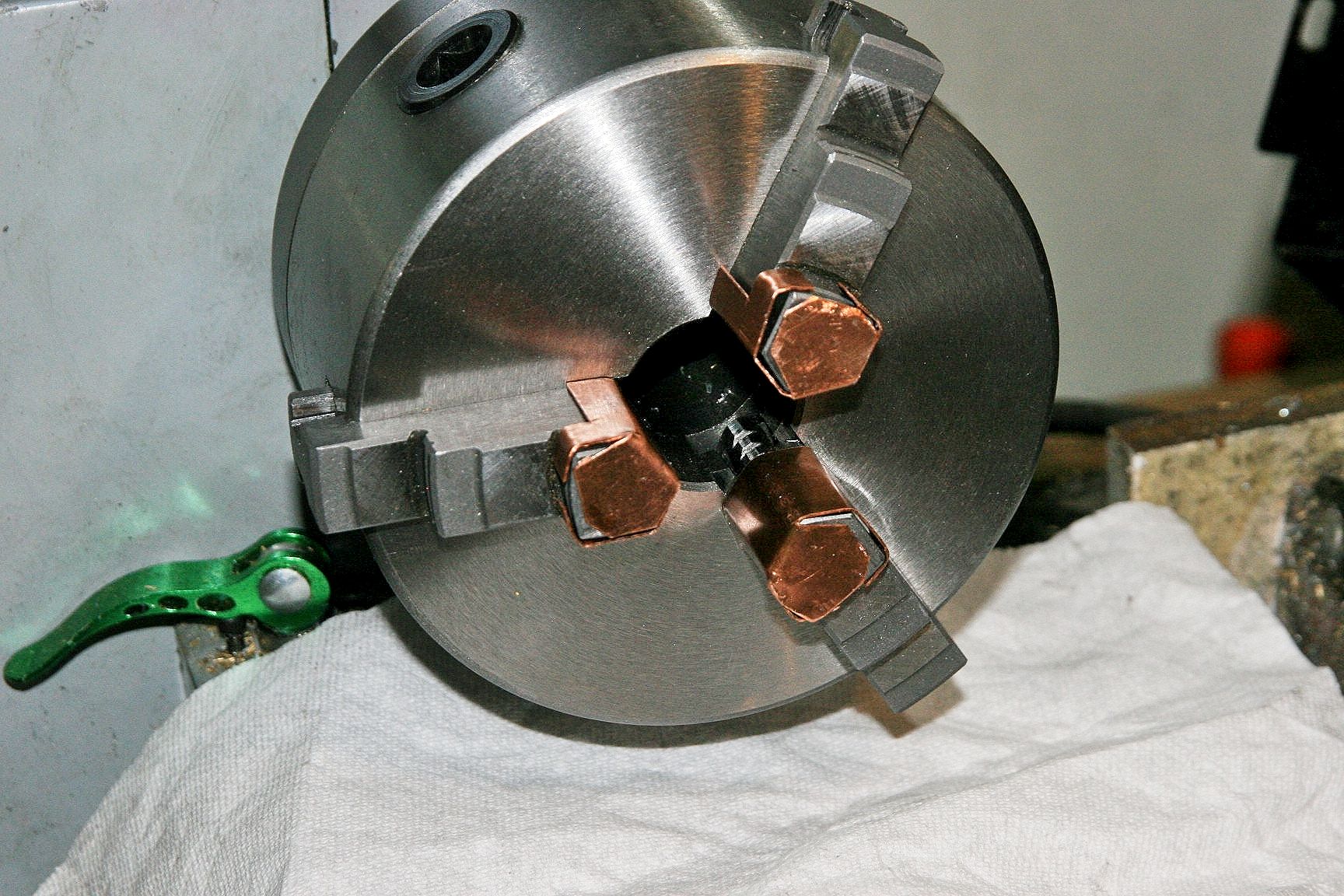

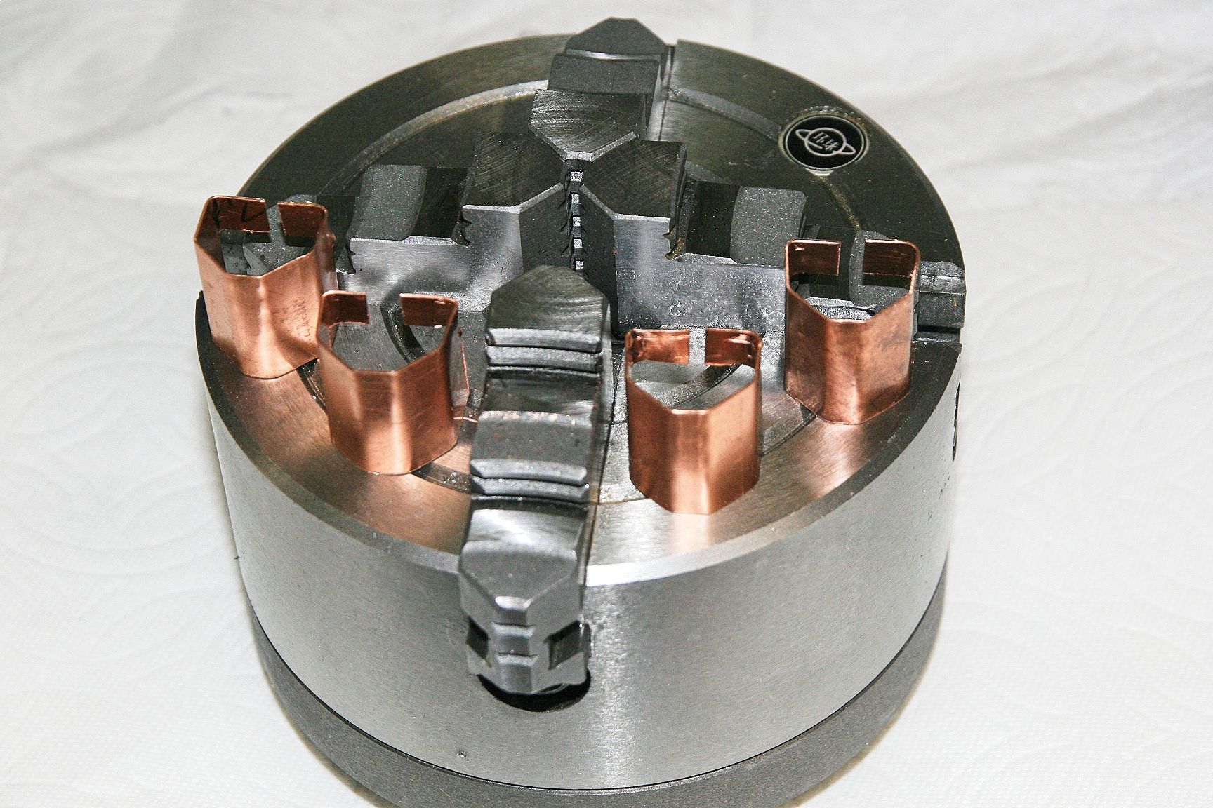

I needed some soft jaws for my lathe and after seeing homeengineer's aluminum jaws:
http://www.homemadetools.net/forum/a...029#post106174
I decided to make some for two of my chucks. The first set was for the 3 jaw and has an added plate
to protect the back of the part you are turning. Takes a bit more work but the added protection is worth it
for some projects:
Attachment 22227

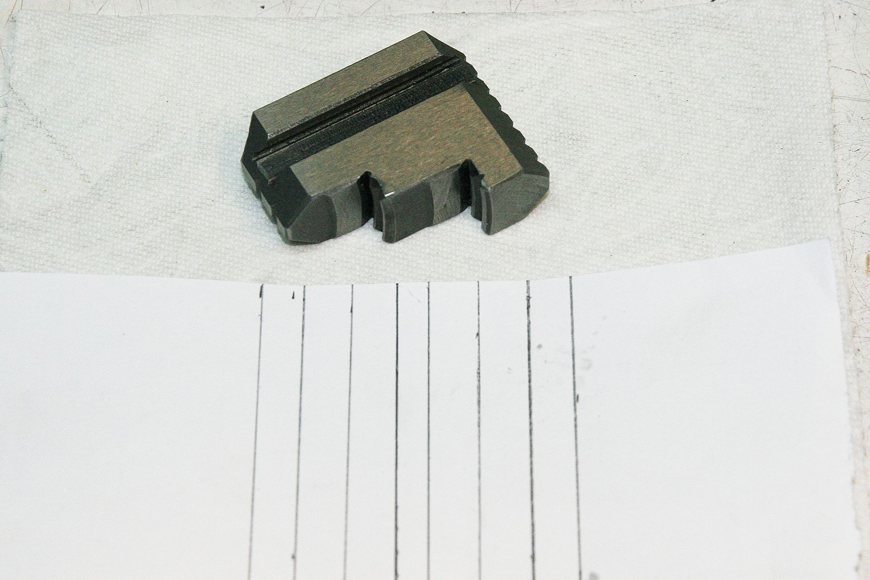

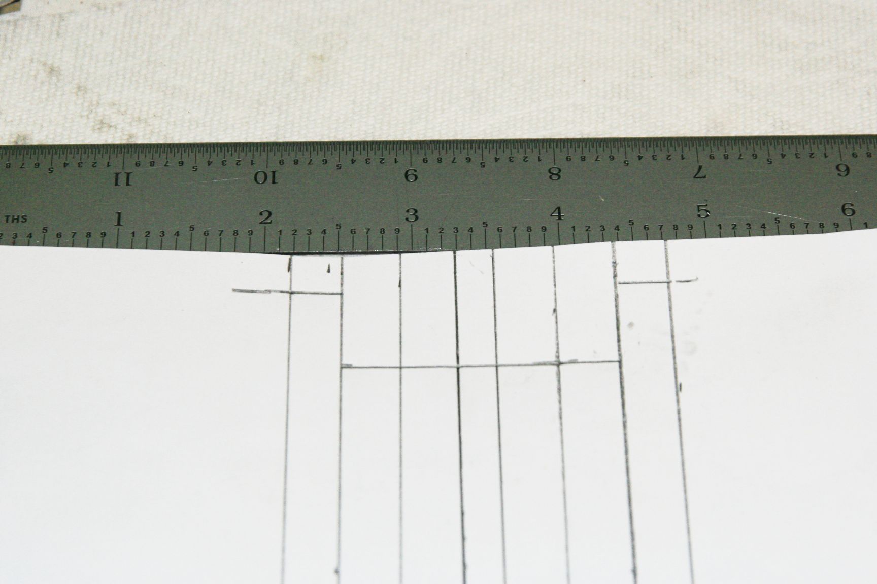

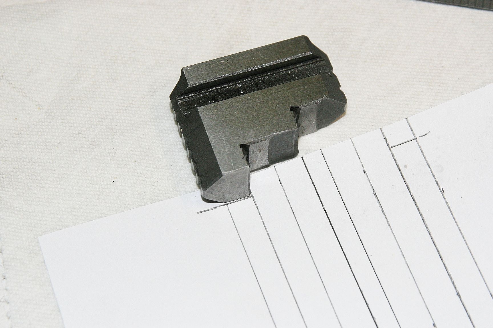

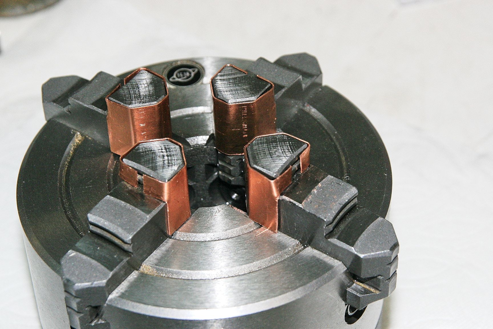

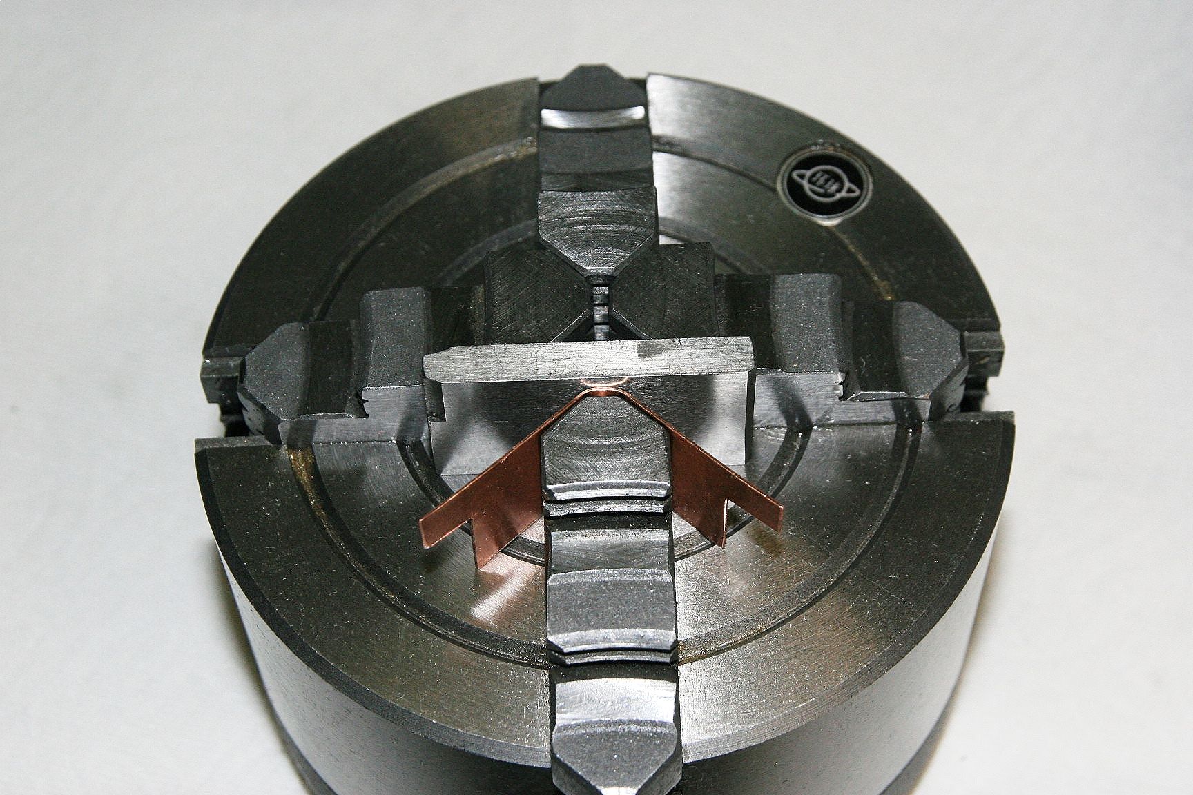

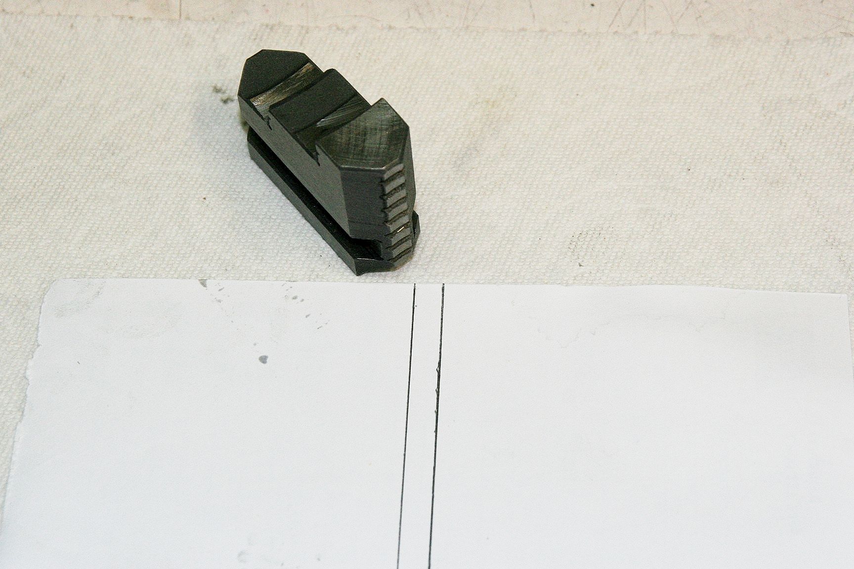

Then on to the easy type. Just take some measurements and transfer them to paper. No measuring tools required, just use one of the jaws:
Attachment 22228Attachment 22229Attachment 22230Attachment 22231

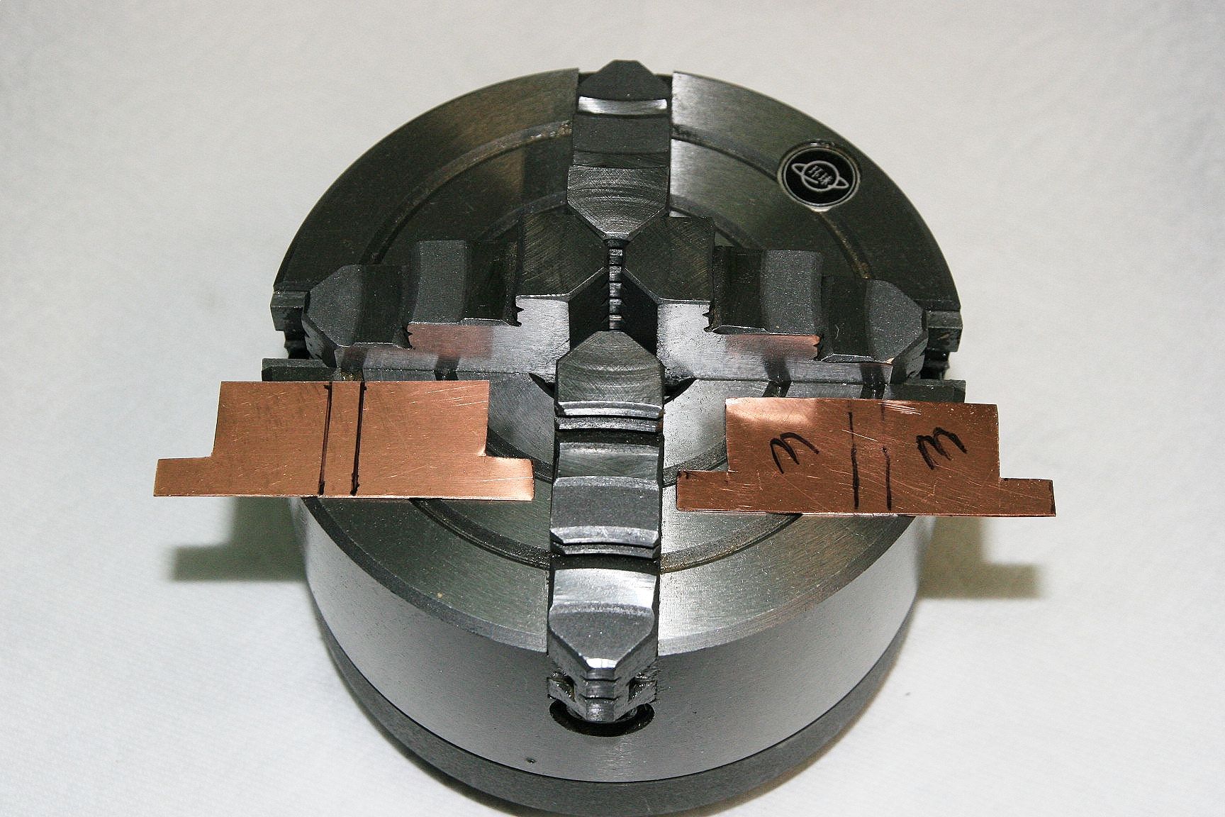

Cut them out from copper sheet:
Attachment 22232

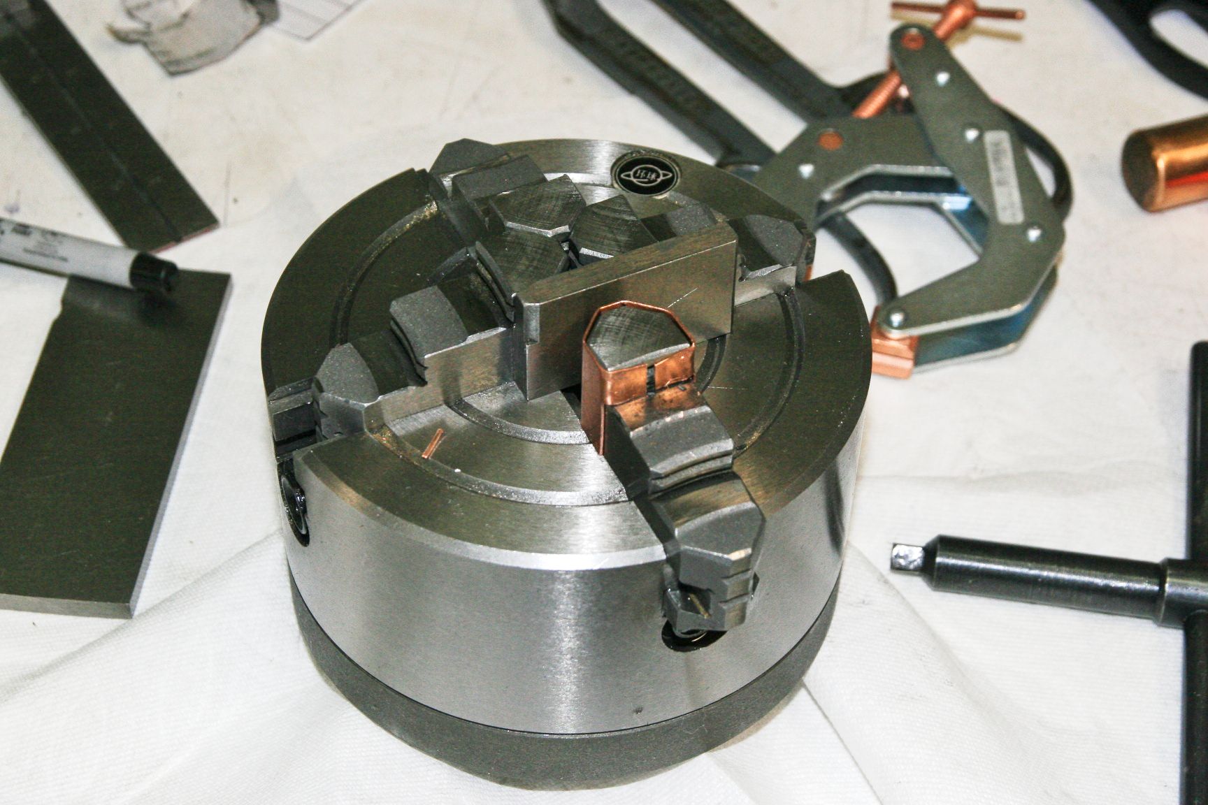

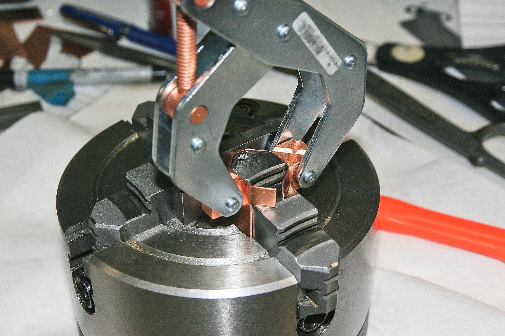

Start the bending process:
Attachment 22233Attachment 22234Attachment 22235Attachment 22236Attachment 22237
Then I always save a small poster board template for next time, and there will be a next time.
