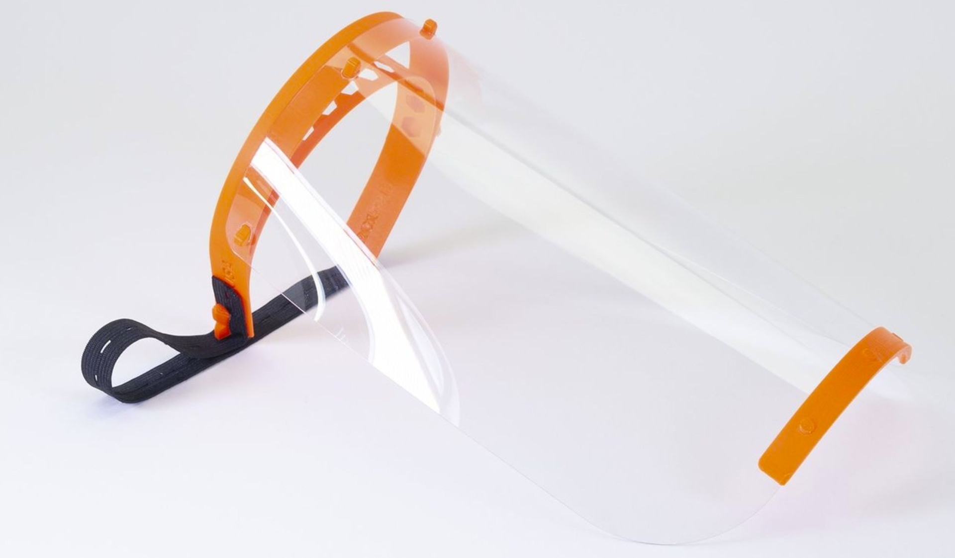

1 Attachment(s)
Prusa has a great resource for an open source #D printed face-shield design here: https://www.prusa3d.com/covid19/
(update) These shields use a standard paper punch to make holes in the overhead transparency sheets. Make sure to select the correct version based on the punch spacing (e.g. European vs USA).
Various mixes to fit different needs can be found here: https://www.prusaprinters.org/prints/25857/remixes. There is also a particularly useful mix for smaller printers: (look for RC3 for Pursa mini) or direct link https://www.prusaprinters.org/prints...for-prusa-mini
Attachment 34253
Cheers!
My son is making a bunch of those for the local hospital. The laser cutter cranks out the clear shield in 20 seconds.
Takes 3 hours for each 3-D printer to make 1 frame. There is room for 2 on each platten so every 6 hours you get two and start the machine again. With 6 machines running that is averaging 1 frame every 30 minutes or about 50 per day, if you go back to restart the printers every 6 hours.
There is a problem finding elastic for head bands since everyone went out and bought all of the elastic from the fabric stores..
Someone donated the money for materials.
He could get creative, example: cut strips of inner tubes to replace elastic.
In fact I have some facial devices that I replaced funky elastic that way.
hemmjo,
Bless your son for doing that. I just fired up my 3D printer and will be printing the US version. Mine will take longer than 3 hours, it seems, but I am using conservative settings with ABS. There are mixes that print much faster, but some seems to be lightweight - probably OK light duty for personal use.
I am going to print a couple, in case someone in the family gets sick . I am going to try and use either rubber bands, swim goggle straps.
