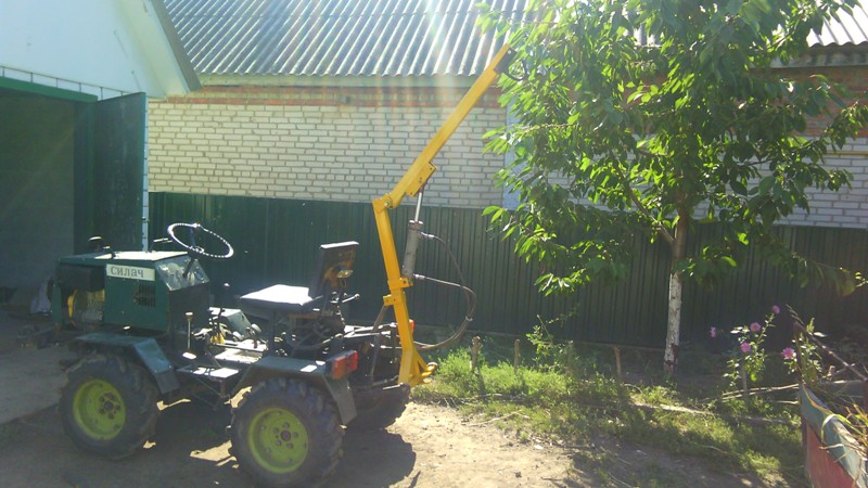

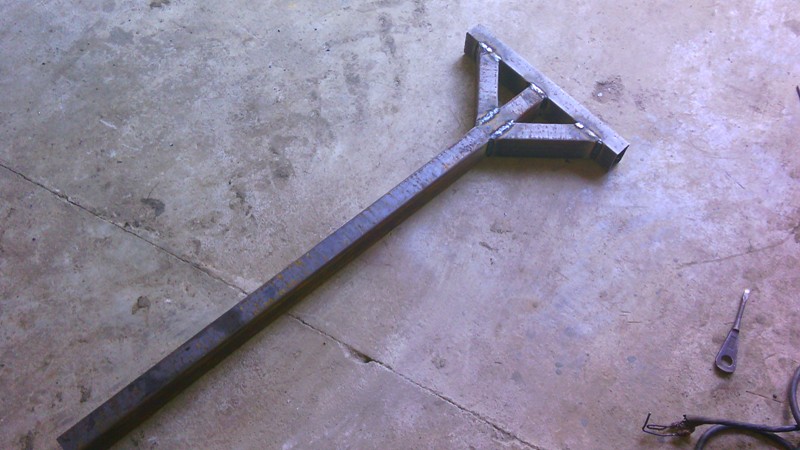

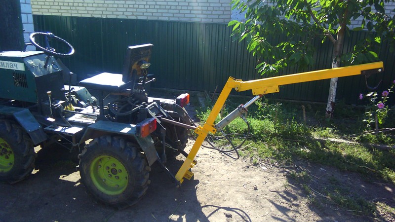

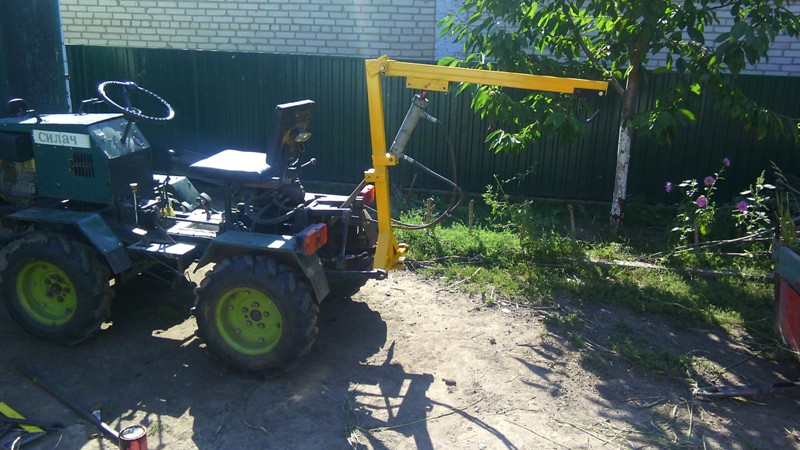

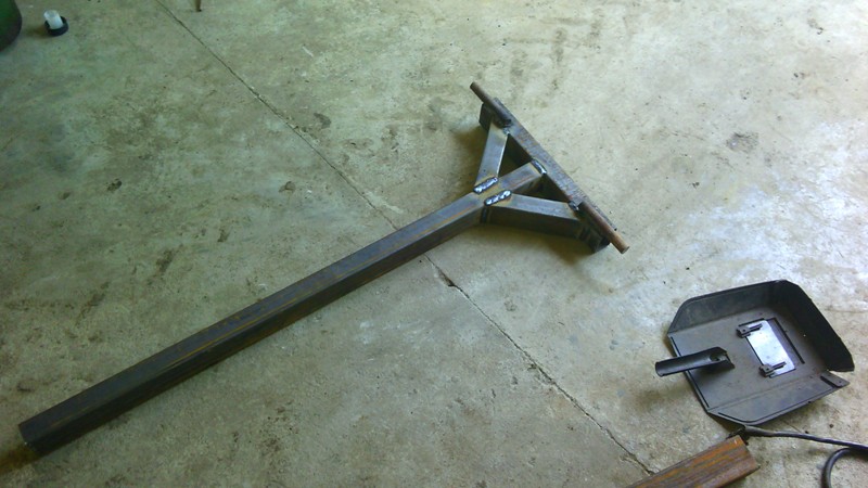

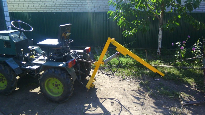

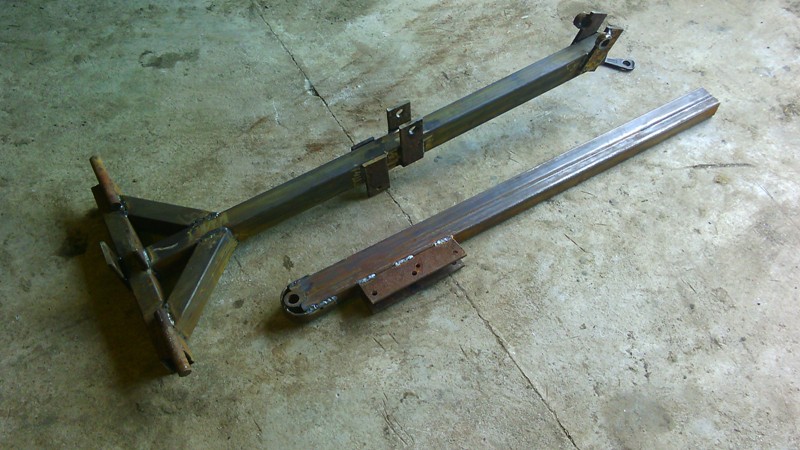

Hi. Sometimes we have to move and lift heavy objects, it takes a lot of energy. To keep his hands back and I made the crane, which is connected to the tractor hydraulic control. I can move objects weighing 200-250 kg. Made crane shaped tube 40h80 millimeters. It is very easy to manufacture the device, but the use of it much.
