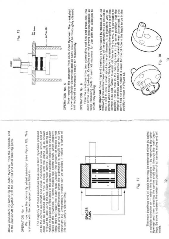

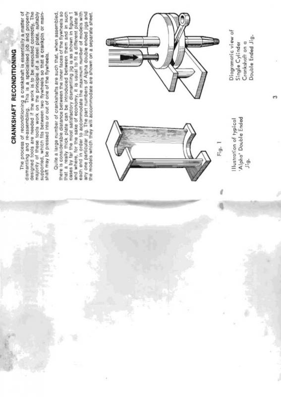

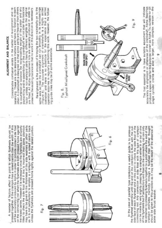

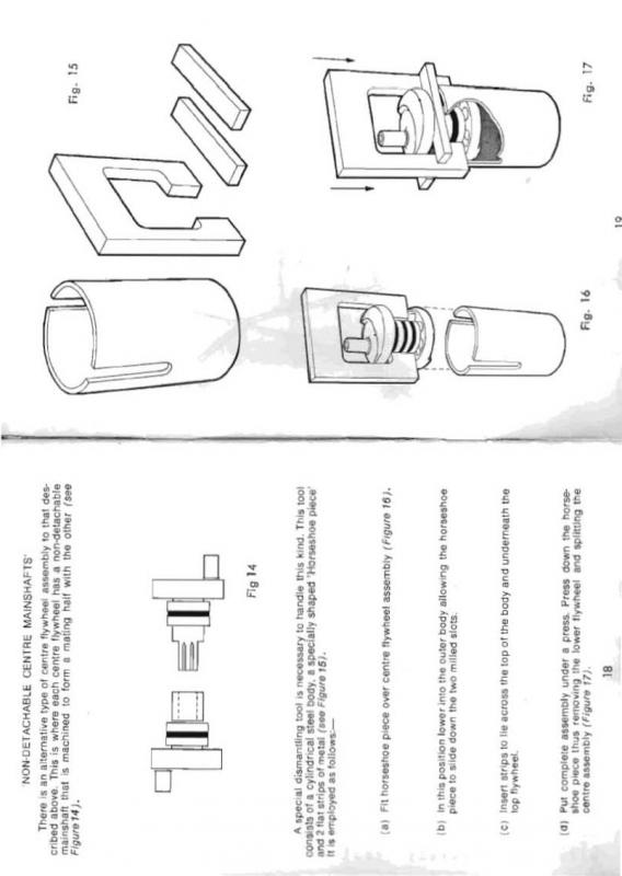

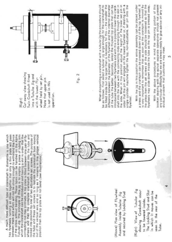

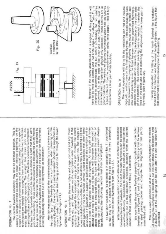

10 Attachment(s)
I was wondering when the Alfa Bearings instructions would appear. Kudos for taking the time to upload it.
I've used the instructions in one form since around 1979 or so. ( I taught pressed up crank building/truing at MMI for several years as a 'machine shop' instructor) It's easier to make a 'press plate' to separate the halves
As I previously mentioned, Honda use what is referred to as a 'tin can' crank on 125~200 twins so crank pins are not seen until covers are removed (they used similar concept on CR125/250) The instructions work when you have access to crank pins but there are no instructions on removing the covers without damaging/destroying them. It's been such a long time since I did 125 twin crank I can't remember how I got plate off left side without damaging it (it IS possible though)
