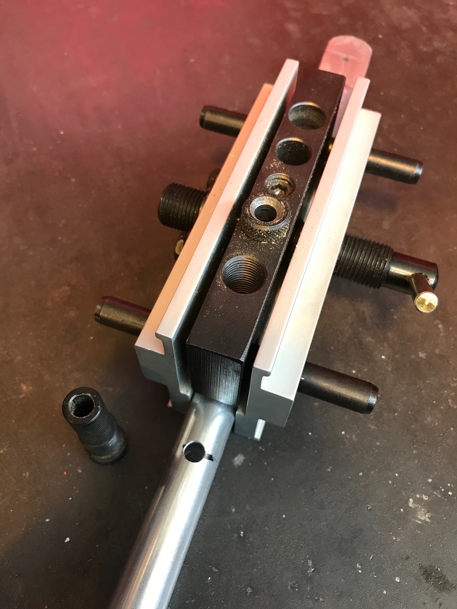

Cross drilling tubing
I'm guessing a bunch of you are clever enough to have figured this one out already...but today I needed to cross drill some tubing - that's never really my favorite task but I remembered I have a self centering dowel jig and the guide bushings on it are nice and long so I was able to secure the tubing in the jig and drill nice 1/4" holes through the 5/8" tubing quickly and accurately.
Attachment 43253
