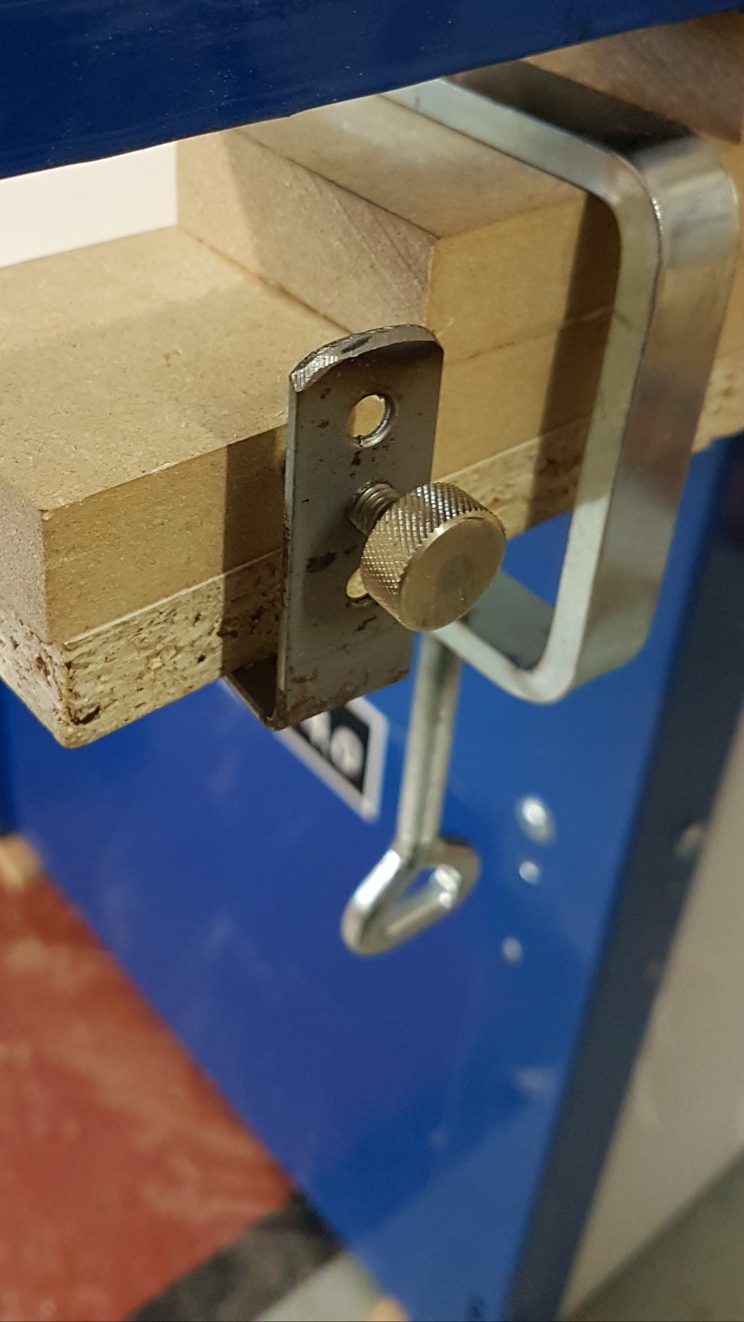

Here is a picture of a simple micro-adjuster:
Attachment 19200 In its simplest form it is a metal bracket drilled and threaded to take a small bolt and fixed behind the free end of the fence. The micro adjustment can be made by turning the bolt a quarter turn and so pushing the fence forward a tiny amount. Note in the picture, the clamp to the right of the adjuster. This is used to hold the fence in place temporarily until calibration is complete, at which time the fence is permanently screwed from underneath and the clamp removed.
I hope this is helpful.
