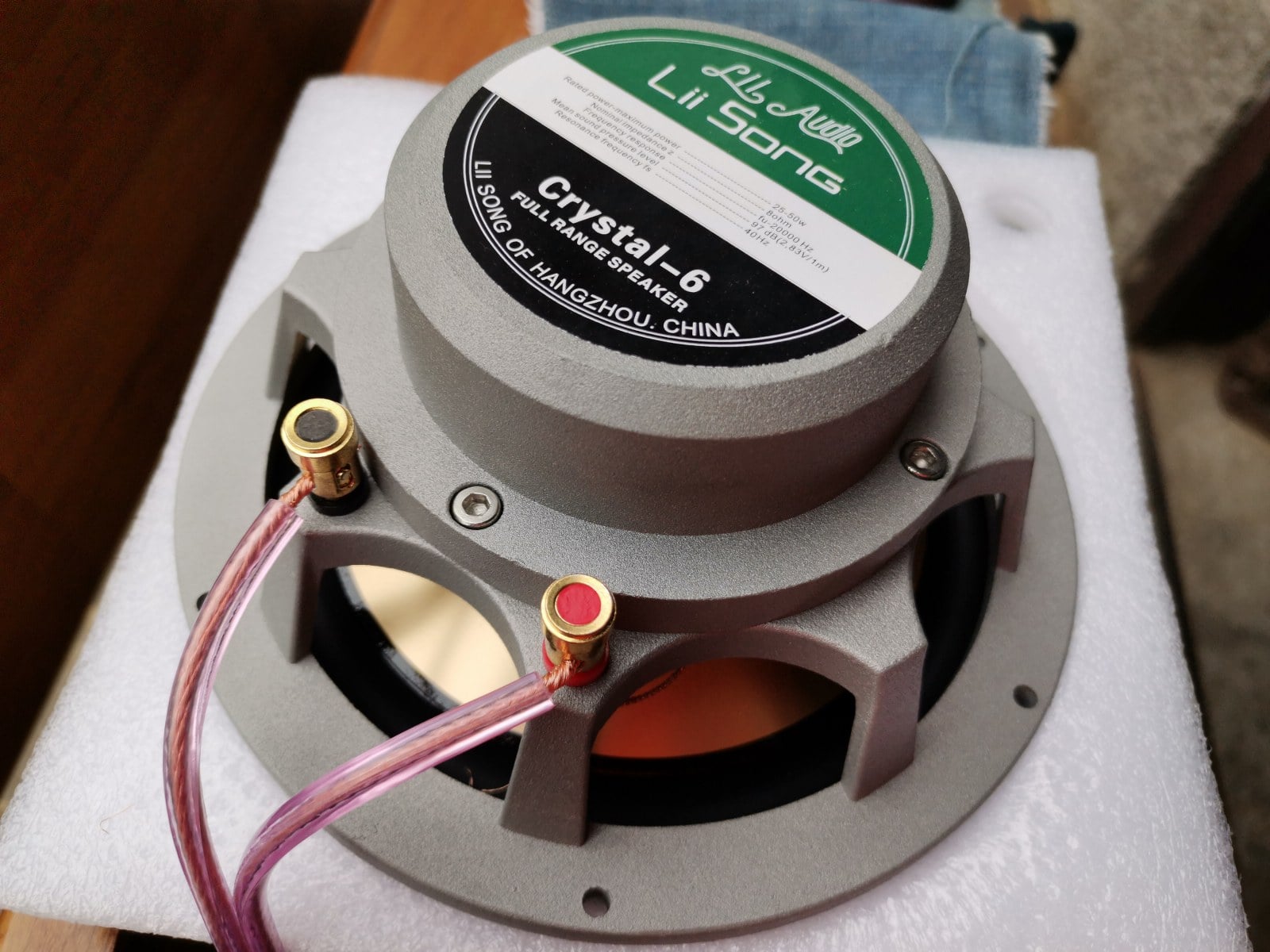

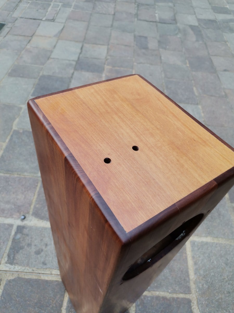

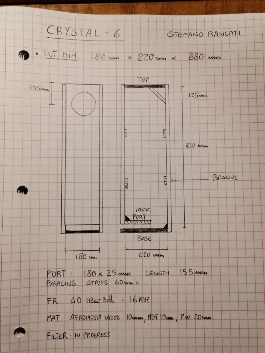

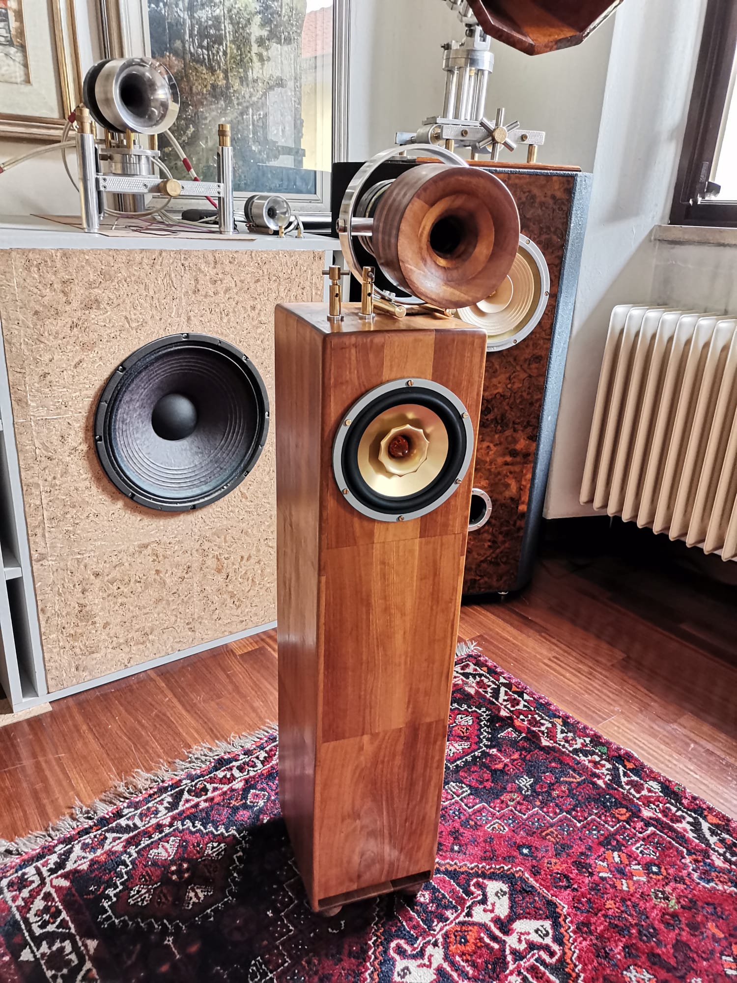

Not a tool but a nice compact enclosure I made for the Crystal 6 fullrange.

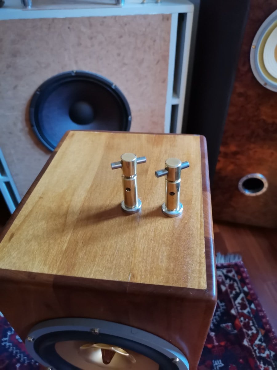

Good and deep bass according to size, silent port well tuned. It's not so sensitive like other drivers of the brand. Neodym magnet, alu cone with heavy whizzer and phase plug. Good performer in voices, mids and highs, useful freq range 40hz-16khz, it needs baffle step contour circuit or dedicated eq to compensate the effect. I made custom binding post, brass body and 316L.
The wood is the beautiful Afromosia Rio, I applied 7 hands of 50% boiled linseed oil-turpentine, plus 2 hands of carnauba-bees wax with polishing machine.

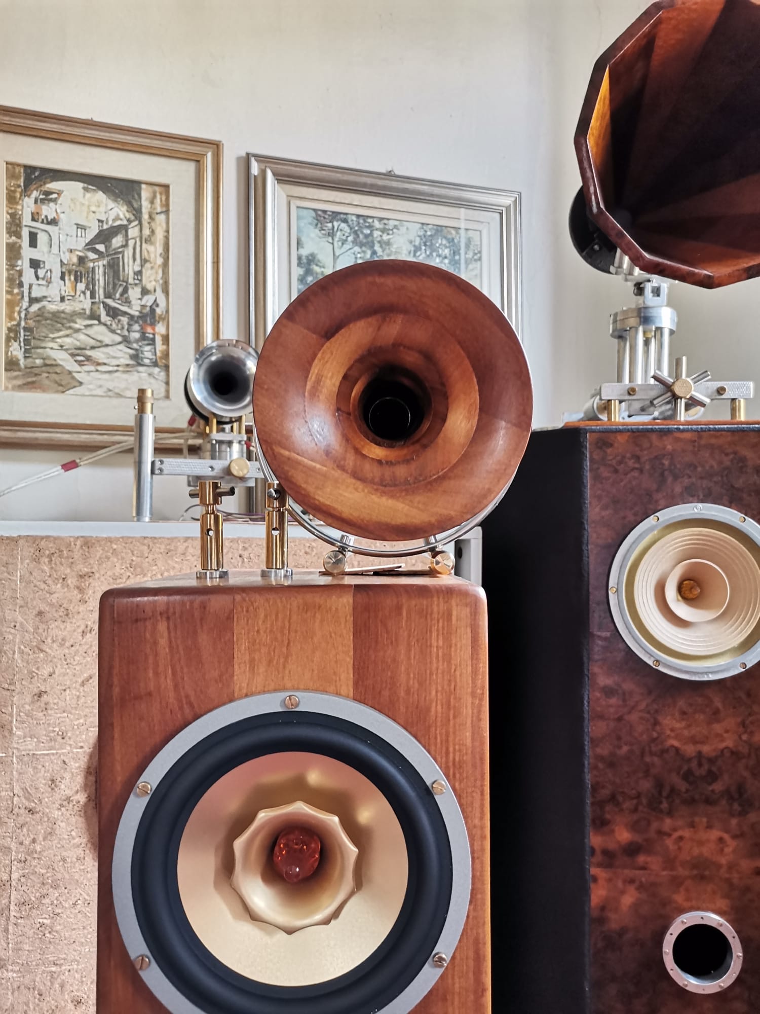

I just finished a round tractrix horn for compression driver, I'm playing in two ways config to break-in both unit in one time
