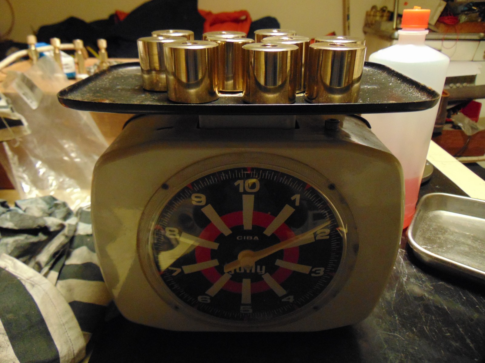

Hi all!

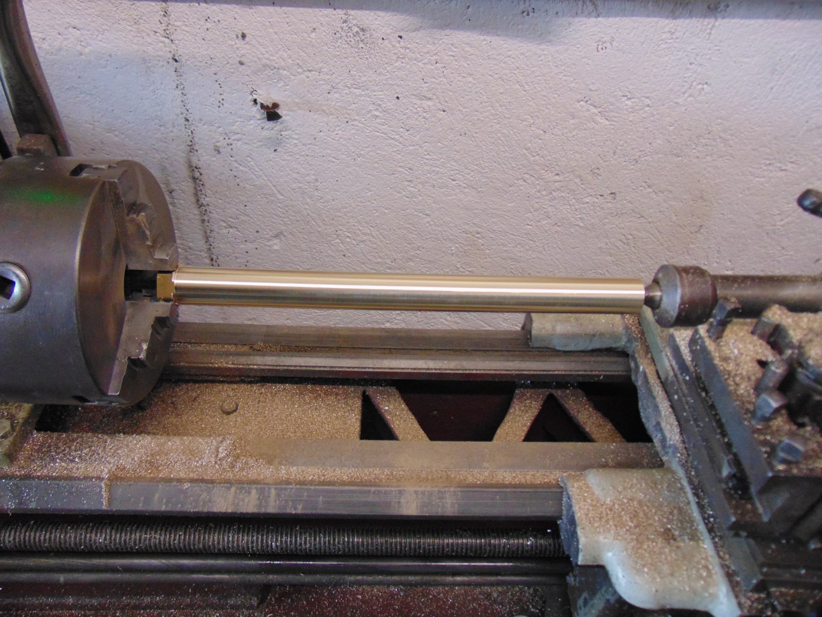

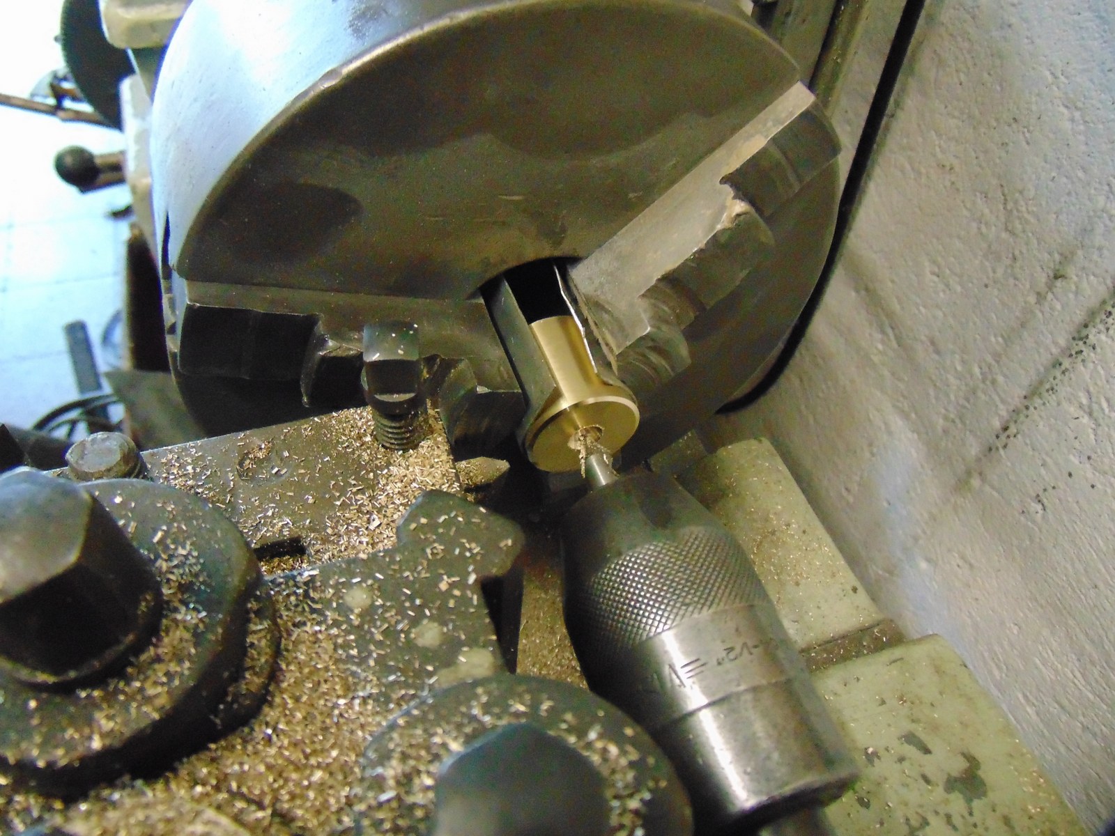

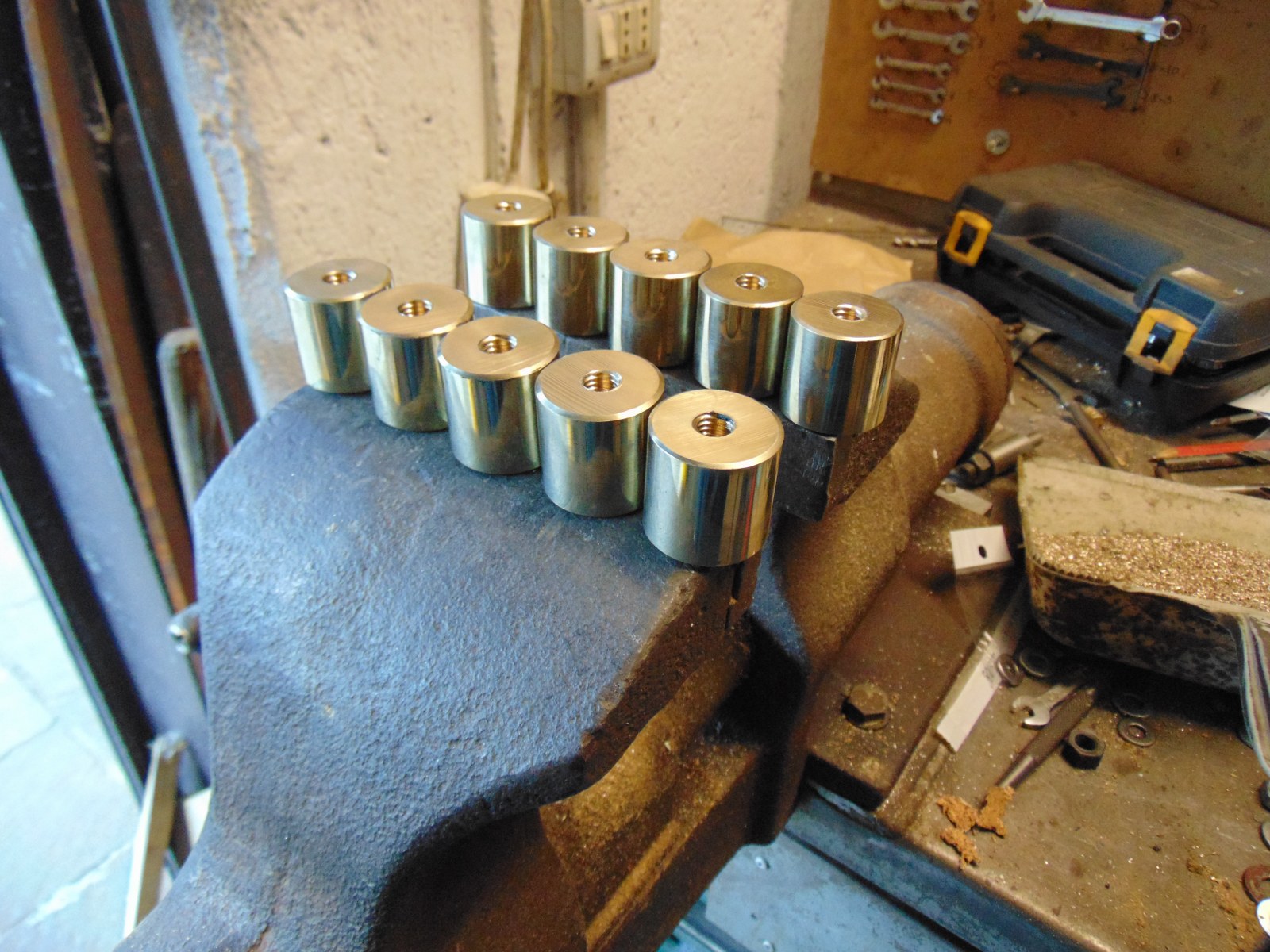

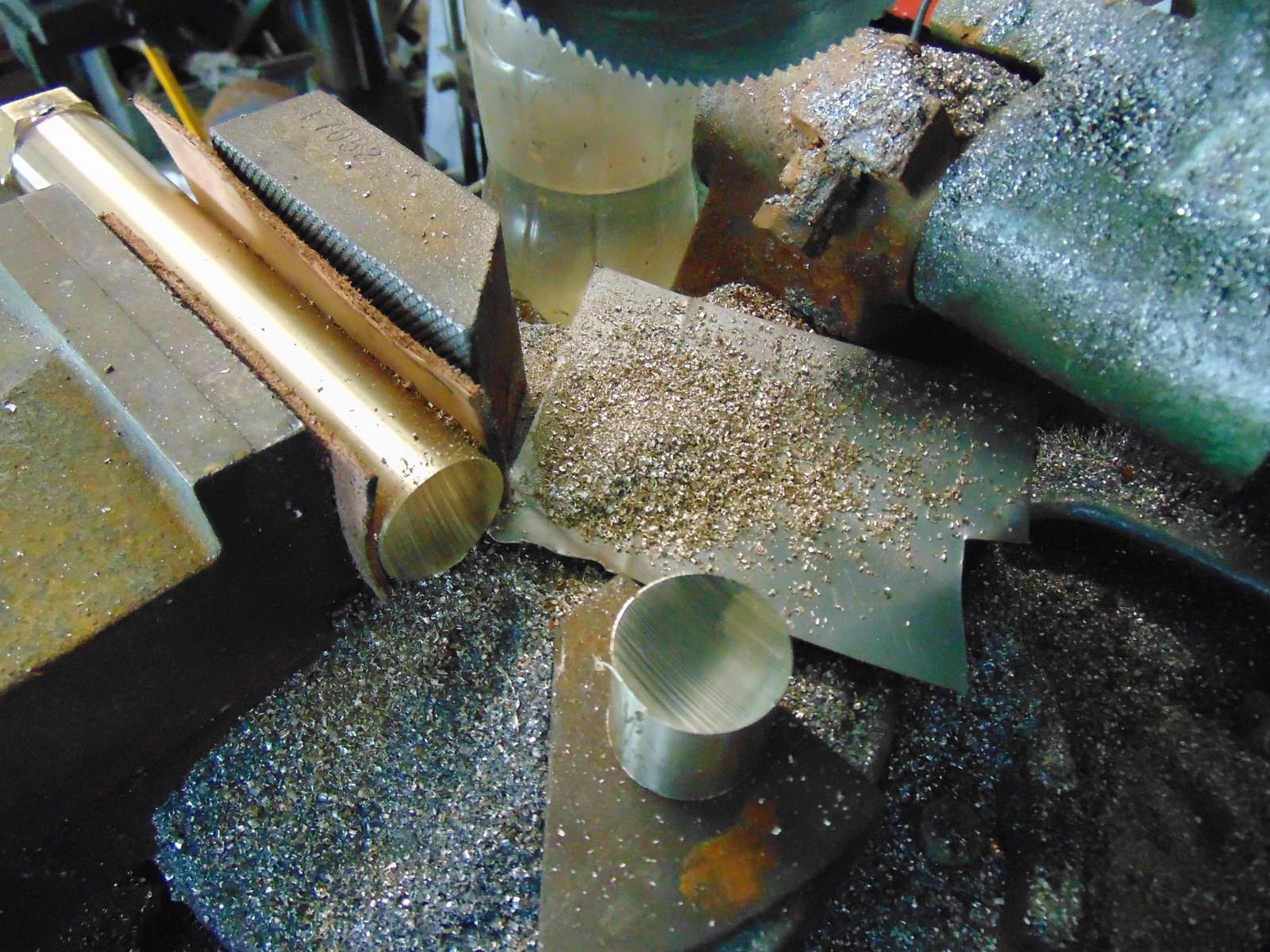

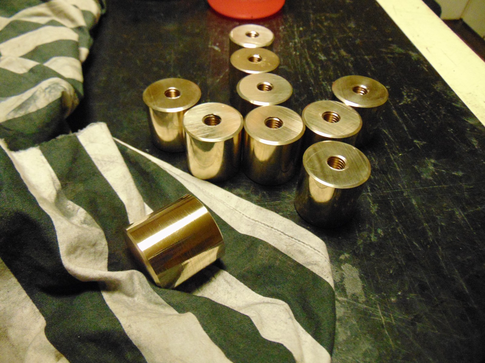

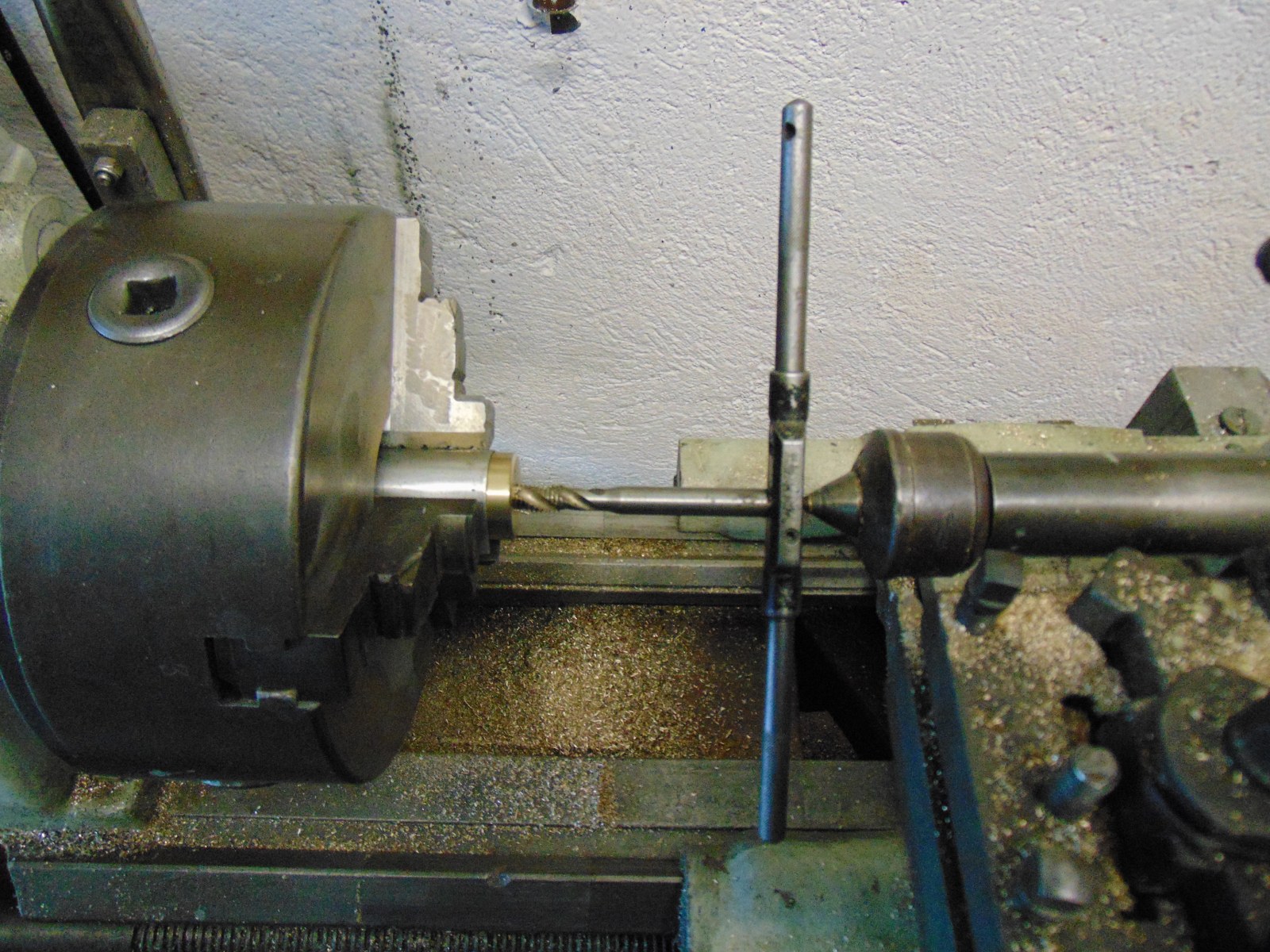

Just finished ten feet for my new speaker project. Considering material and shape, they are clearly overkill for my purpose, perfect for heavy load.
Solid brass, 30mm, M10, beveled and polished. 175 grams each one.
I leaved the surfaces rough to glue paloma cork in order to decouple.
Attachment 28908 Attachment 28909 Attachment 28910
Attachment 28911 Attachment 28912 Attachment 28913
Attachment 28914
