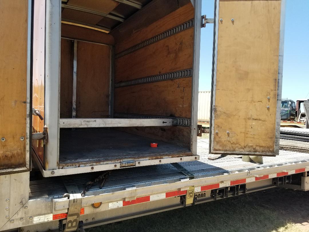

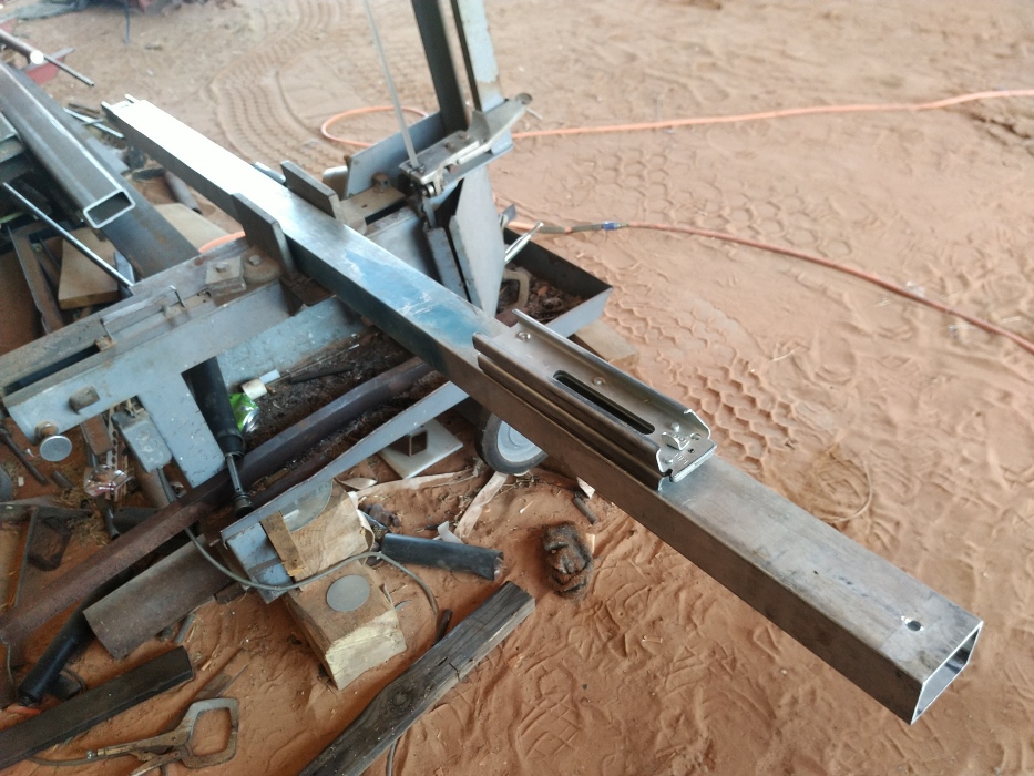

Custom length load bar
After mounting the drome on the trailer we came up with the idea to shorten some of our load bars I had several that were 8 feet and too short to be used in the 102 wide dry van so I cut the tubes to 50 inches than drilled a new holes and riveted the adjustable ends in place
This will help for securing the palettes of detonators or charges
