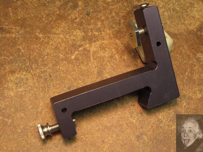

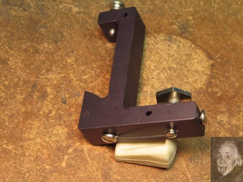

A further annoyance with the Unimat is the fact that when you loosen the clamp bolt that secures the power head to the round column, the head wants to slide down when all you want is to rotate it. It's also depressingly easy to let the head drop and smash a delicate mounted drill or mill into the workpiece.
To forestall this, I built a separate clamp. When it's locked in place the head clamp can be loosened and the head rotated with out dropping. It also serves as a safety to prevent unwanted head drops.
