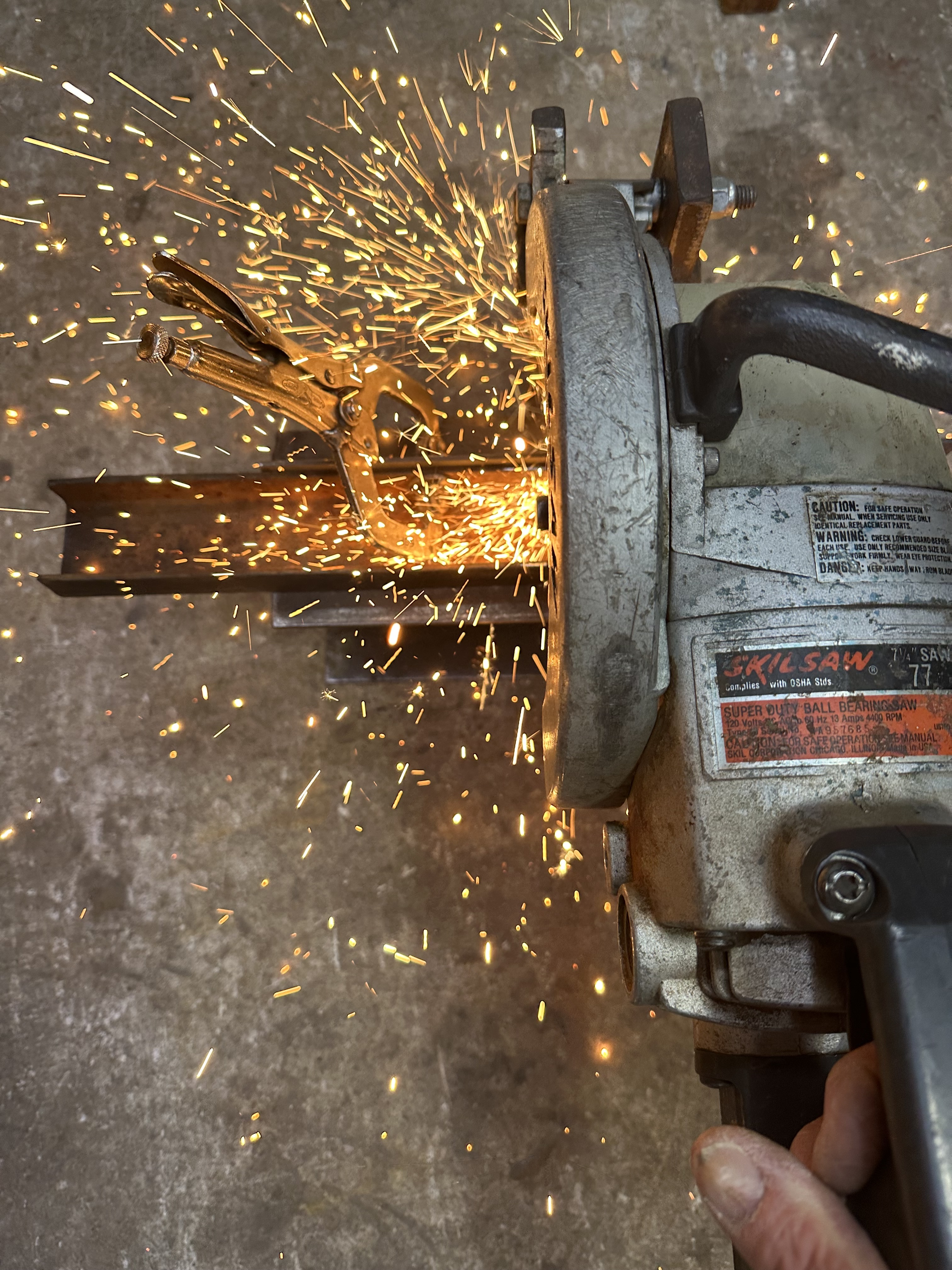

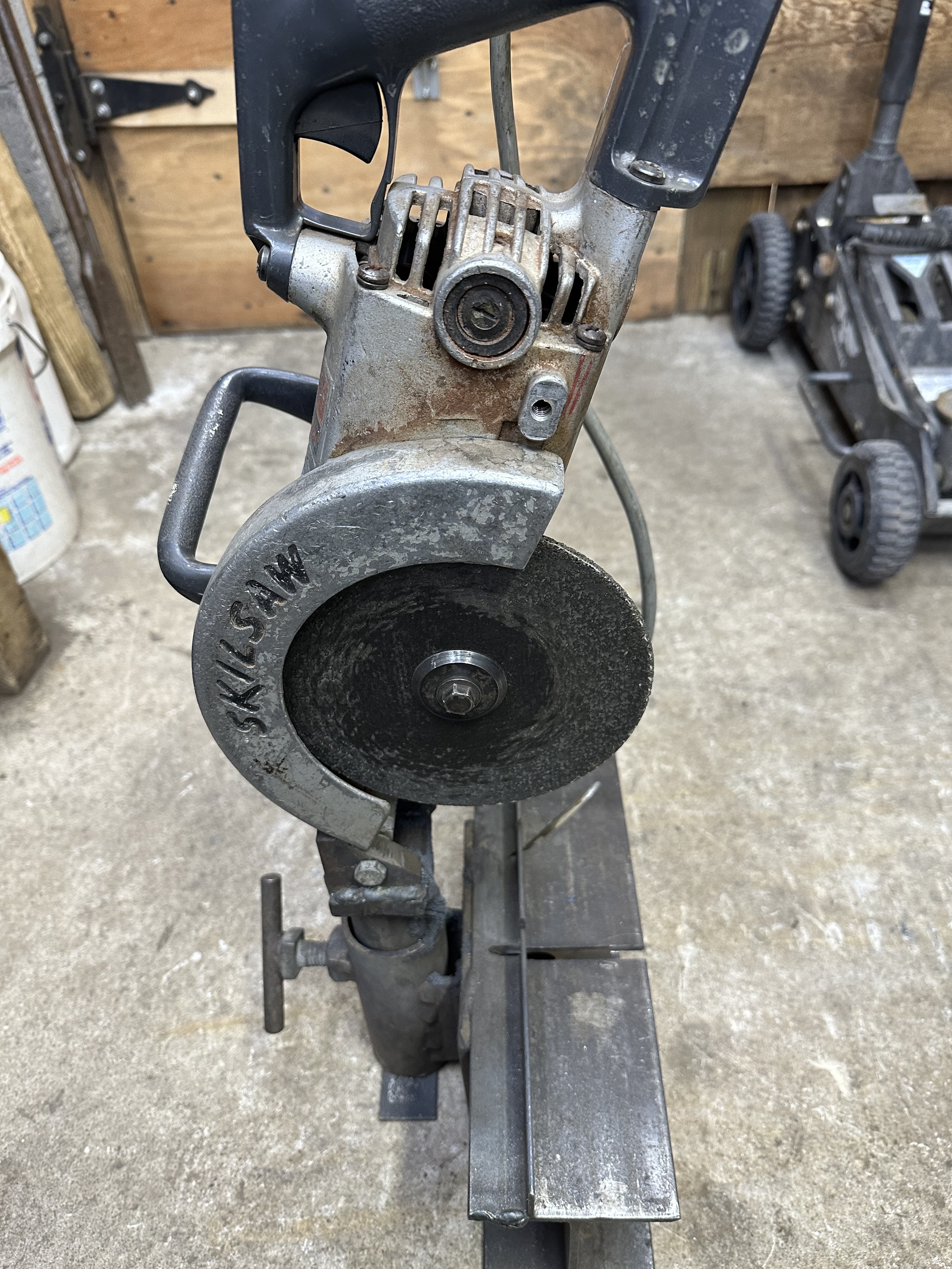

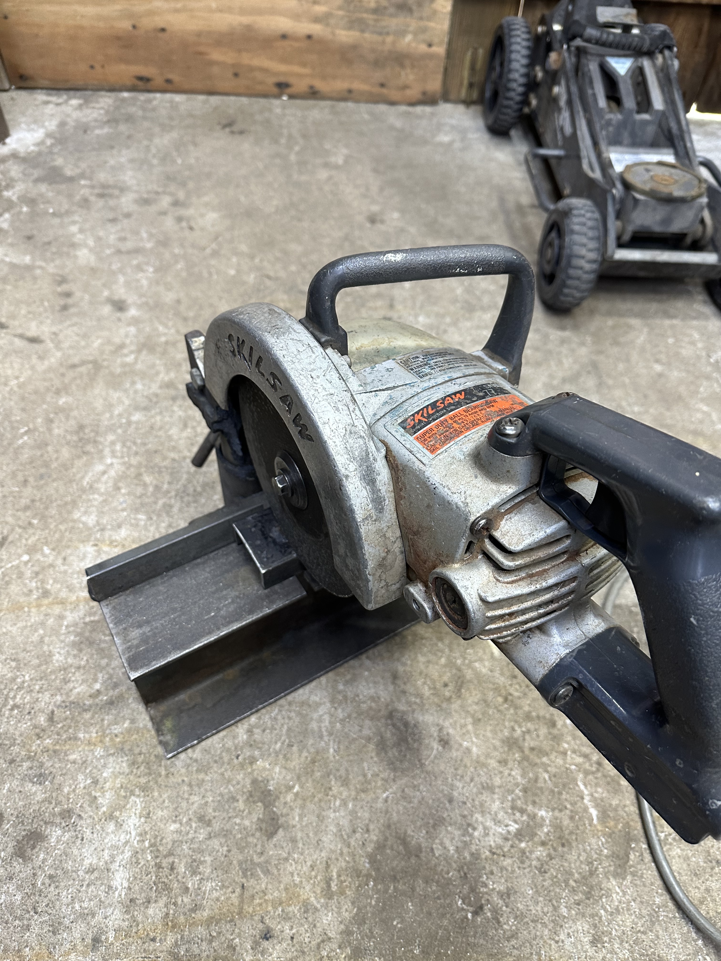

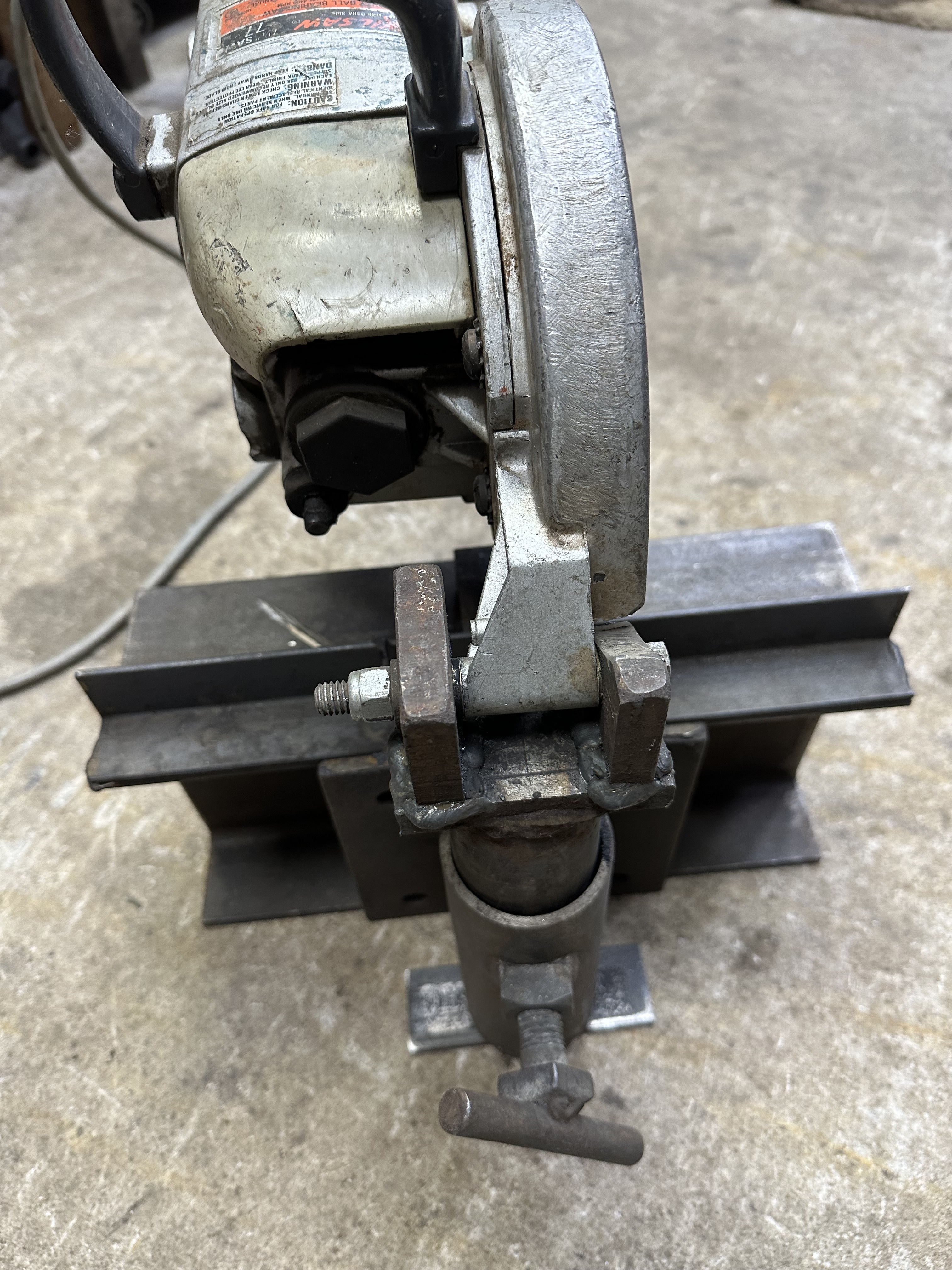

Cut-off saw from Skilsaw77
Many years ago (1983) I made a cut-off saw from a Skilsaw 77. I had been doing repair for the local carpenters for some time and I ended up with some spare parts. I had built a bench-mount engine stand for my girlfriends VW Bug. After I did that job I knew I would never do that again. I turned the engine stand into a mount for the Skilsaw. I still use it and it is quick and powerful. I use a 7 1/4 metal cutting blade...
