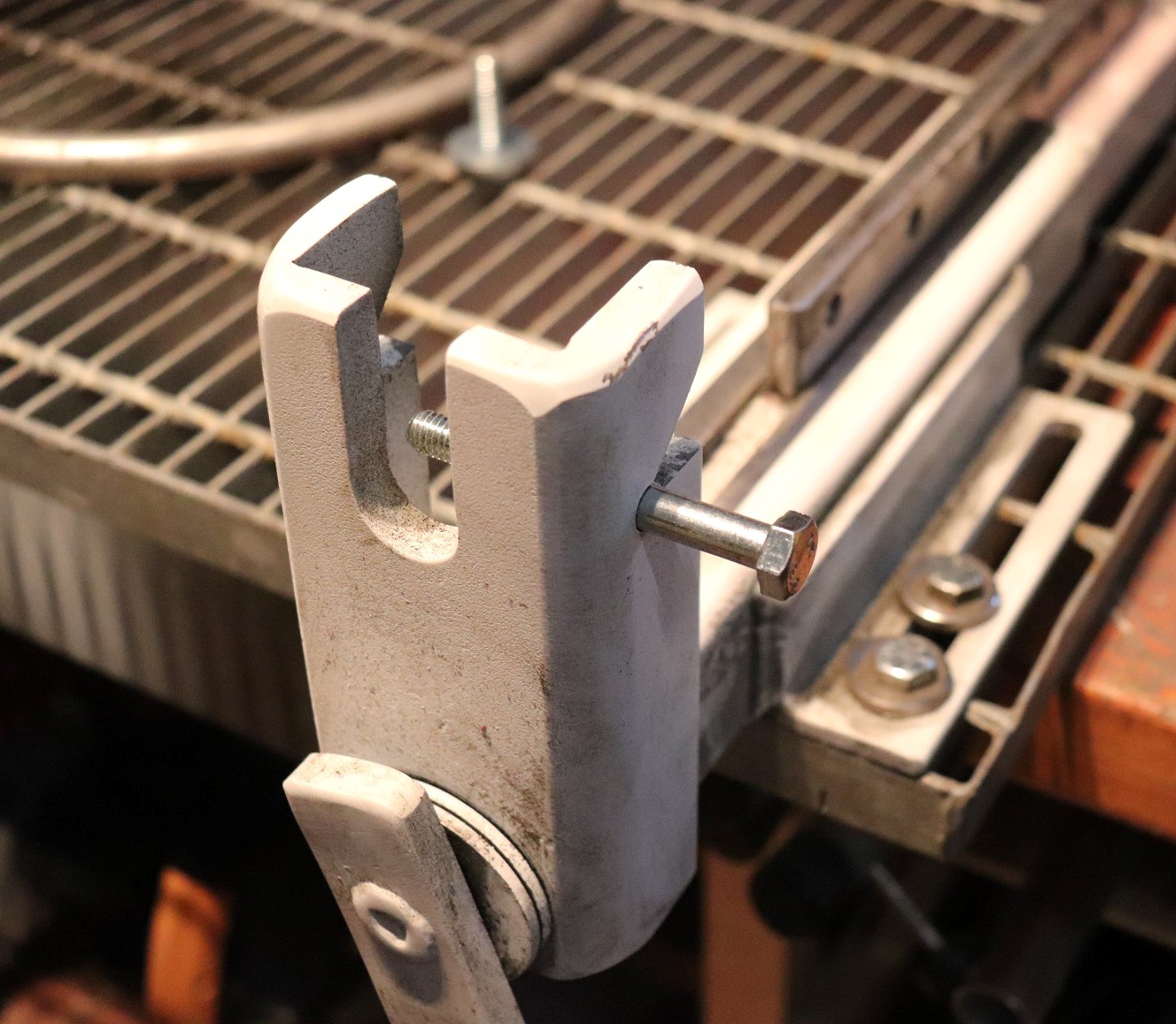

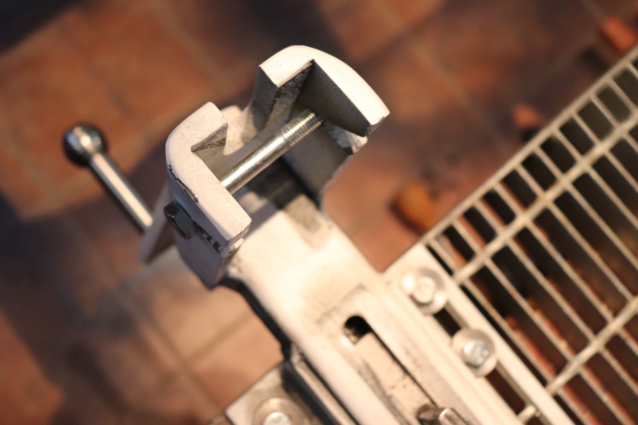

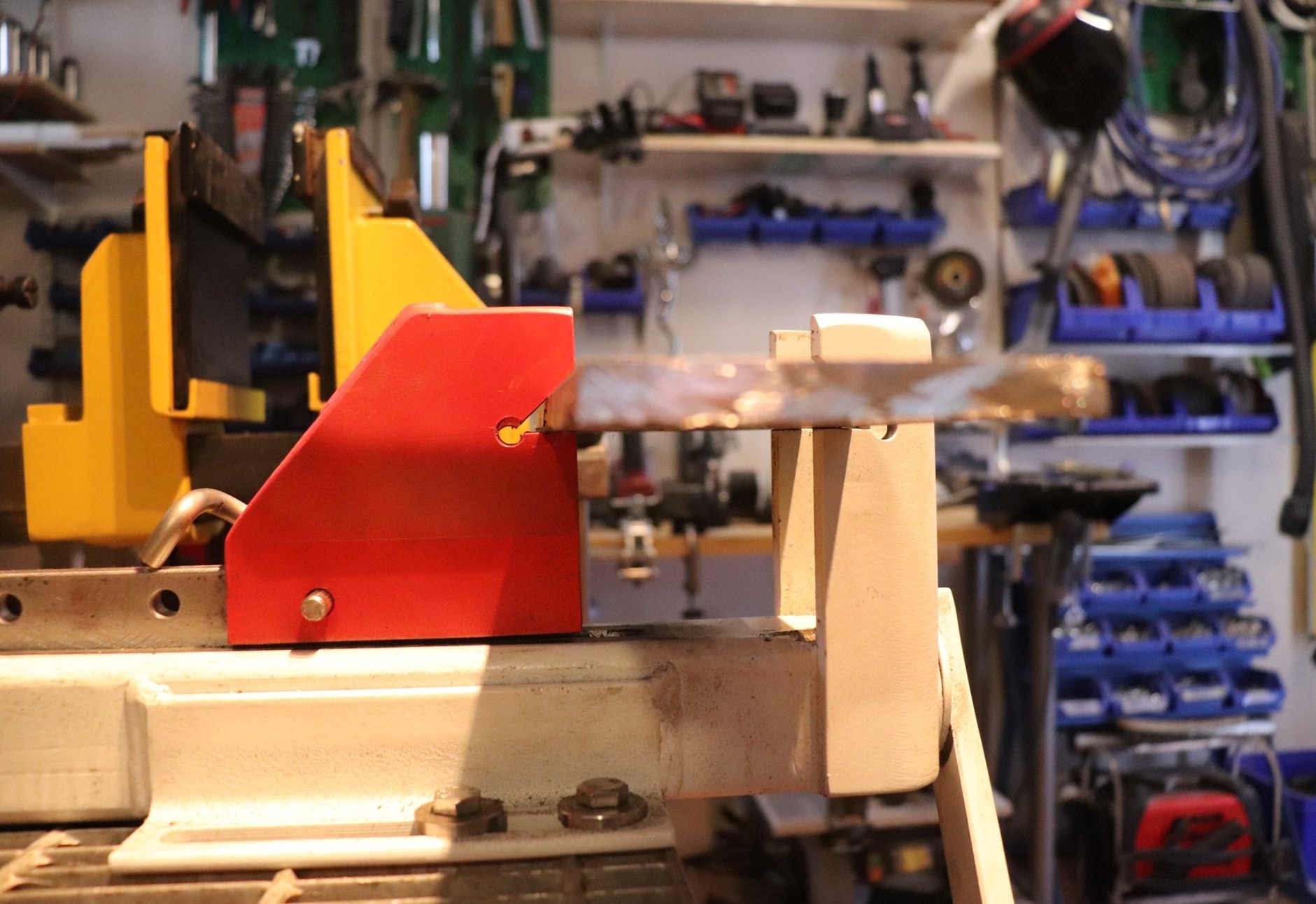

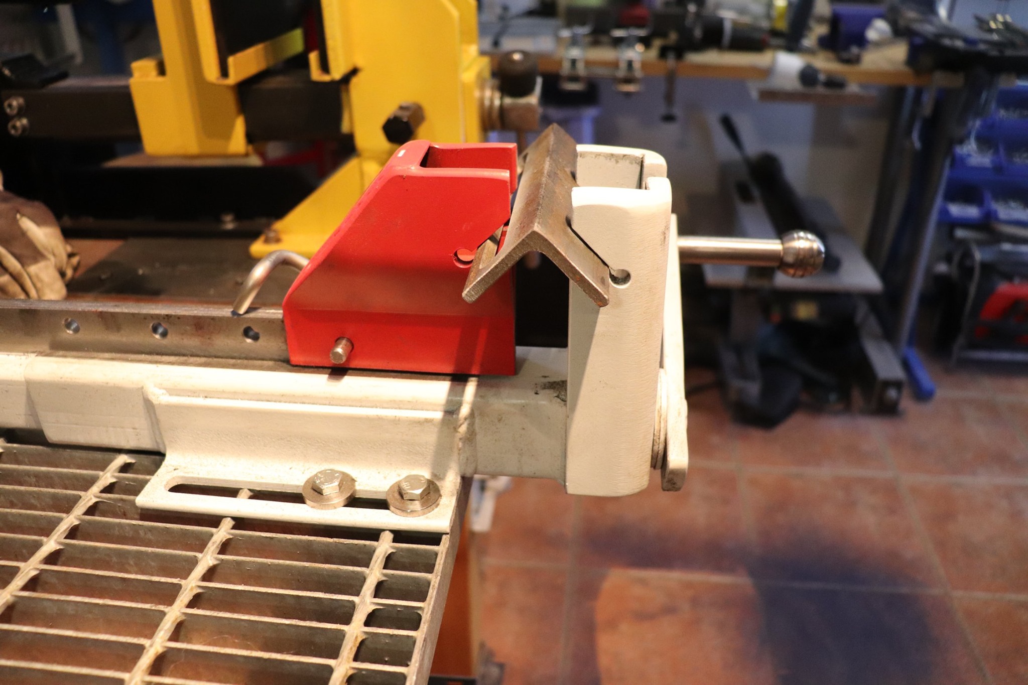

Here is some pictures.
As you see, Half V shaped jaws works nicely for holding different shapes.
Attachment 34458 Attachment 34459 Attachment 34460

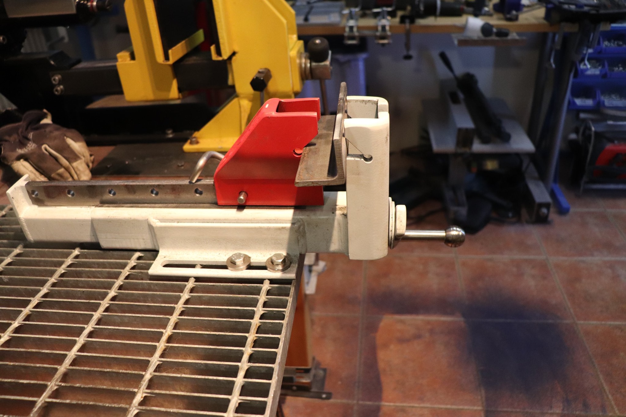

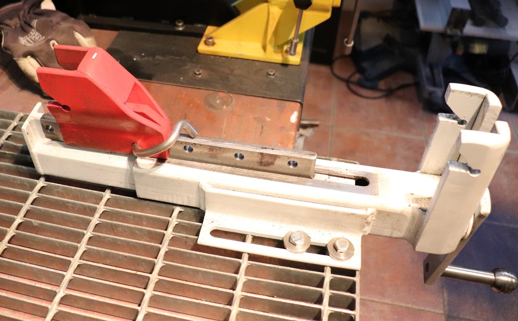

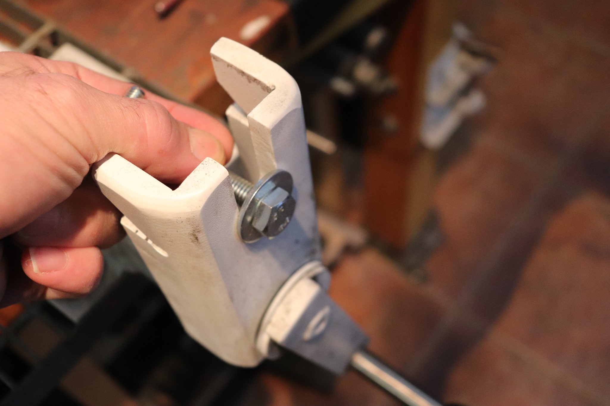

Of course, sometimes you need bigger jaws too.
These holes and this latch is to allow mounting of optional jaws / tooling.
Attachment 34461 Attachment 34462 Attachment 34463

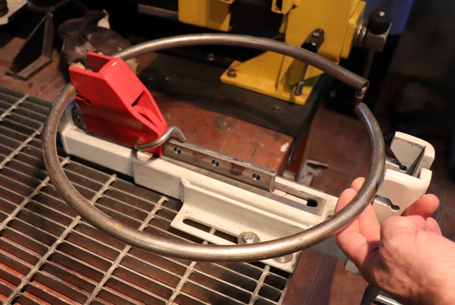

Also, Red jaw can be turned 180 degrees, and clamp can be used for pulling / spreading too.
Attachment 34464
Example, for rounding elliptical pieces etc.
