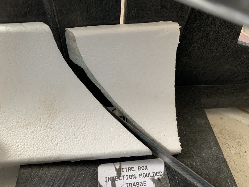

Attachment 37177
Then I tried a hacksaw and the miter box, and that did not work either.

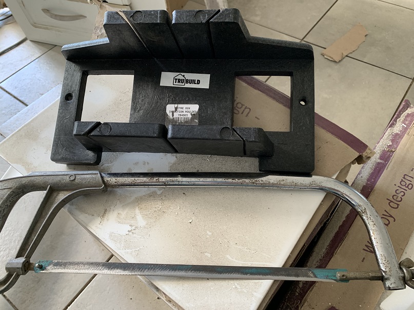

Then I simply ground away the hacksaw teeth and sharpened it like a knife.

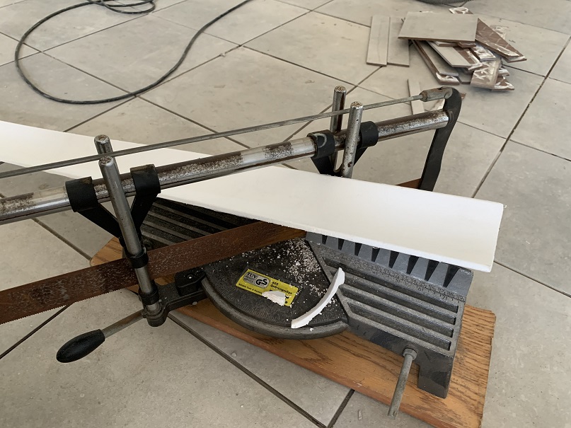

Attachment 37178
Using the miter box I now produced repeatedly a clean and accurate cut.
Attachment 37179
