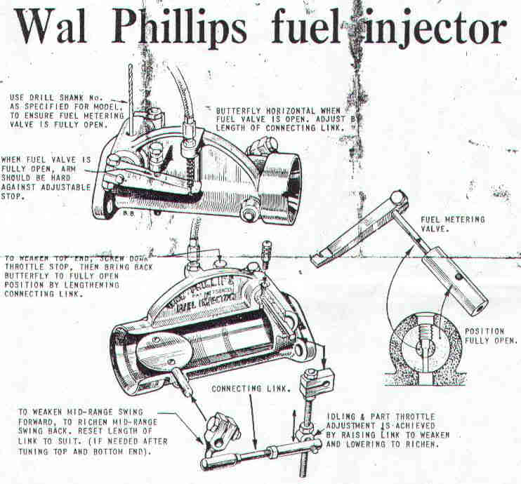

    Thanks guys for all your motorcycling memories, you have all had more machines than me it would seem. My best bike was a pre unit 650 Triumph Trophy much modified with a BSA Goldstar front end. Bob Joyner cams, SW valve springs, 10.5:1 pistons etc. also running twin Wal Philips so called fuel injectors.
    The Wal Phiips devices were a pain to tune because the fuel/air ratio was adjusted on the fuel valve as was the throttle stop, which meant that after each adjustment of that you had to go and adjust the air valve opening and then the throttle stop.
    I reversed the controls. That is; the throttle stop and cable were put on the air valve as was the ratio adjustment. So instead of 3 adjustments each time there was only 1. It made them so much easier to set up. In Australian racing at that time we could use any fuel and I made some WP clones with larger fuel valve spindle to take the larger holes needed for alcohol.
    Click on pix for full size versions.
    Here is a pic of the WP "injector" for those unfamiliar with it.
