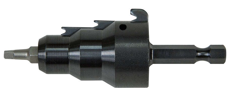

If you are running a lot of ½ inch conduit (EMT), removing all burrs can get tedious. Yet, one burr can cause the insulation to be cut and ultimately cause a fire.
I propose using a step drill to deburr the inside of the EMT effectively. A flat file is still used on the outside.
