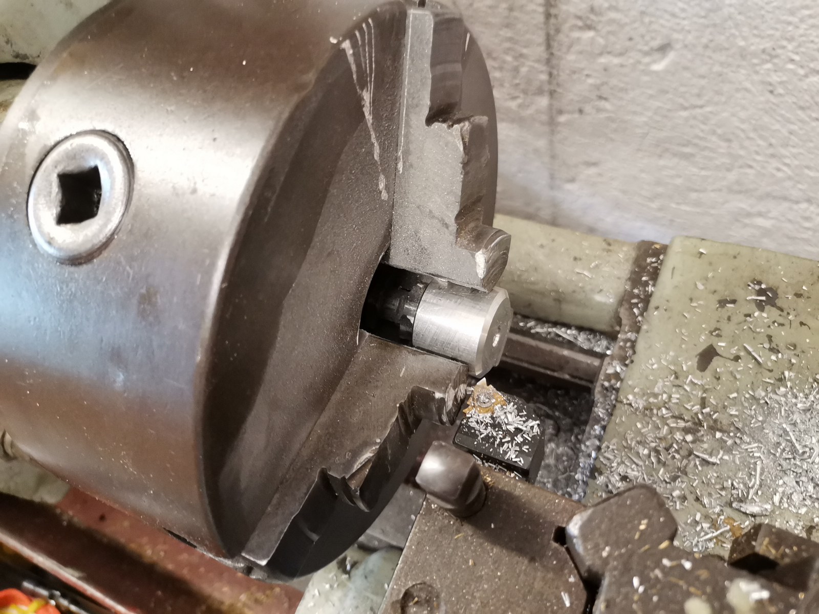

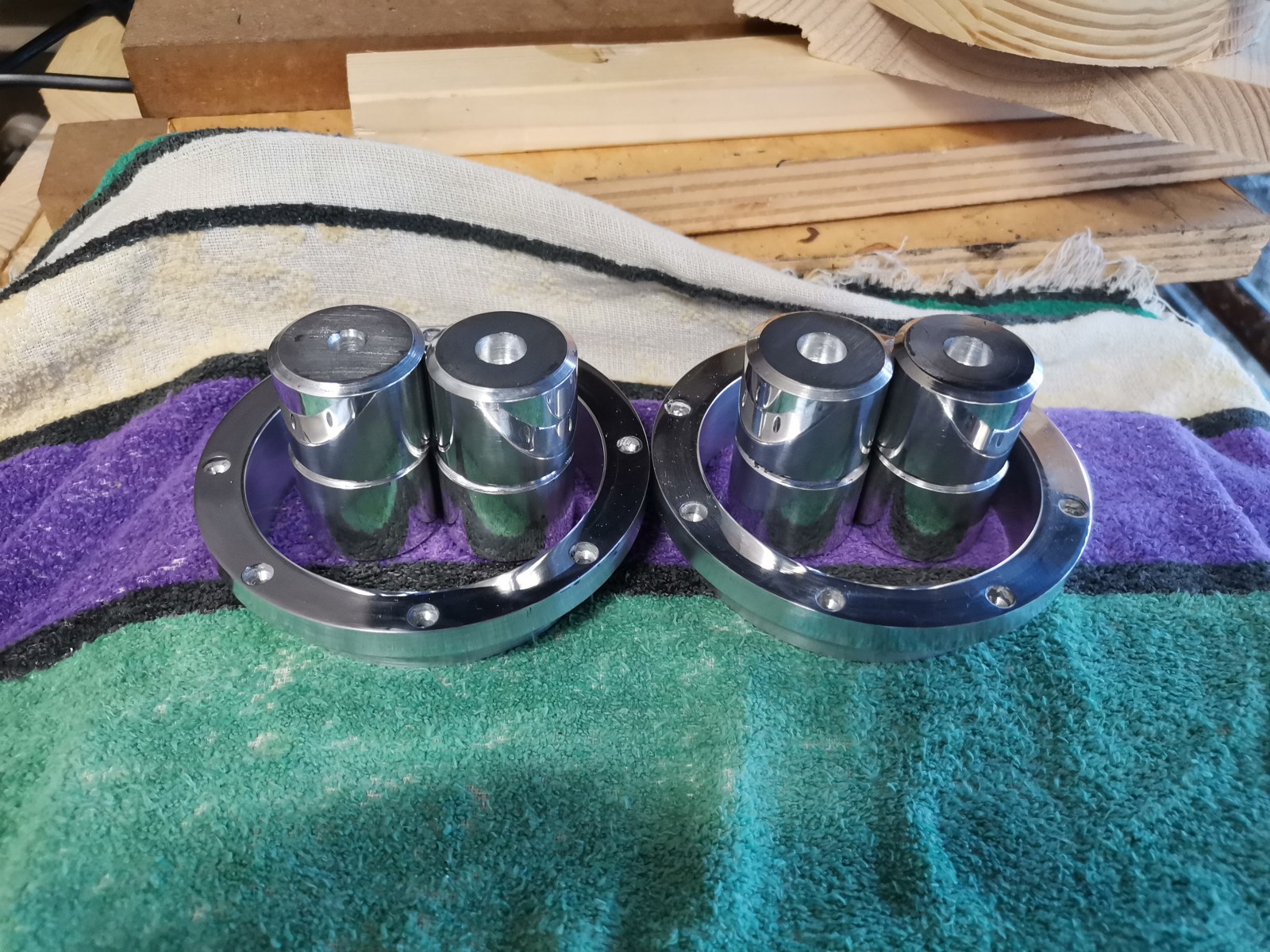

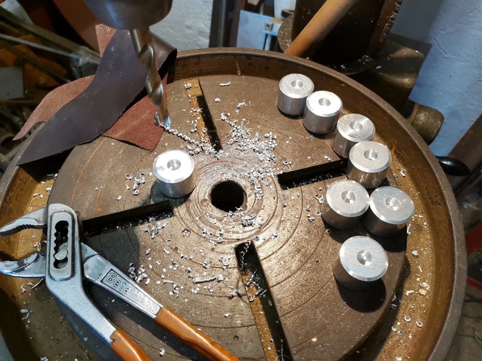

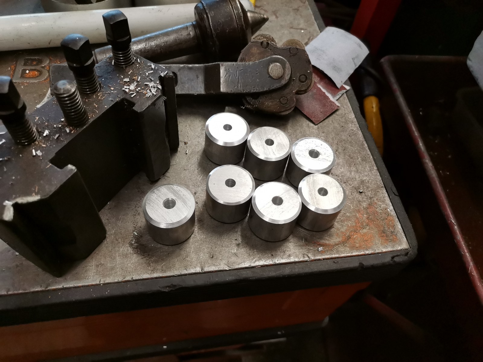

Hi!
Just finished a set of decoupling feet from T7075, easily machined with lathe and hand polished.
Hole with countersink for hex M6 screws. I leaved top and bottom surfaces rough to couple with adhesive felt.
These feet will be installed on a speaker enclosure, equipped with M6 fullrange (Lii Audio), considering the material and the shape, they could be also used for other heavy loads.
Attachment 36492 Attachment 36493
