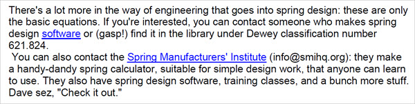

I paged through, but didn't read closely, the book Jon recommended and, while it seems a comprehensive treatment of the subject, I didn't see any mention of how to calculate the size of the mandrel on which the spring is wound.
Such a mandrel must have a diameter less than the desired ID of the finished spring since, due to spring-back, the spring diameter will increase once removed from the mandrel.
Kozo Hiraoka, a master builder of miniature live steam locomotives, studied the subject of mandrel sizing in depth and developed a set of equations for use by the DIY spring maker. His work was published in Home Shop Machinist, July/August 1987, pg. 30.
I converted his graphs and equations to computer code and developed a program to calculate mandrel size. Here's an example of the output...
Kozo Hiraoka's SPRING WINDING MANDREL DIAMETER CALCULATION
Wire type: music wire [0] or phosphorus bronze (1) [0] ?
Wire diameter [0.04 in] ?
Spring inside diameter [0.203 in] ?
Recommended mandrel diameter = 0.180 in
The program, MANDREL, is available for free on my page, the URL for which is in my sig.

I can manipulate those equations into Excel but was hoping for some simple online calculators. Again, that link seems to go nowhere. Some of the spring manufacturers calculations I've found on my own are not bad, but after inputting the usual parameters (OD, wire size, coils, length...) they seem more orientated to direct you to their (sales) offerings, more like a database lookup system.
