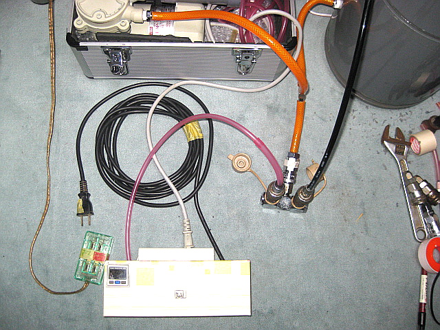

Showing below is a set up for a Laser displacement detector at the back, but not seen here though.
Attachment 23520
White rectangle box at the center bottom is the controller. A grey cylinder in the right upper is an air buffer tank.

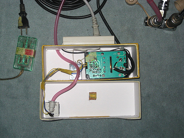

Case was made of card board, black cord leads power to an AC-DC converter that makes 24 DC volts. This converter was from a tad troublesome set up of Fluke handy oscilloscope, which needed some repair.
Attachment 23521
A white small box sitting in the lower box(which is a lid) in the left is a positive pressure sensor, this works in 24 DC volts and is connected to a relay.

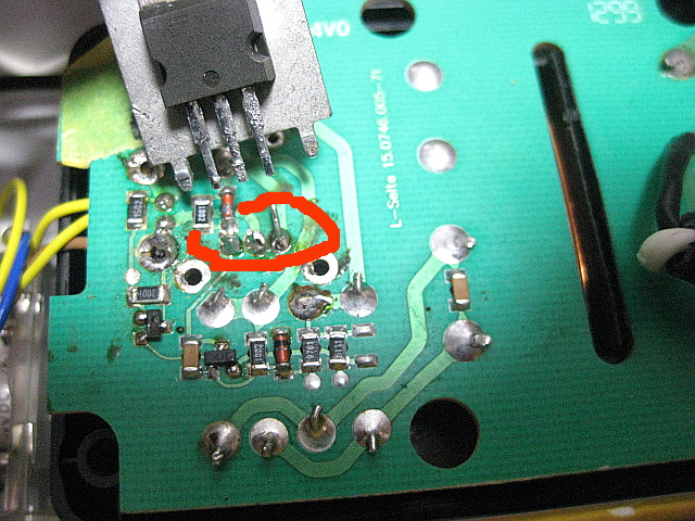

The trouble about this AC-DC converter was that its MOS-FET transistor, it was gone.
Attachment 23522
Replaced it with a new one.

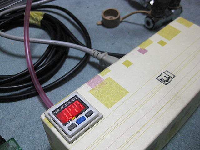

The setting on the sensor is so called Normally Close, with which the pump starts when you plug the line in.

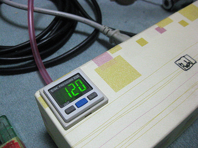

Now the pump is moving and this indicator shows pressure in red.
It stops when the pressure goes to any set value, e.g. 0.120 M pascals in this case, and the indicator turns to green.
Attachment 23524
