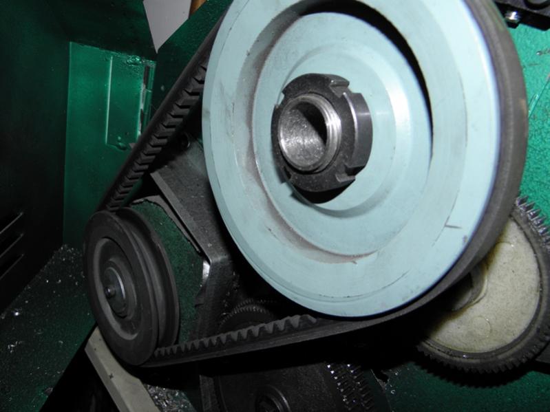

Direct Drive Lathe 1/2 inch belt to the D.C. motor no gears.

This must be pretty quite operation when running at moderate speeds. Also looks like another way to boost the RPMs for machining very small parts and when using a headstock grinder.
Mainly for the Variable speed control no changing gears except for thread turning. :O)
