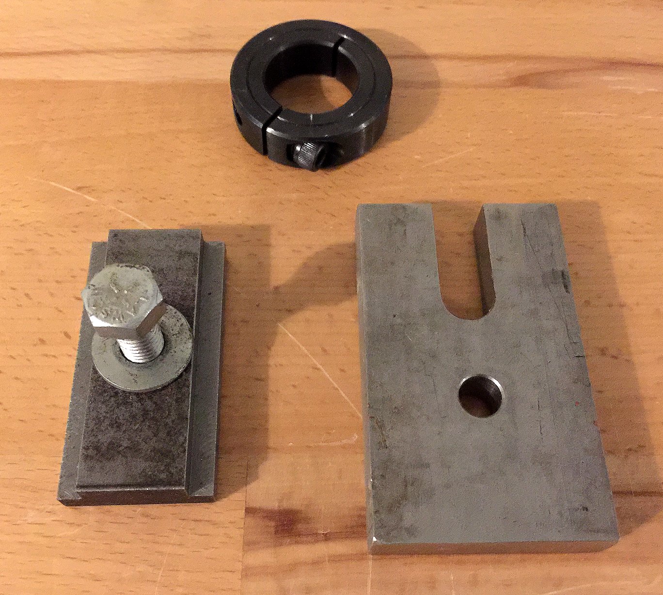

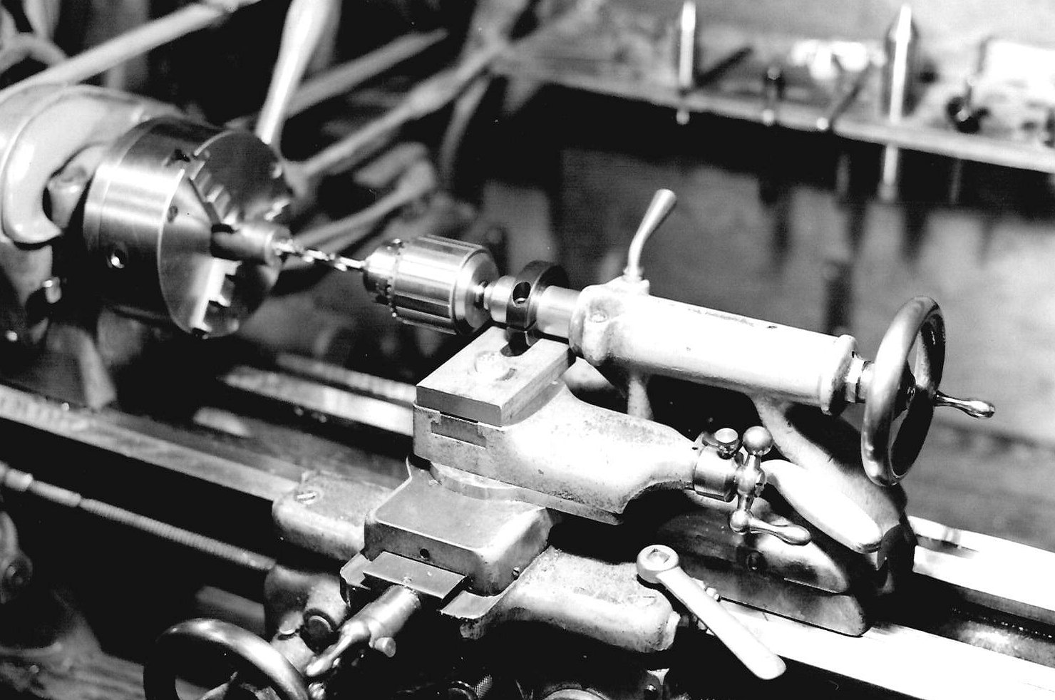

There are a number of lathe operations, such as center drilling, in which an automatic tailstock feed would be useful. This is easily accomplished in the manner shown in the photos. A clamping shaft collar is secured to the tailstock spindle. A forked bracket, mounted on the carriage engages the shaft collar. With the tailstock clamp slightly loosened, the longitudinal feed advances the carriage and tailstock at the desired speed.
Attachment 37932 Attachment 37934
