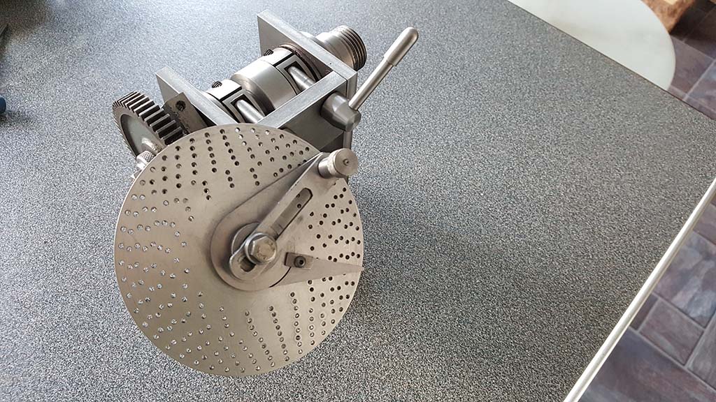

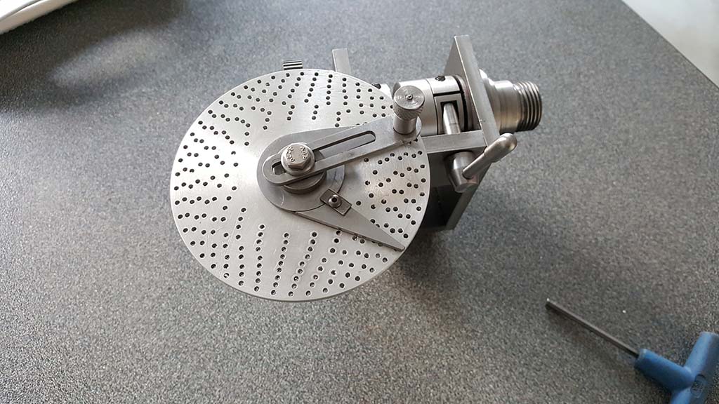

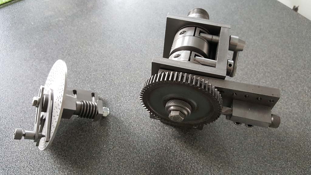

I just finished making my dividing head to Harold Halls Design amd I am quite
pleased with how it turned out as it allows me several ways to do division
Firstly I can do direct division using a gear wheel
Attachment 14892
or I can do direct division using a dividing plate
Attachment 14893

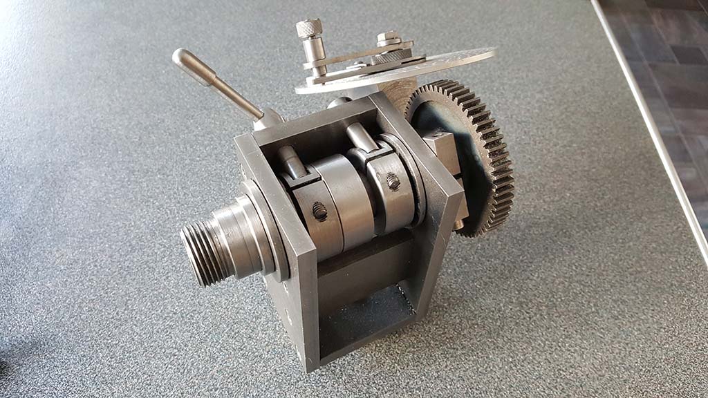

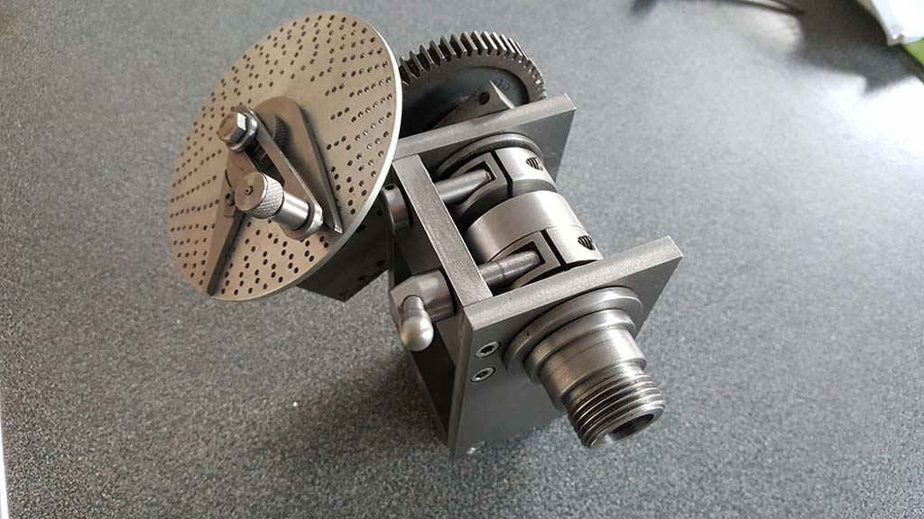

and of course I can do compound division using the gear and worm with a dividing plate
Attachment 14894

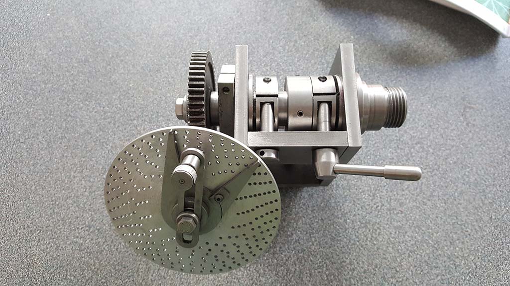

Unlike a normal dividing head that has a fixed 40:1 , 60:1 or 90:1 ratio I can simply chage the gear wheel
and have any ratio I want which then gives me more choices for divisions
The nose is made to fit Myford 3 or 4 jaw chucks, . My ER32 collet chuck holder and also has an internal
morse 2 taper so I can fit morse taper tooling
Attachment 14895

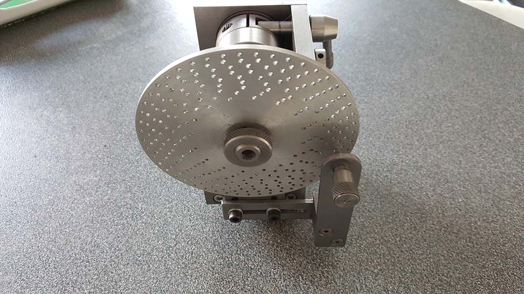

The didviding end can be swung around to any convenient angle
Attachment 14896
Attachment 14897
Attachment 14898

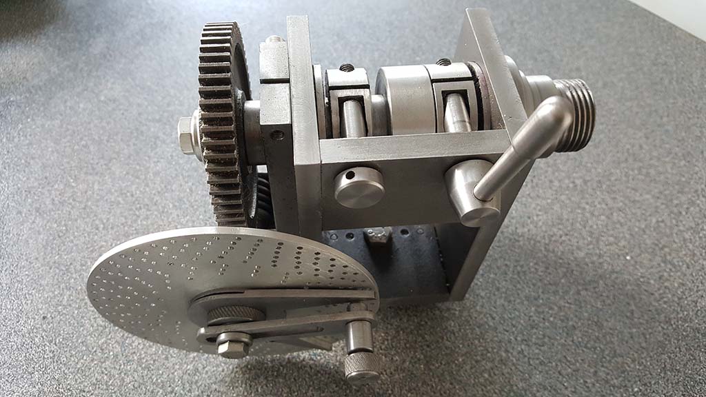

Here is a view of the other side
Attachment 14899
The plans are available in the Workshop Practice Series book number 37 " Dividing "
