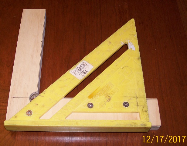

DIY Circle Center Finder
Attachment 20946
FREE Drawing! Details below.
The DIY homemade circle center finder tool shown in this video only took a few minutes to make and cost me nothing in terms of out-of-pocket funds.
I have several of the small plastic speed squares around the shop, so I sacrificed one of them for this project. I had some scrap ¾” birch plywood, and plenty of #8 x ¾” stainless steel, flathead, screws on hand. This handy tool would still be quite inexpensive if I had to buy the materials though, and well worth it!
Materials:
(1) 8” x 8” square piece of ¾” birch plywood
(1) small plastic speed square
(3) #8 x ¾” stainless steel flathead sheet metal screws
Actual time to make: About 20 minutes.
Link to Free Drawing (pdf Format): http://www.downeastthunder.com/wp-co...ter-Finder.pdf
Here's the video:
https://youtu.be/WaFiTP9Givo

Noice.
Looks like a great little jigger thanks Downeast thunder I will certainly make one.
Cheers from John in Aussie
Thanks JMACC52, and you're certainly welcome!
