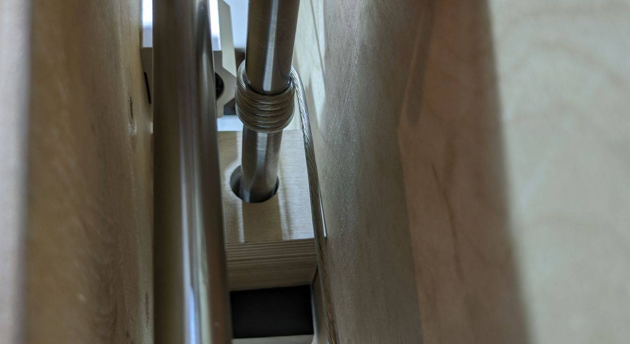

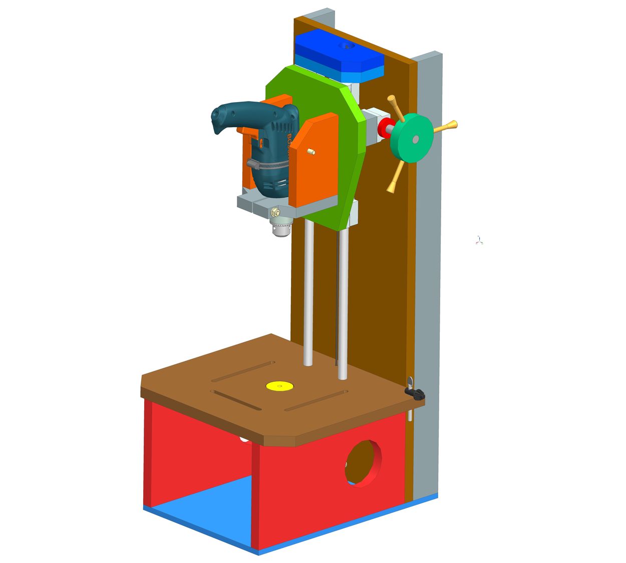

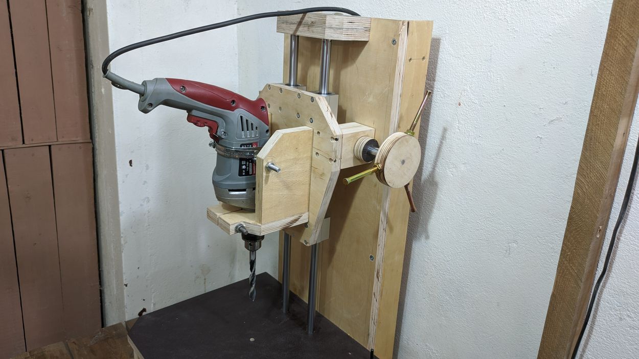

In my new video I will show you How to build a Homemade Drill Press Stand
https://youtu.be/O6aRoxANuLI

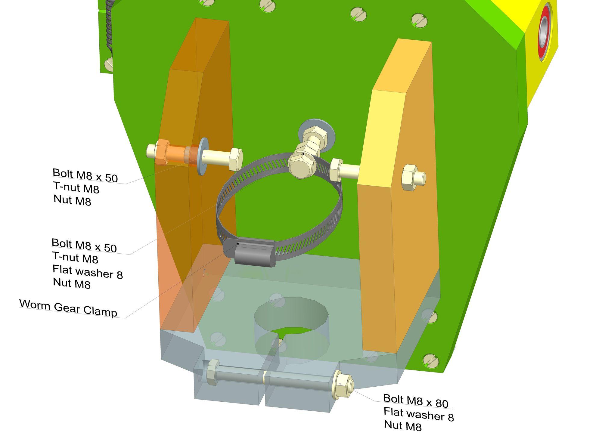

Free PDF plans available - https://mazaydiy.com/plans/drill-press-machine.pdf
Attachment 36456
Download 3D CAD model
