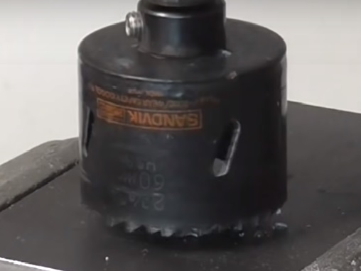

I would like to know what the hole saw is?
Ralph

Ralphxyz: Seems to be a run-of-the mill Sandvik HSS 60 mm OD hole saw*:
Attachment 39977
2 cents
Johan
Note: *I'm NEITHER endorsing this particular brand, NOR waving any patriotic flag this time either...:)
The video must have been speeded up cause that run-of-the mill Sandvik HSS 60 mm OD hole saw cut through the steel like butter.
