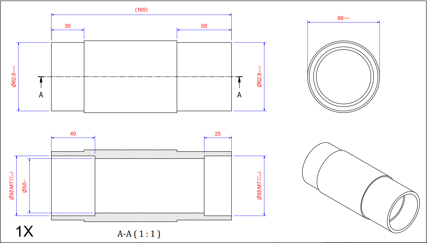

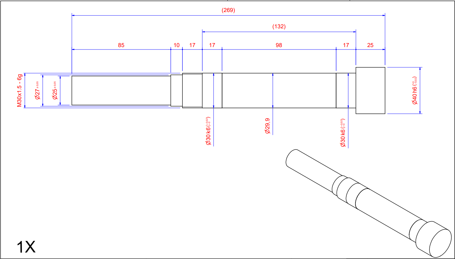

Attachment 46885Attachment 46886Drawings of the axle and bearing housing, including tolerances (in Metric)
