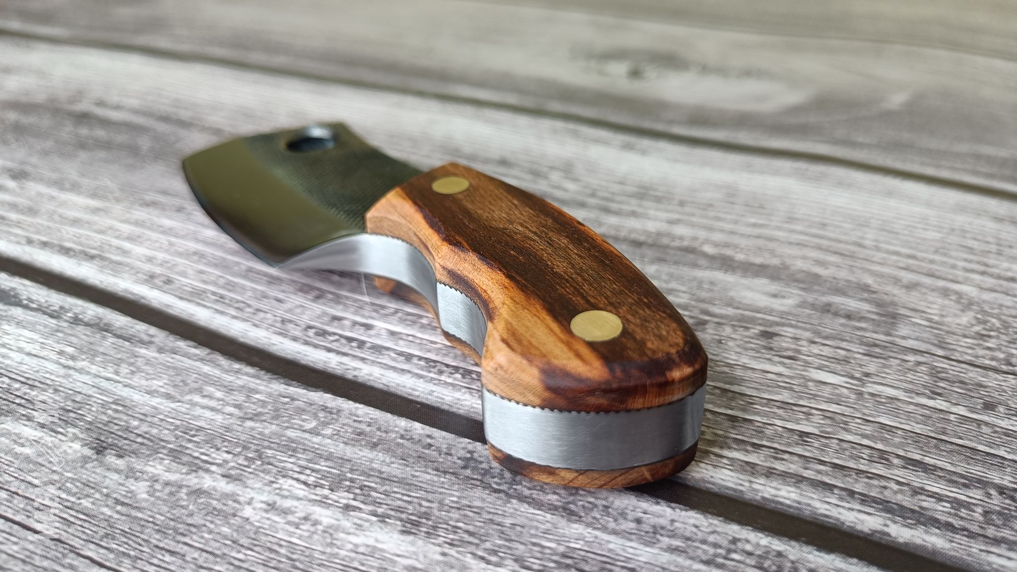

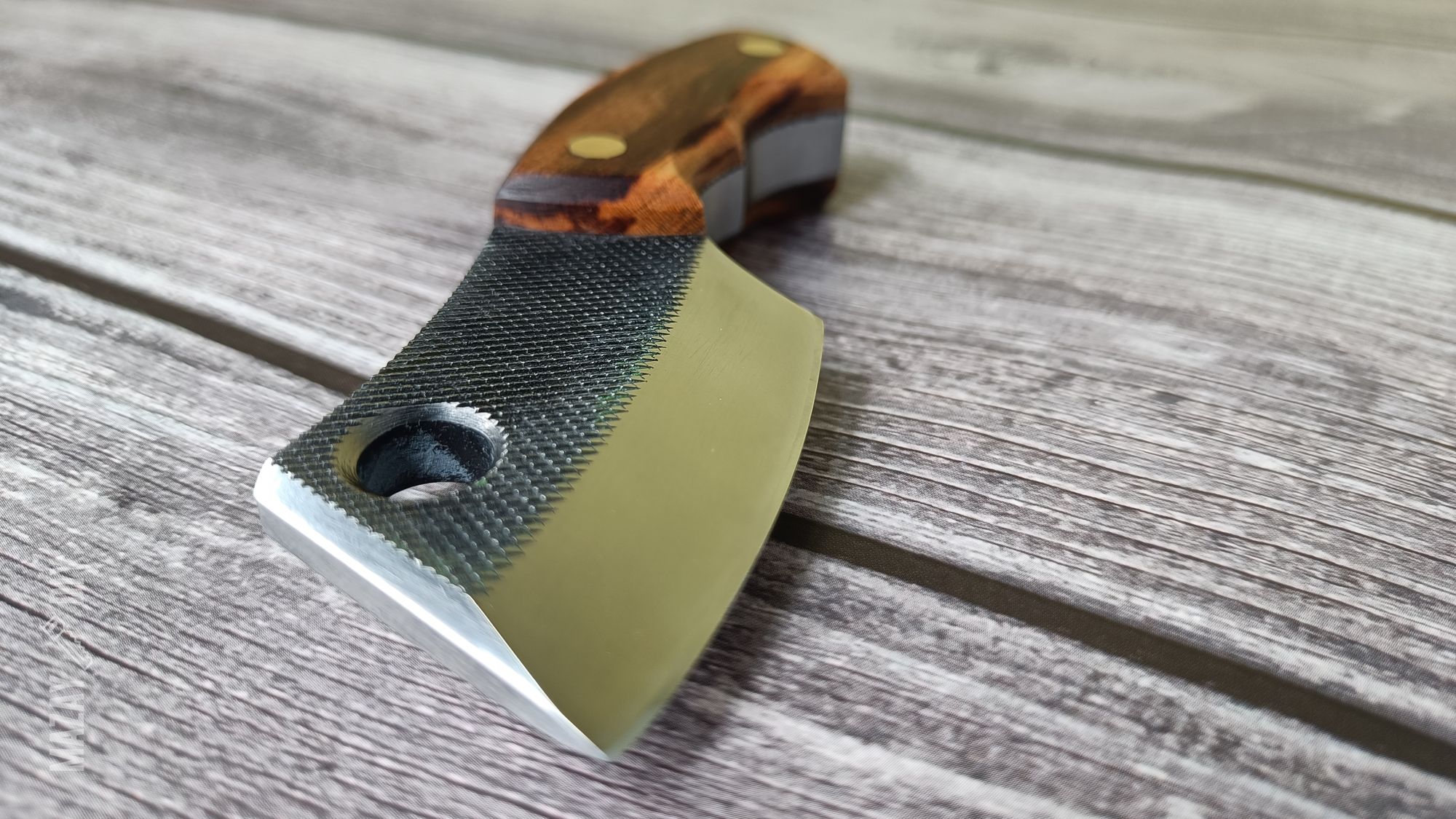

In this video, we're going to be making a Mini Cleaver knife out of an old file. This neck knife is small but mighty, perfect for those quick and dirty chores around the house.
https://youtu.be/Tu170orKqEM
Attachment 44203 Attachment 44204

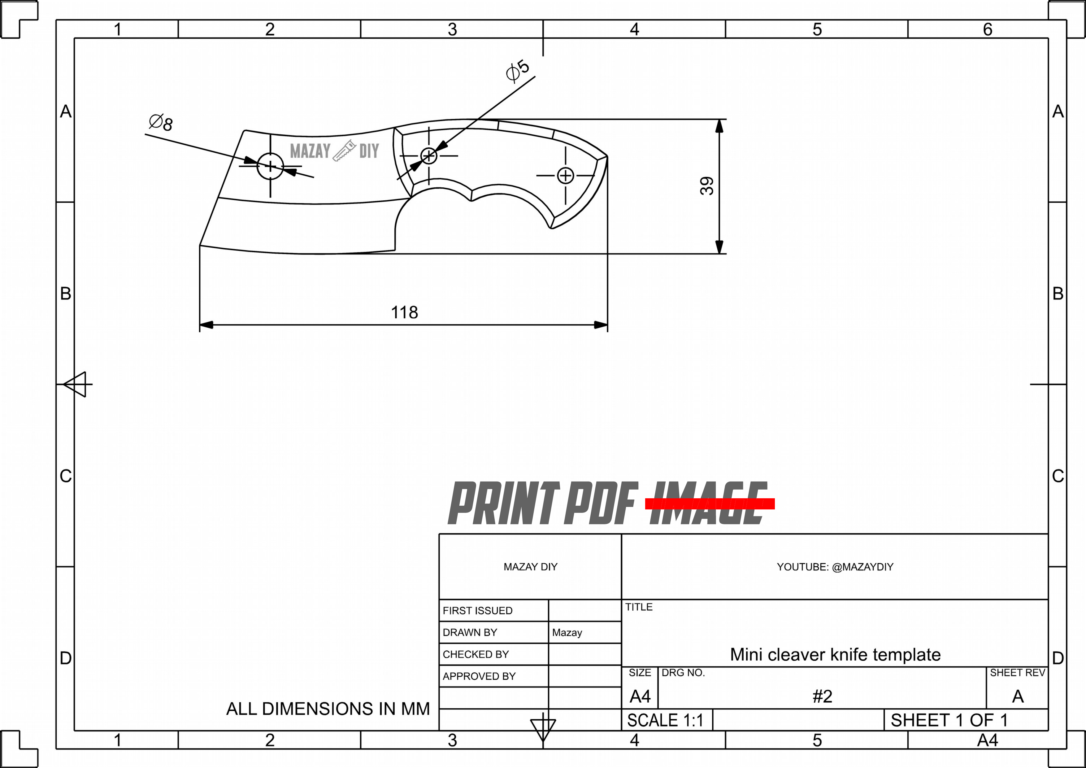

Mini Cleaver Knife PDF template
Attachment 44205
