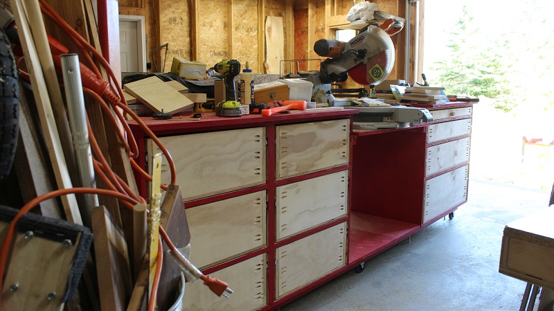

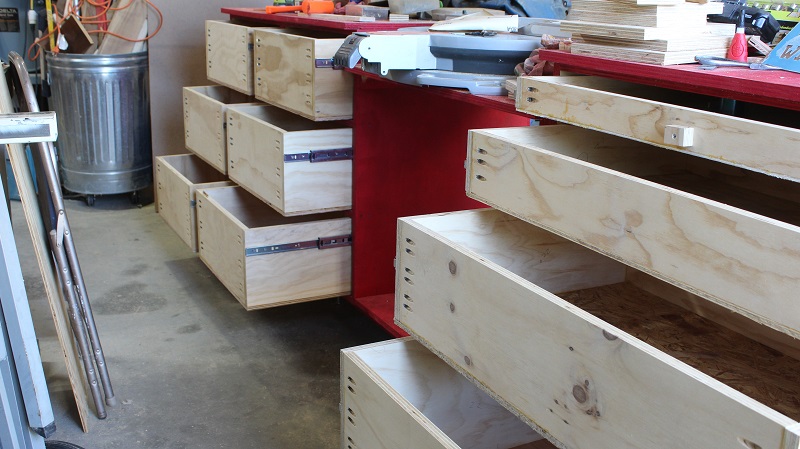

DIY Mobile Miter Station Base Cabinet Drawers (FREE PLANS)
Attachment 25831Attachment 25832
FREE PLANS IN BOTH IMPERIAL & METRIC DIMENSIONS!!!
In this segment, I’ll show you how I built and installed the drawers for my new miter saw station base cabinets. These are simply a basic butt joint with pocket hole joinery design that can be used in this application or with any other cabinets. The dimensions can be anything you wish in order to fit your own cabinets or you can change them if you are building this one if you wish to have more or less drawers in each cabinet, etc.
Note: This is Part 4 of a series, showing the construction of my new mobile, adjustable, miter saw station with cabinets design. You’ll want to subscribe, and “ring the bell” on my YouTube channel to make sure you are notified as each new segment is released.
My shop floor is uneven, and the new miter saw station will have to be moved to a few locations as I totally renovate my work shop. So – It must be mobile and adjustable. Rather than one long video showing the entire build of the entire miter saw and cabinet unit, I’m only posting each major individual part of the build at a time.
If you choose to build these cabinets in the metric system, simply round off the numbers given in the dimensions in order to make it easier for you to build it. None of these dimensions are hard and fast, and in fact, feel free to alter the dimensions. Make them taller or shorter, wider or narrower, etc. as is necessary to make the size of miter saw/cabinet system you wish. The measurements given in the drawings can be regarded as general guidelines for that very purpose.
