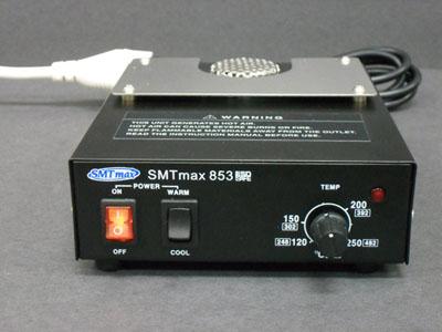

Here's a small preheater to show what I'm talking about. The temperatures marked are in C.
https://external-content.duckduckgo....jpg&f=1&nofb=1
