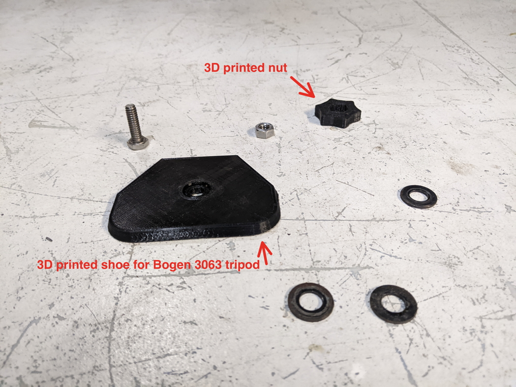

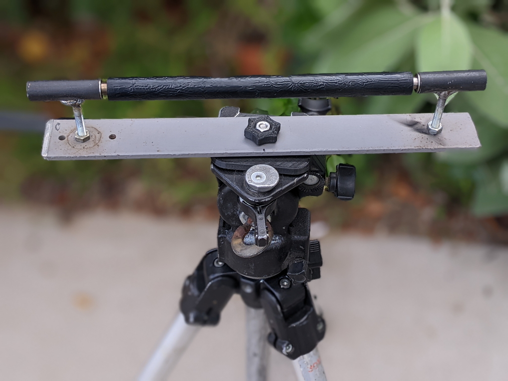

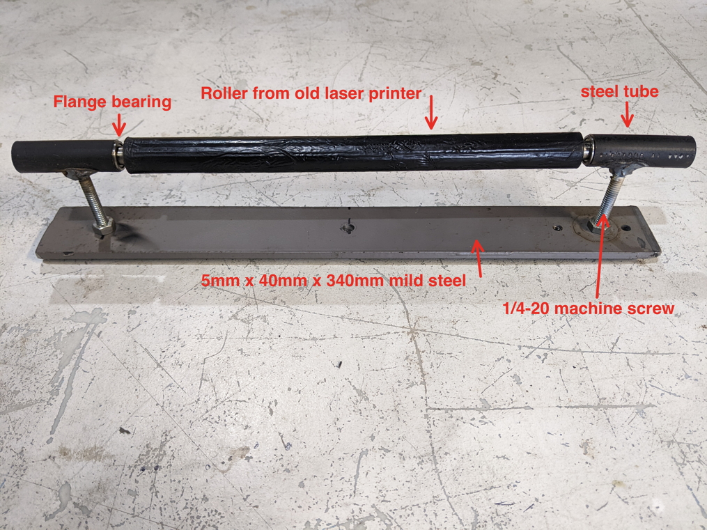

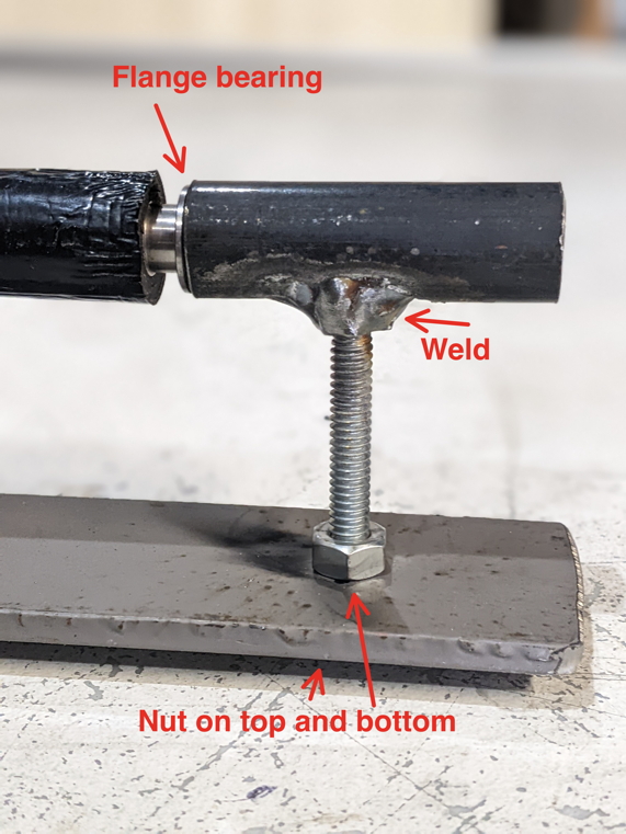

Photos should be self-explanatory. 3D printed quick-release tripod shoe/plate is for a Bogen 3063 tripod. Plate and finger nut were found on Thingiverse.
