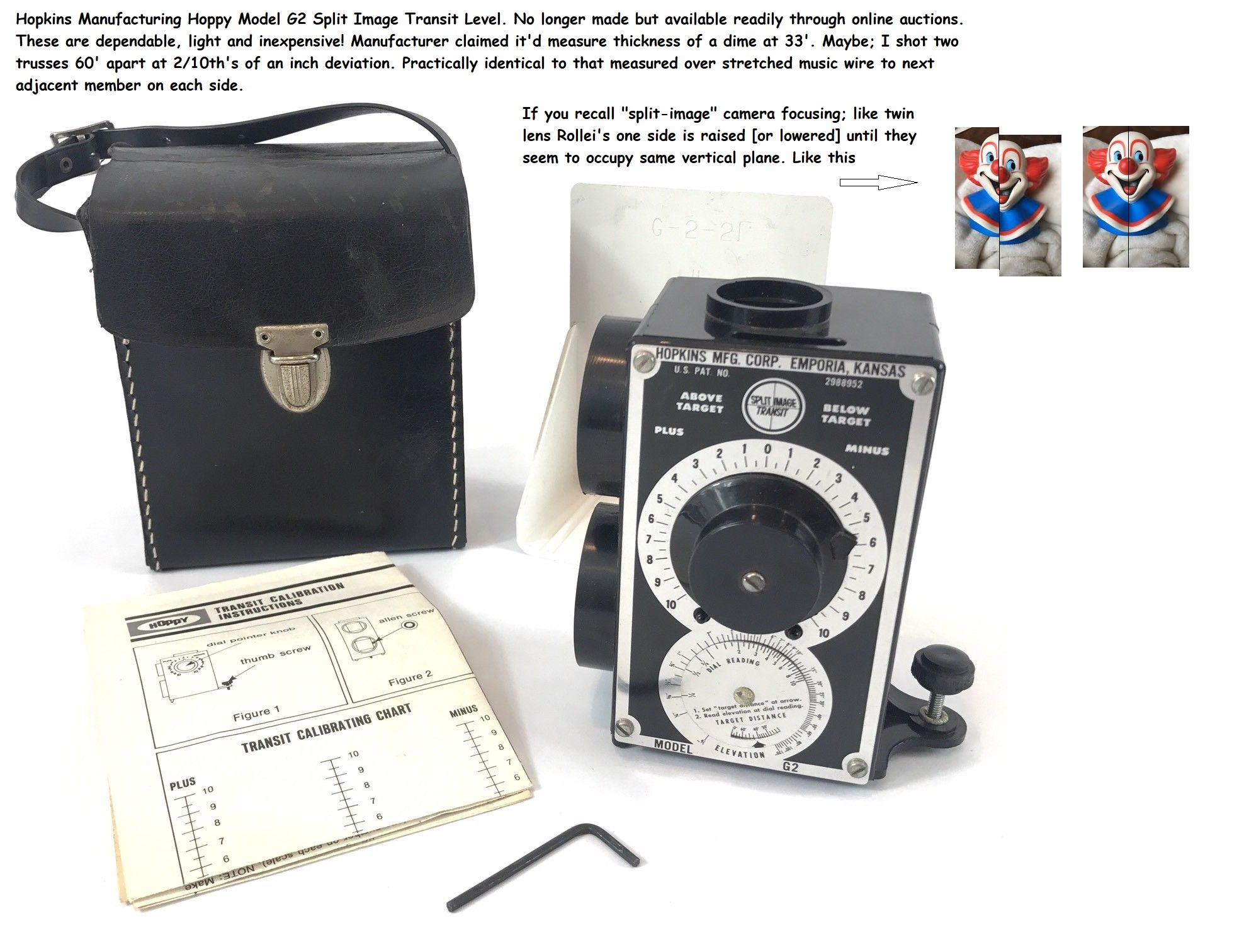

Any transit short of theodolite or collimator seems hard pressed to interpret accuracy over something short as a lathe bed, within confines of your building, and certainly at a height not comfortable for viewing. Even less so across the bed. Probably fine for initial set up, placing a stock feeder, etc.
Surveyors read over distance that will create a significant sine figure, checked to the range rod. Subsequent placements reinforce the calculations.
