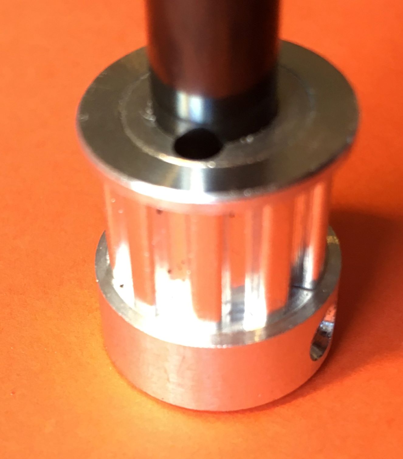

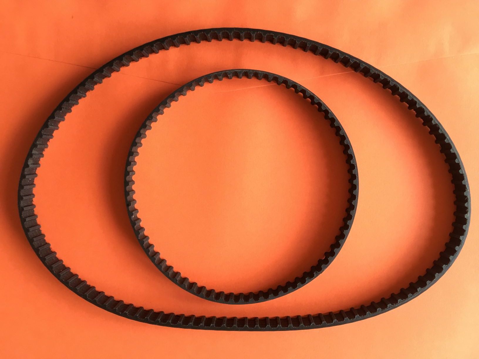

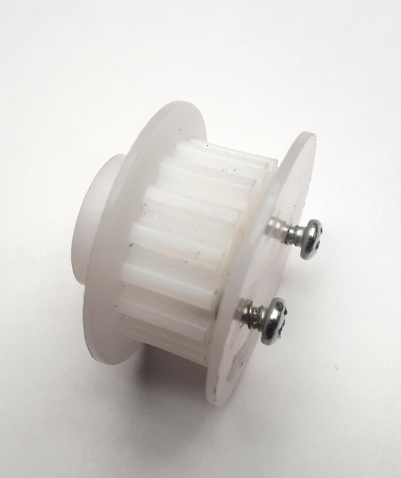

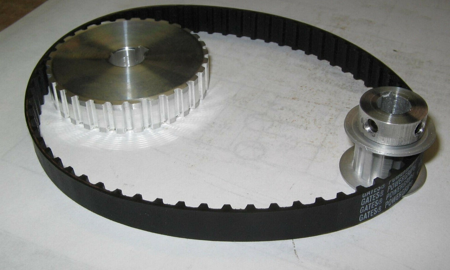

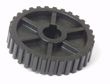

The Chinese 7" Mini Lathe variations have one common issue - non-standard motor drive belts,
which quite a few users (other than me) have found shred easily,
either the motor's plastic or the driven pulley but also the belt itself have had reported quality issues,
apart from it being relatively expensive ($ 25 + S&H), having long delivery times and are sometimes hard to find:
Attachment 38696 Attachment 38697

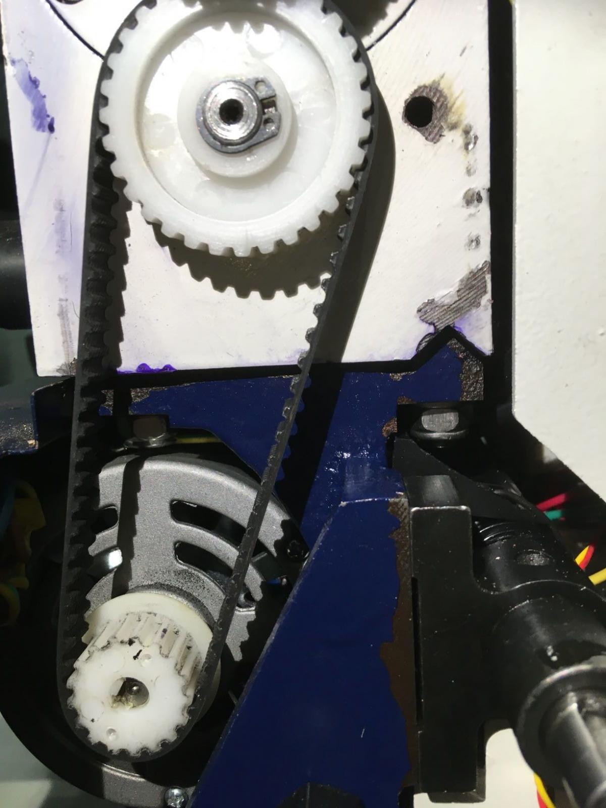

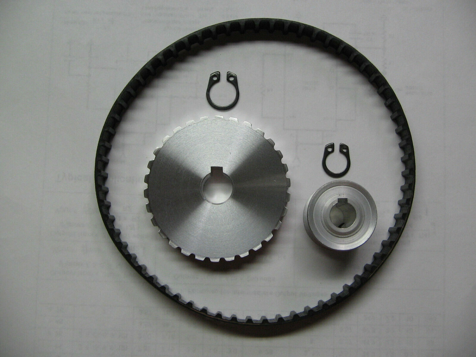

The gear ratio of the original is also sub-optimal for my taste as well:
17 and 31 teeth, giving 1:1,82 ratio and a top rev of 2500 rpm.
This, along with the low torque at low revs isn't very useful to me,
and after seeing some owners successfully installed this conversion kit, I too wanted a 3.1 reduction kit:
Attachment 38698 Attachment 38699
Readily available on FleaBay etc, there's only one down side:
The price tag: $ 120 + $ 20 S&H...

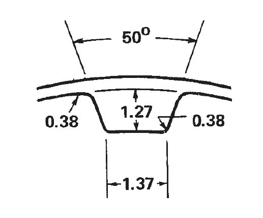

I checked quite a few small belt systems that within the lathe's small confines would give:
1) Maximum gear reduction, and thus max torque at any speed for the given motor. 1600 max rpm
2) Being a cheap, readily available and standard belt.
Though there are a couple of belt types that could stand greater force at low revs than the XL type,

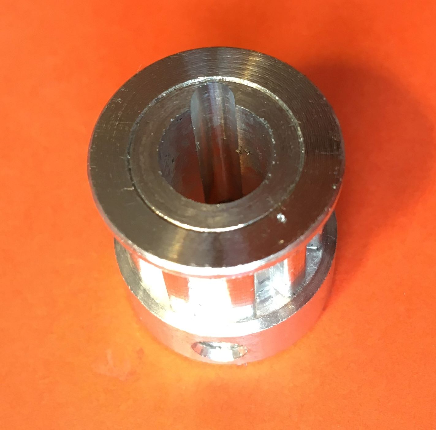

I still decided on that type as I already scored a few extra 10T aluminum pulleys (for a buck each)
when I winged this together: https://www.homemadetools.net/forum/...14-lathe-82652
And when 3 belts of just the right length (210 XL 037) was ordered and delivered at 2 bucks apiece,
I felt I was on the home stretch - just source a Delrin 30T 10 mm wide pulley and smack it in.
Well, this wouldn't fit neither the forum nor the title above - and though readily available just about everywhere,
they were still too un-cheap for my taste, so I thought of "just winging one together"... (Famous last words!)

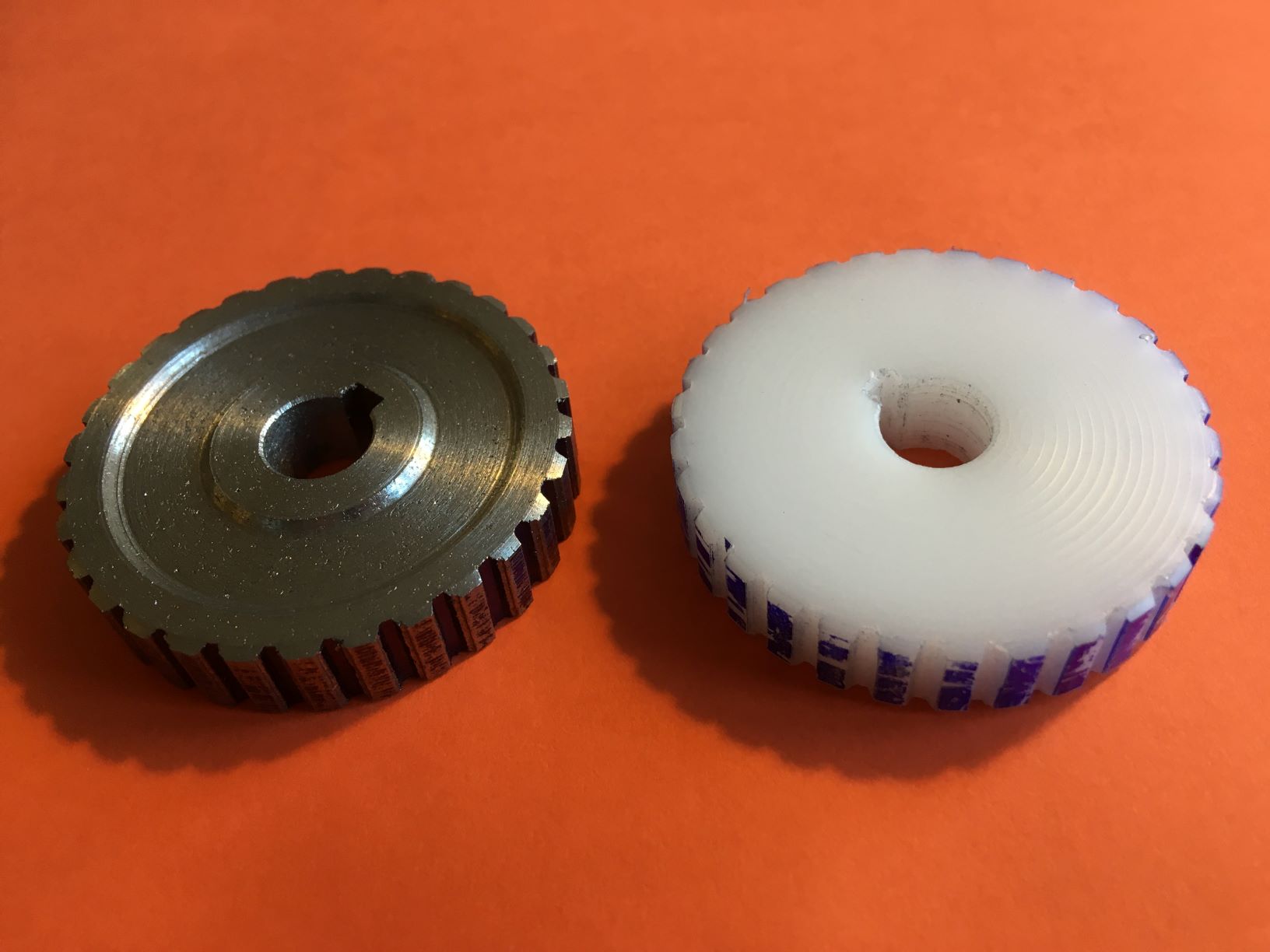

This is where the fun starts: Milling a 30 tooth XL pulley in the aforementioned 7 x 14" mini lathe:
Having found some 17 kg of 1/2 & 3/4" Delrin offcuts and finding that the OD of the pulley should be 48 mm,
cut a 50 mm square piece of 1/2" thick Delrin to fit. Also having plenty of cast iron waste around,
I thought I'd make a spare if the plastic gear wouldn't stand up to my intended use.

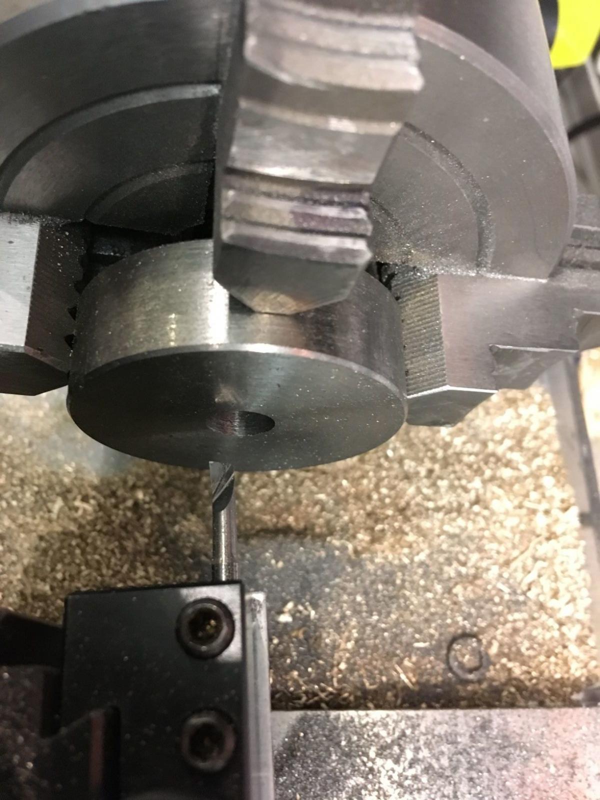

Attachment 38681

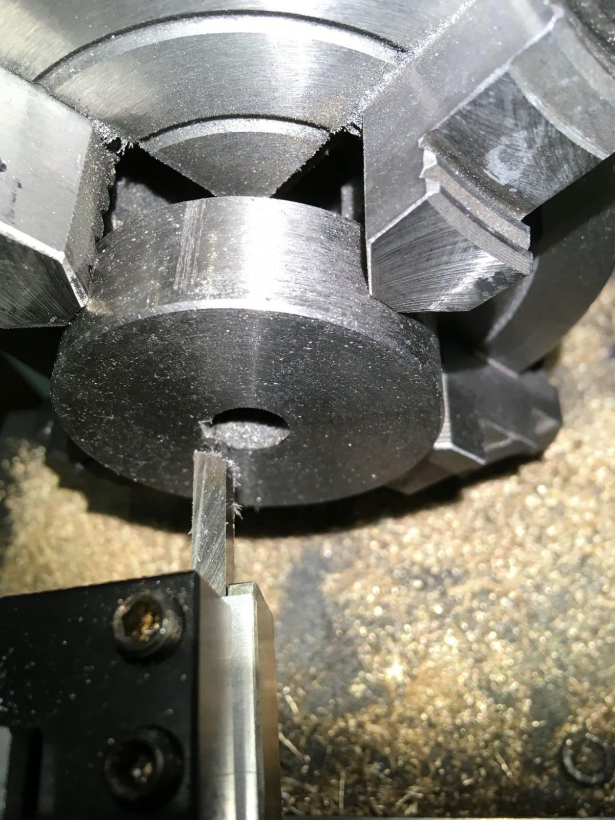

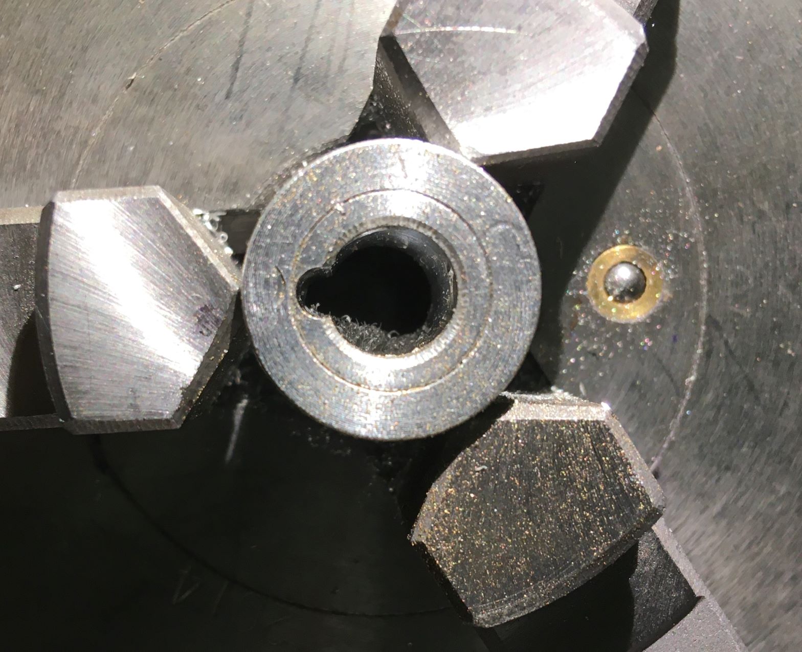

Turning, drilling and boring the two piece's holes 10 mm was simple, then broaching a 4 mm keyway in the plastic was quick ,
but somewhat tedious with the CI, giving me a blister from the monotonous handwheel feeding:
Attachment 38682 Attachment 38683

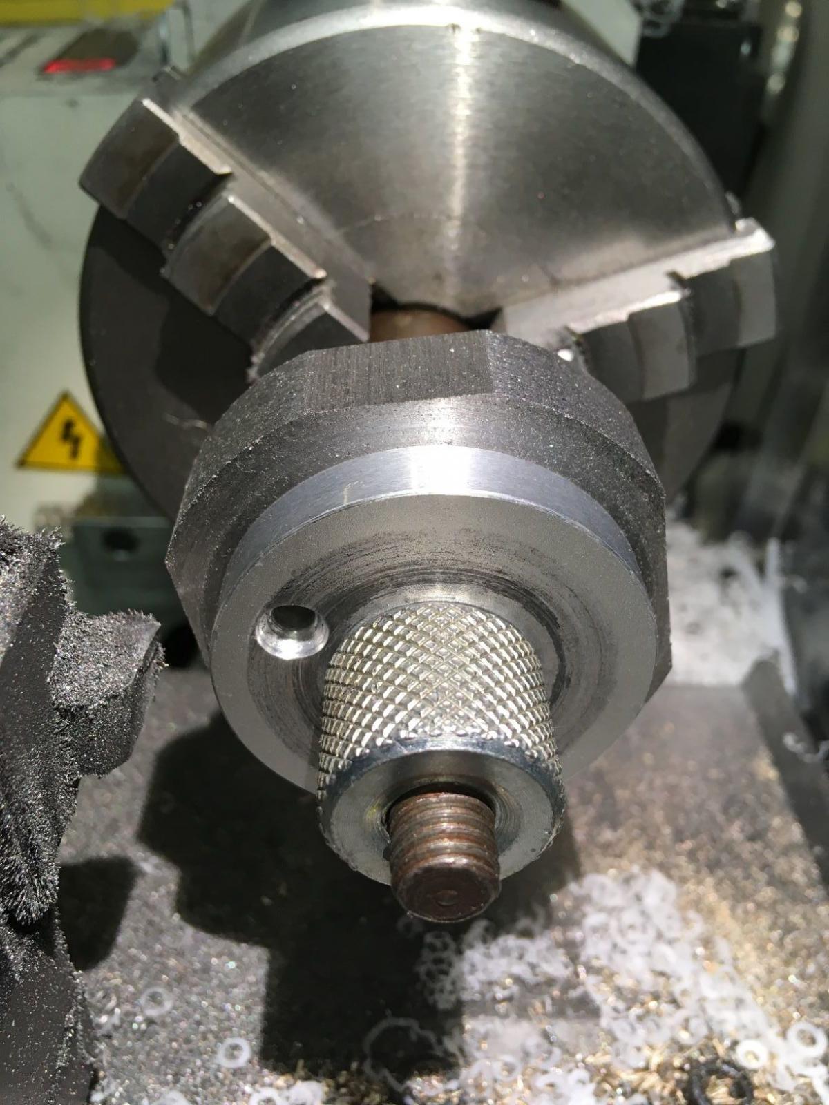

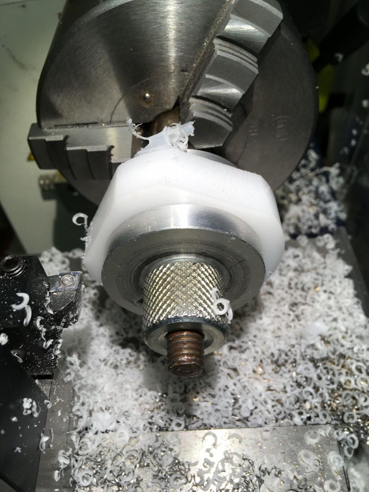

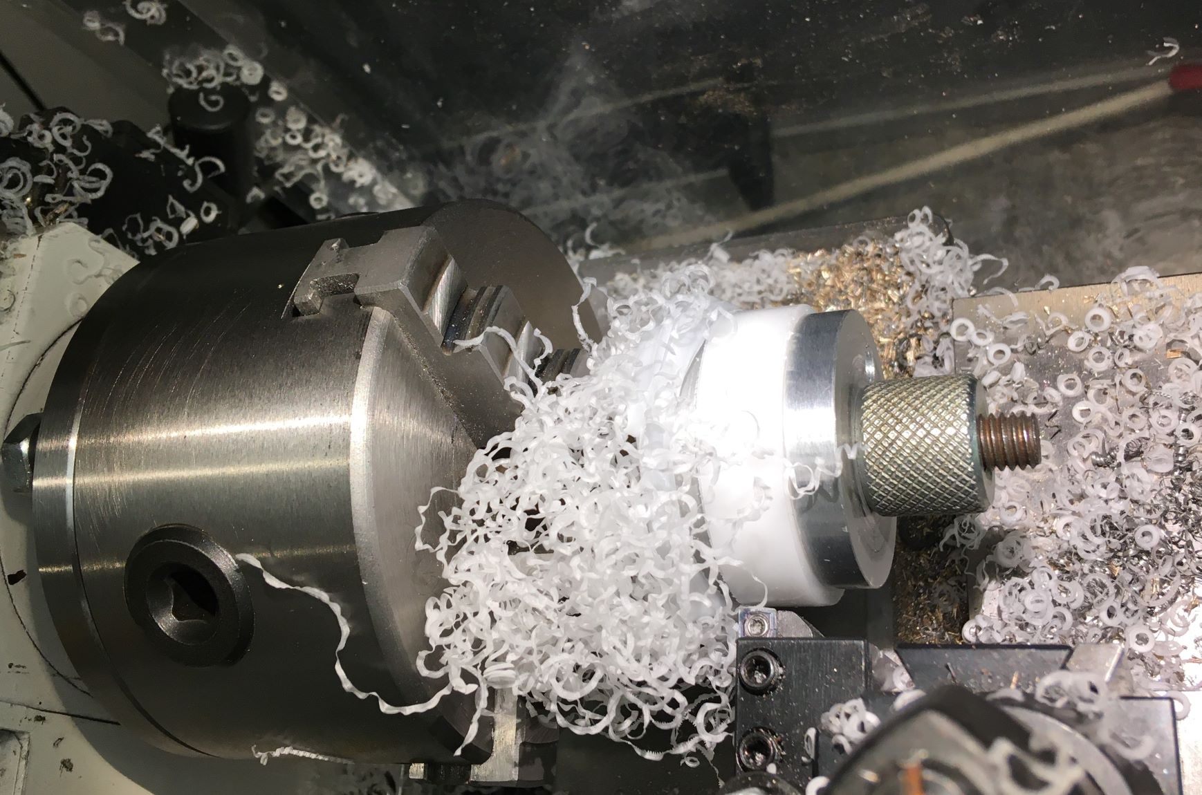

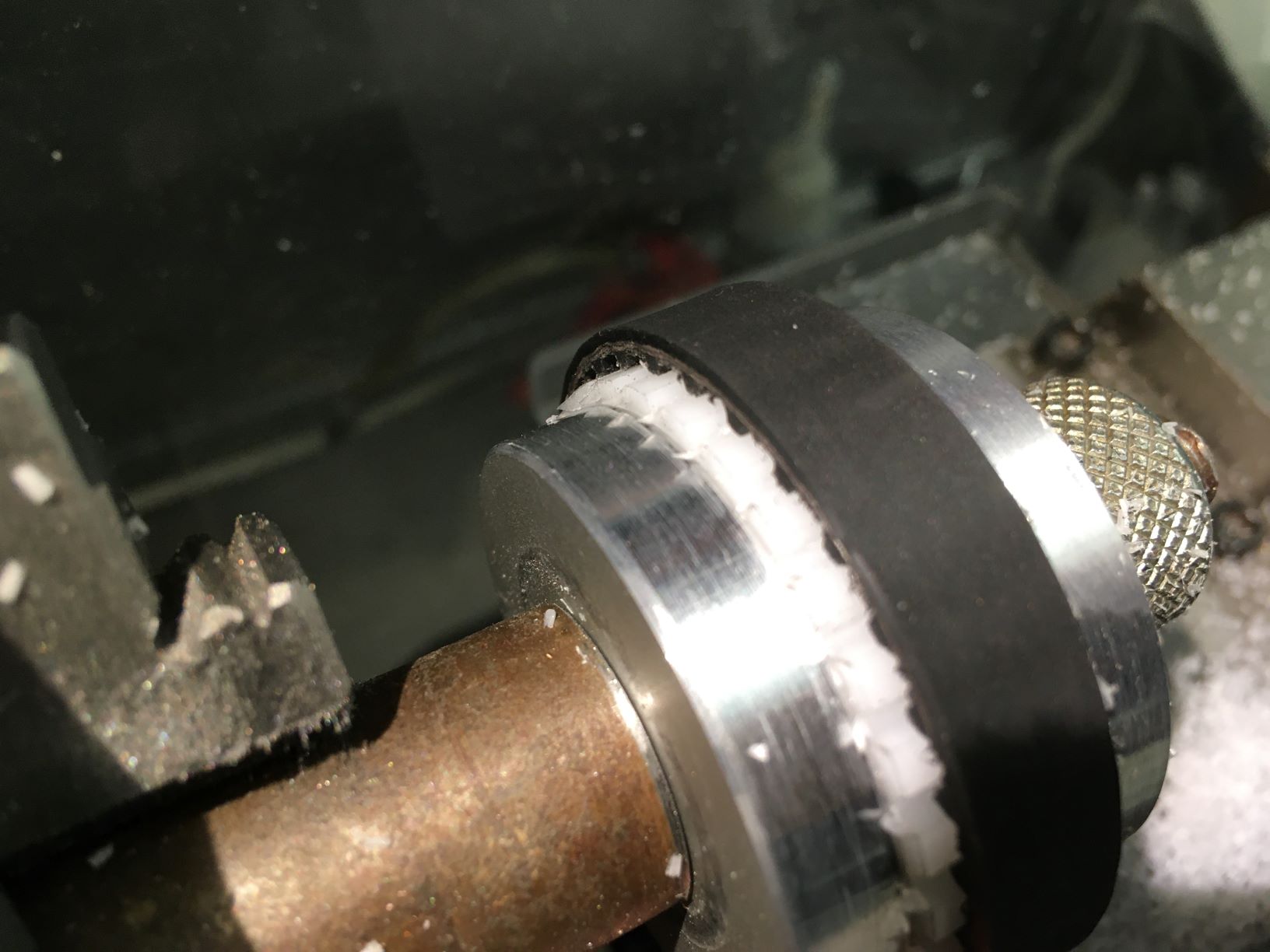

I turned a 10 mm mandrel and fit the Delrin: easy, clean turning but with helluva swarf,
where cast iron is fine and dirty, as usual:
Attachment 38684 Attachment 38686 Attachment 38687 Attachment 38688

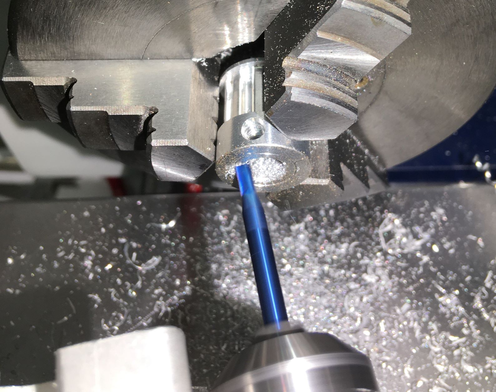

Using my TPMDGM I figured I'd need to turn, grind, harden (no tempering) and lap a piece of 4 mm drill rod D-Bit to suit this:
Attachment 38689

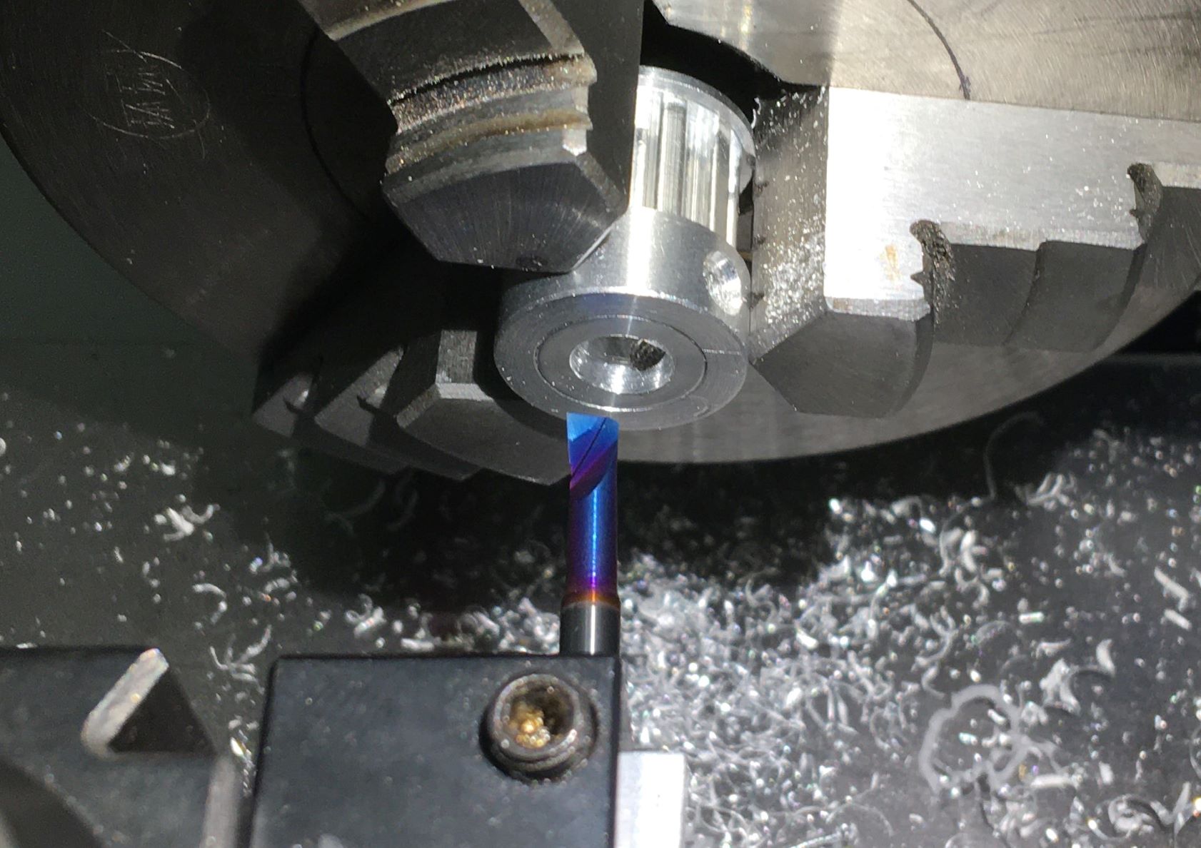

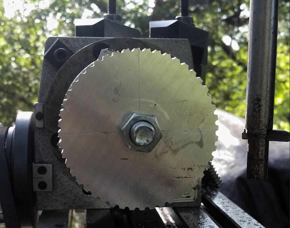

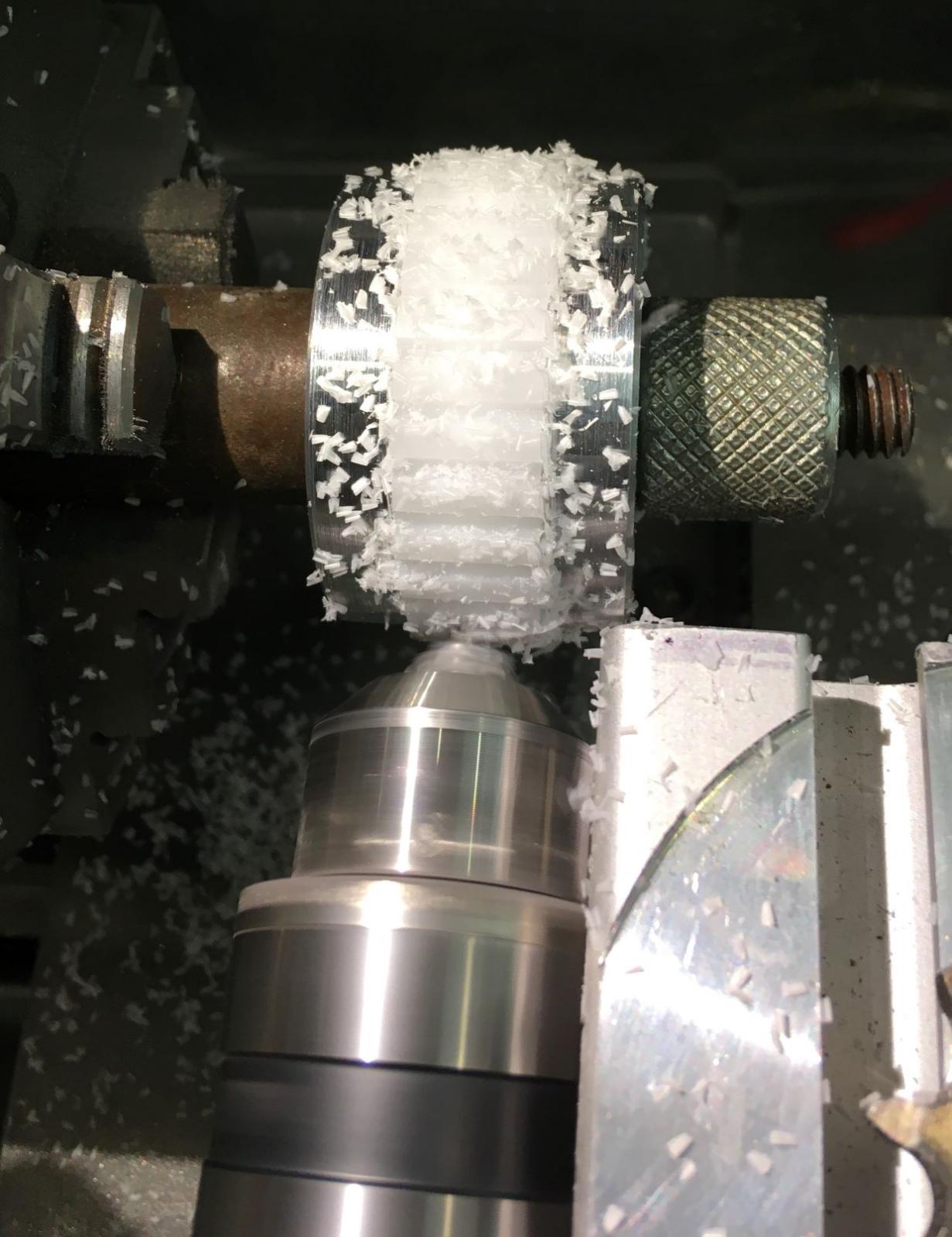

-Here we go - everything fitted, trued, and indicated for 50 thou DOC, using the https://www.homemadetools.net/forum/...057#post176196
to achieve the intended 30 tooth division:

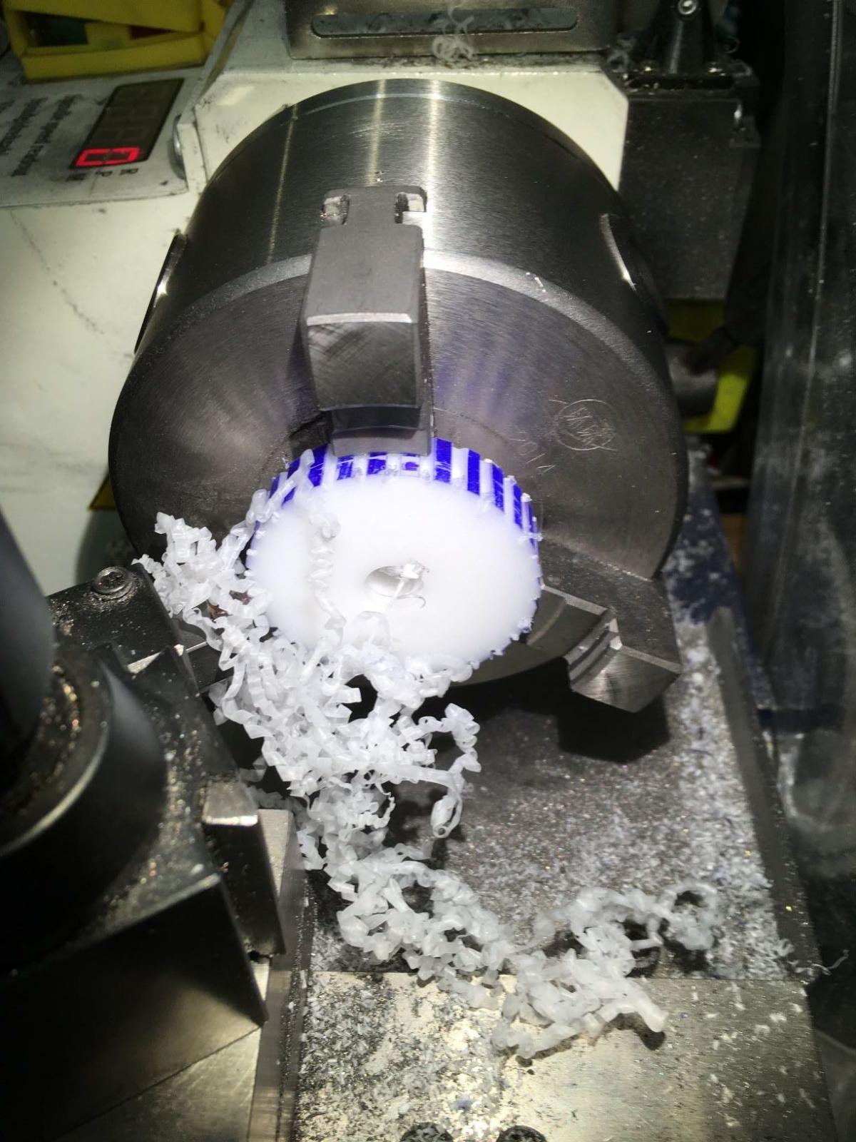

Attachment 38690 Attachment 38691
Plastic went just fine in one to & fro pass by the electric lead screw at 30 mm/min and 2 k rpm,
while the cast iron needed an extra spring pass to get down to shape.
Could run the mill wide open for about 5 minutes before having to let it cool down,
as the ex-furniture motor only has a 20% duty factor...

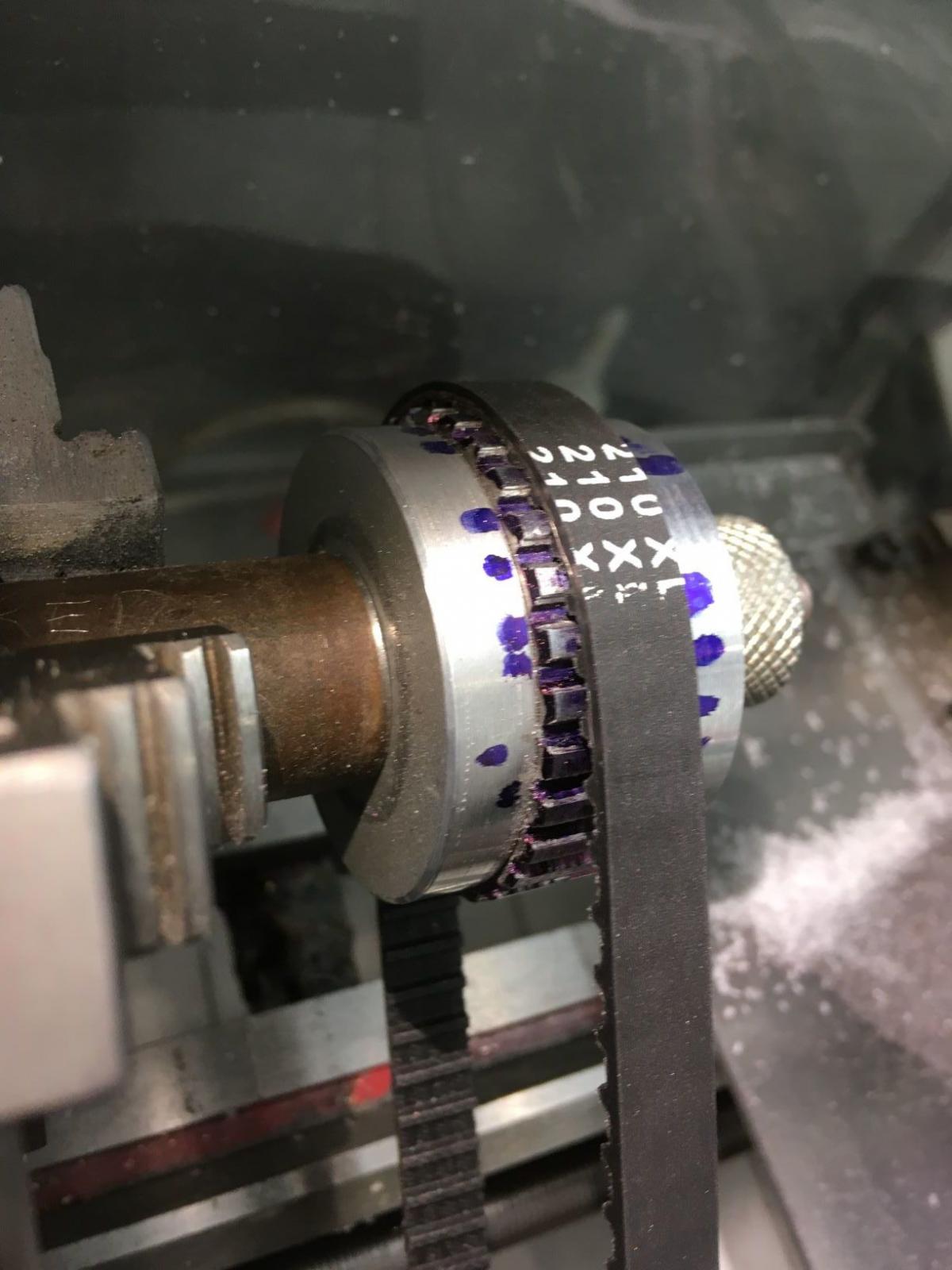

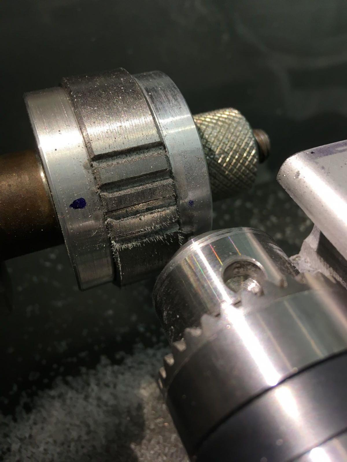

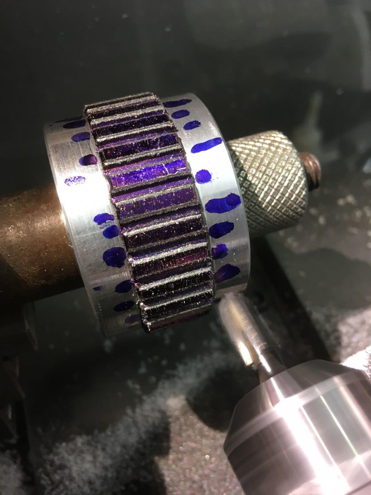

Belt test fit showed that the rounding of the crests really was necessary, so I chucked a 1/4" ball endmill,
and gave them both a slight kiss to achieve a nice fit:
Attachment 38692 Attachment 38693 Attachment 38694

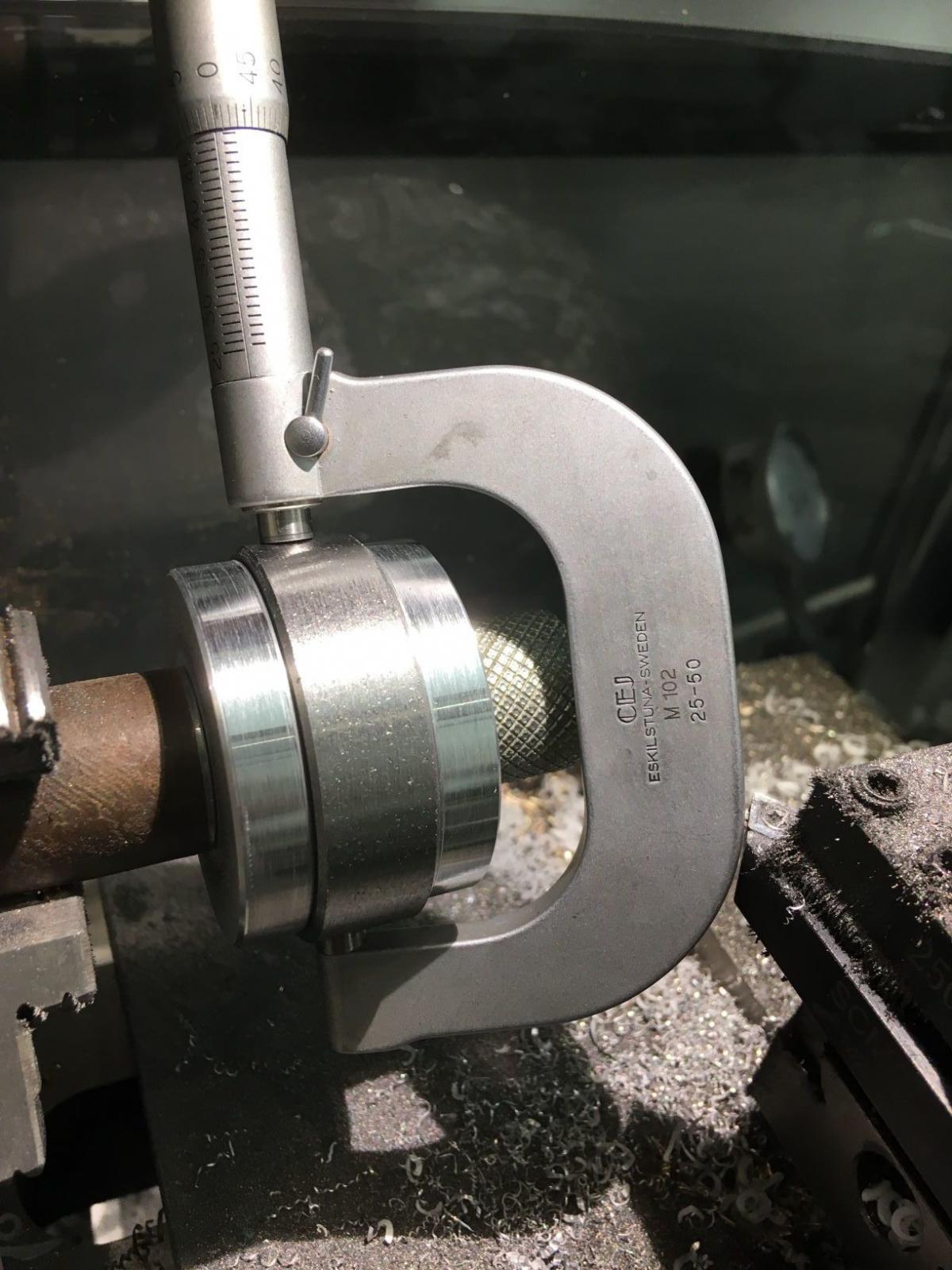

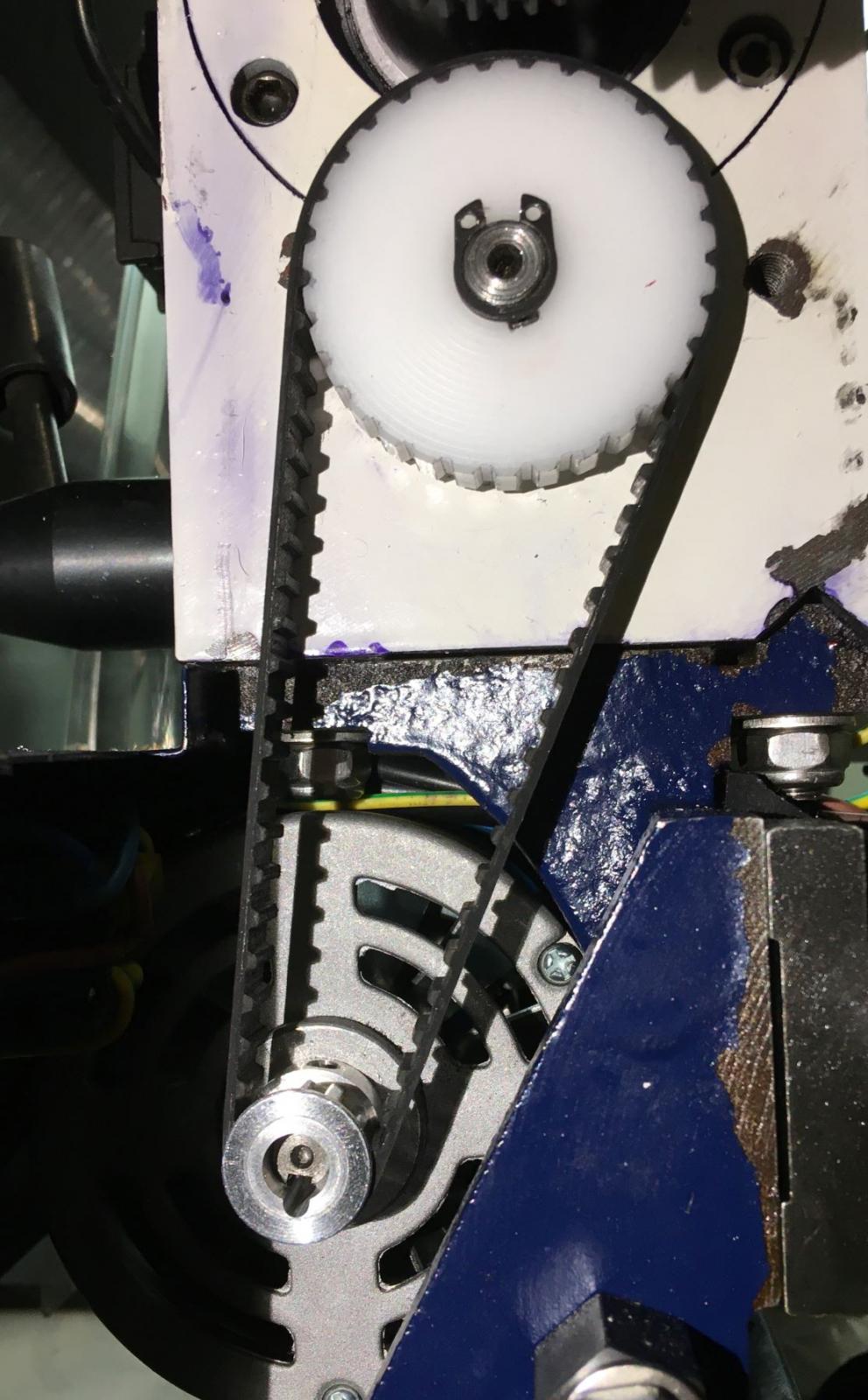

Then finally only a facing down to 10 mm thickness was needed- taking off 50 thou on each side and finish off to fit:
Attachment 38685 Attachment 38695
Thanks for following me this far, questions welcome!
Fitting and adjustments in the lathe will commence tomorrow...
