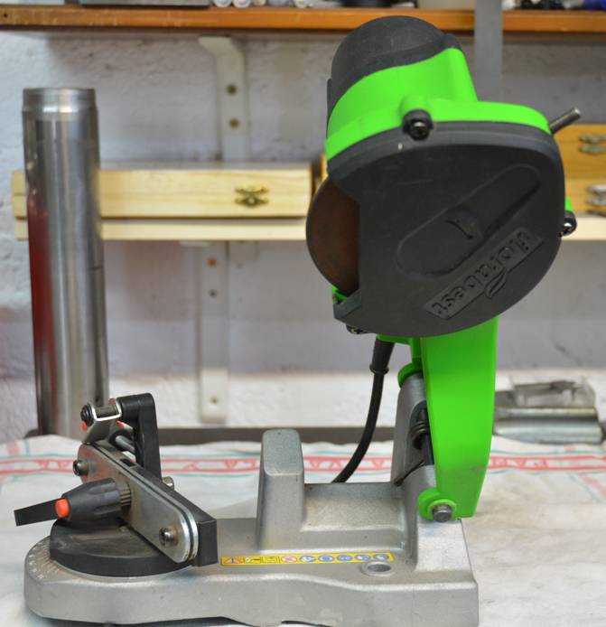

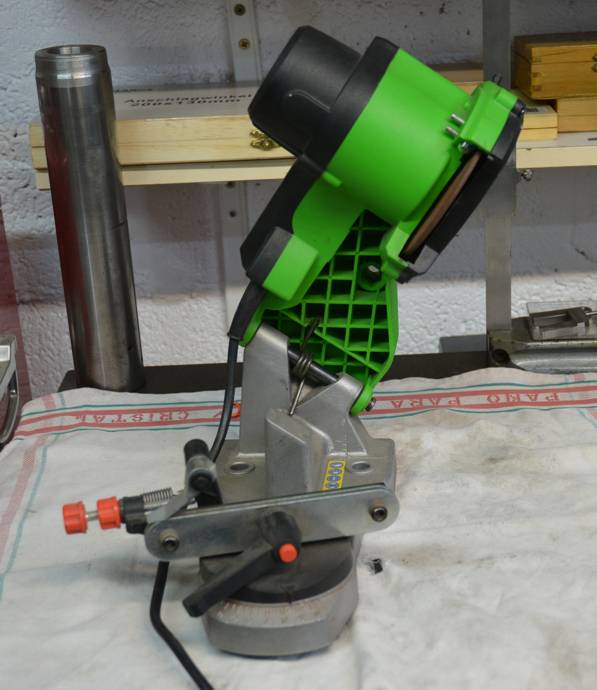

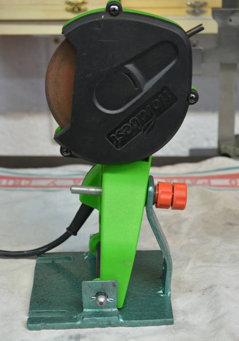

I had a little grinder designed for sharpening chainsaws which I used sometimes for web thinning but the blade was at an angle and was movable, this made it less than ideal for drill bit work. This is pictured below.
Attachment 27549 Attachment 27550 Click thumbnails for full size images.

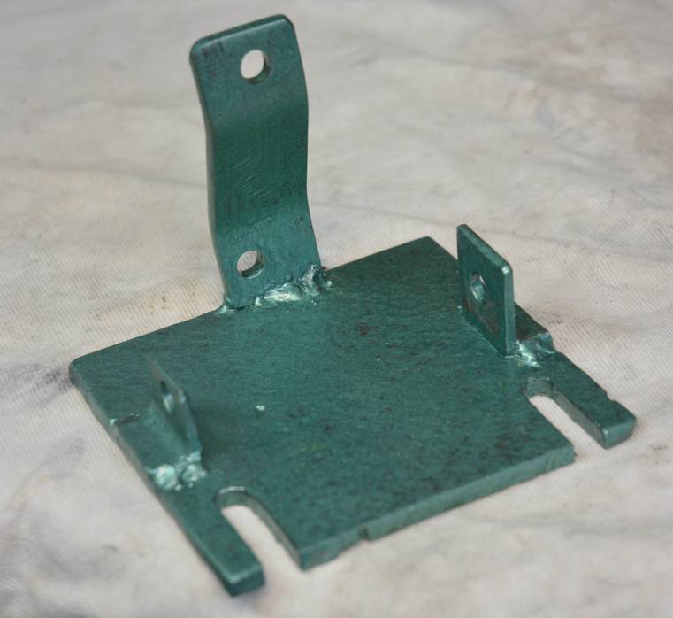

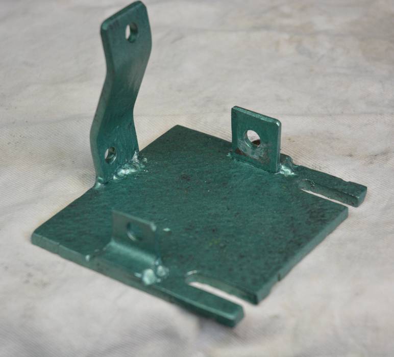

To improve its utility I made this simple holding support from some bits out of the scrap bin.
Attachment 27551 Attachment 27552

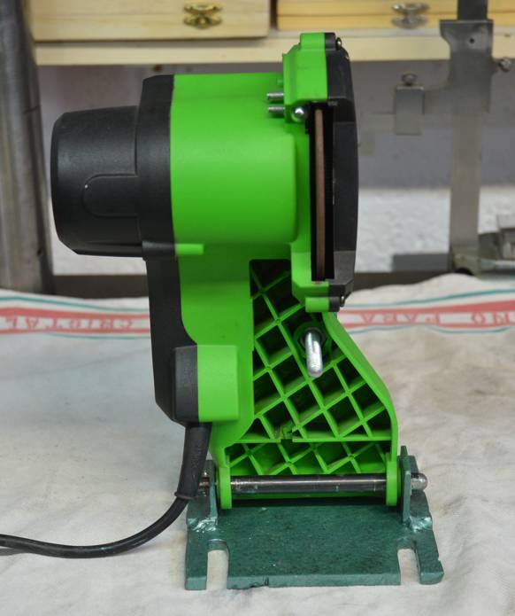

The next pix show the grinder mounted on the support. It is now very convenient to use.
Attachment 27553 Attachment 27554

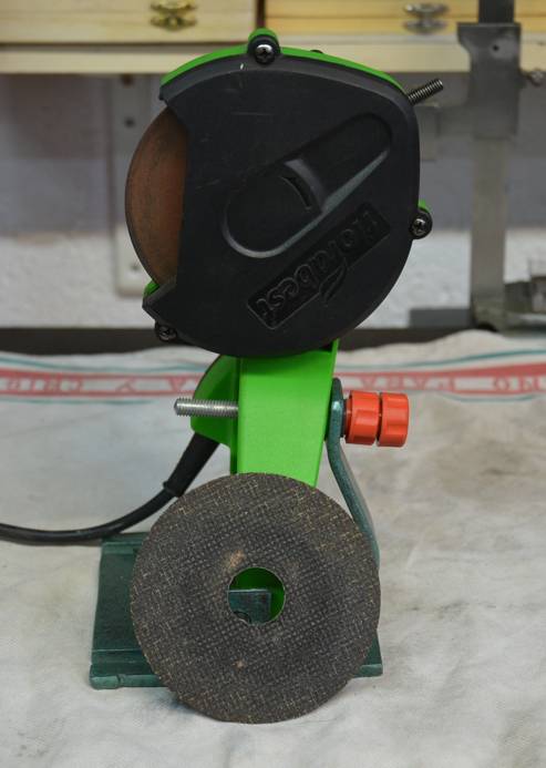

The wheel that came with the grinder is 3 mm wide which is fine for larger bits but too thick for smaller ones. Fortunately the hole diameter in 1 mm angle grinder cutoff blades is the same and so I change over to those for smaller bits.
Attachment 27555
Showing a 3 mm blade mounted with a 1 mm cutoff blade below.
