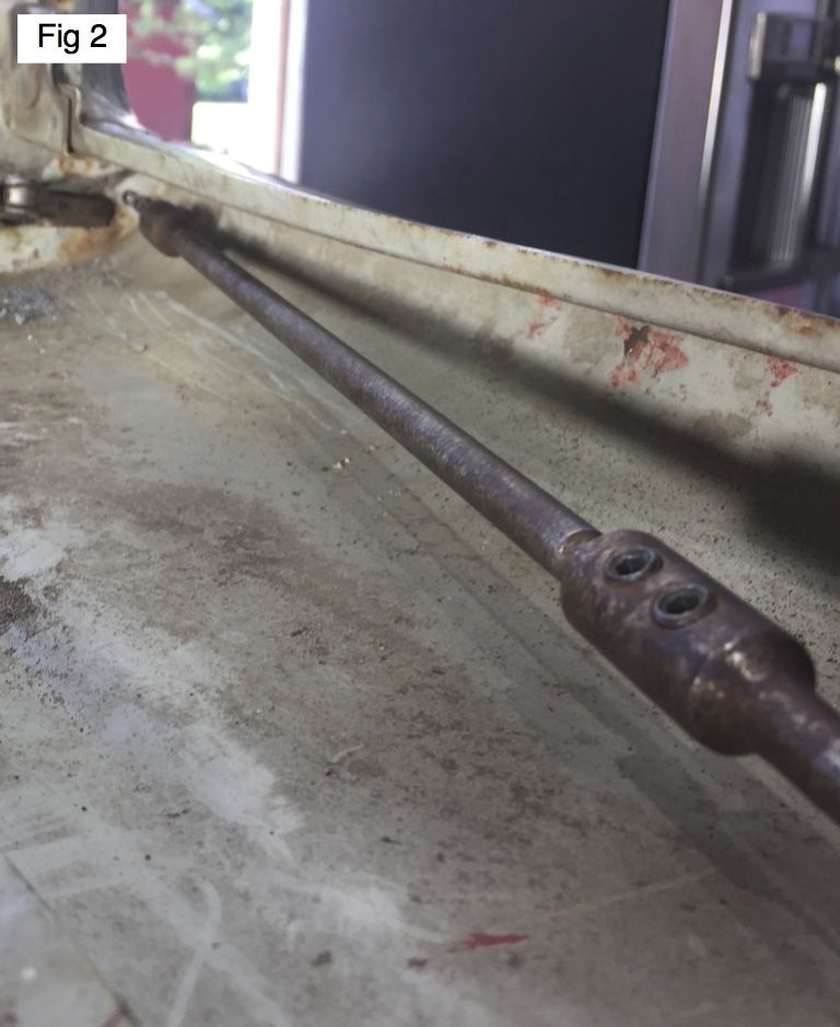

Fig 2 shows the tight space I needed to work in. It took two extensions to get the drill in to a good spot
Attachment 46014

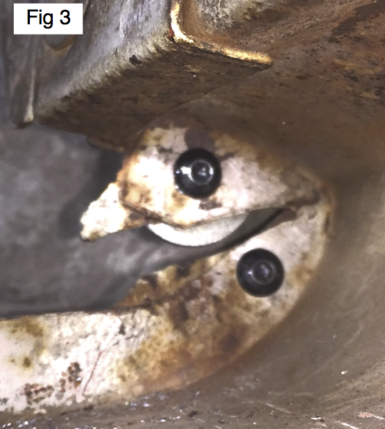

In Fig 3 the screws are installed. I discovered after drilling the first hole, my old hand was not able to get into that space to put the screws in or to work a wrench.
Attachment 46015

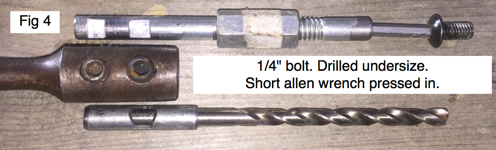

The adapter I made to hold the screws for installation, is shown in fig 4, along with the drill and adapter bushing
Attachment 46016
