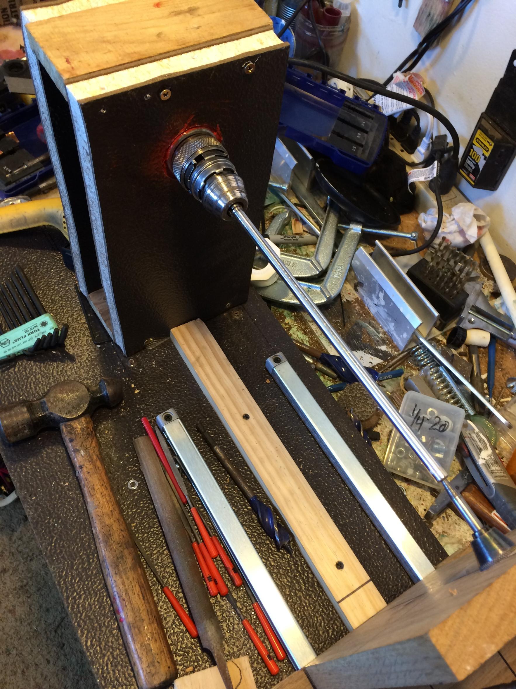

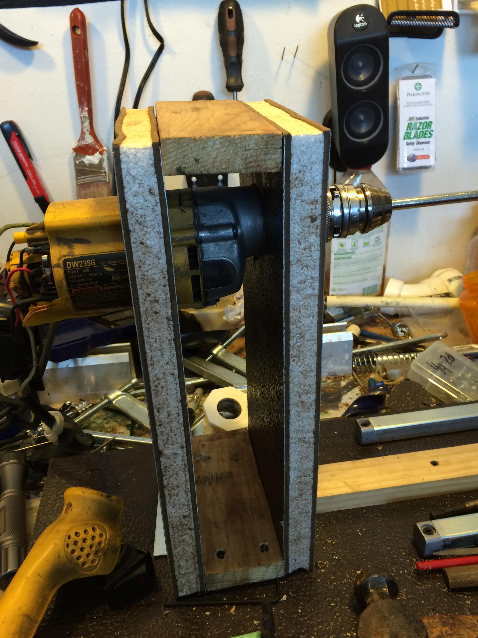

So the main motor is an old DeWalt DW235G 7.8A 120V heavy duty corded drill. It works well, but the chuck is on its last legs. I managed to get the infamous chuck screw out. It had backed out in true DeWalt key-less chuck fashion. As soon as I figure out how to get it off the drill, it will be replaced, I assure you.
I hacked the hand grip off, but preserved the reversible, locking trigger assembly for now. I have a 1000W, 16A, 120 volt dimmer switch that is being re-purposed as a basic speed controller.
Attachment 8102

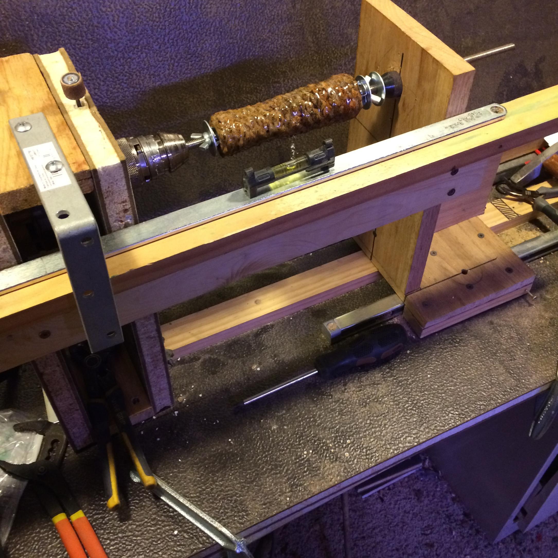

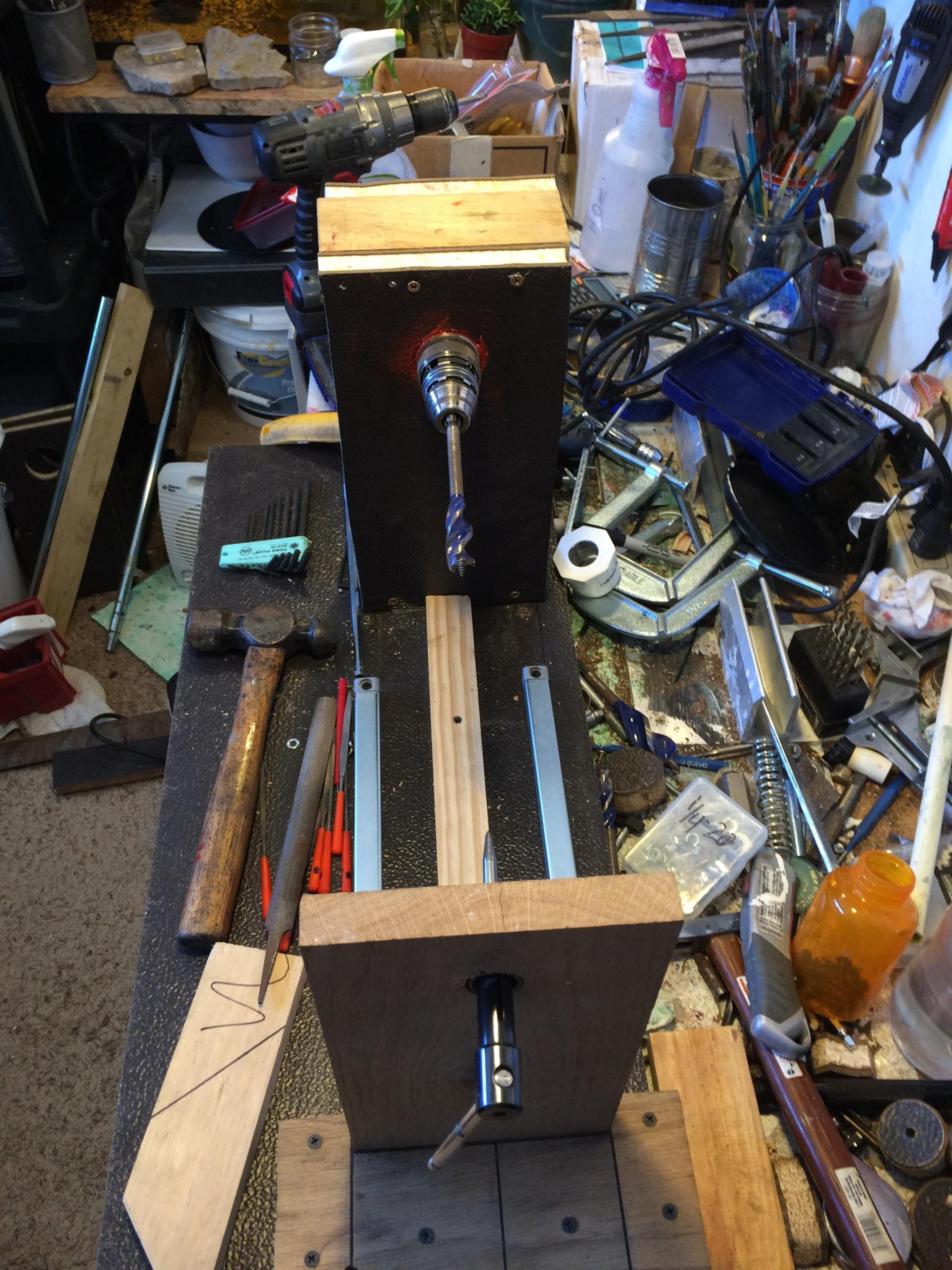

The Headstock obviously needs more work, but for now it is functional. I will likely redo it in 3/4 inch oak I have laying around, but lacking a table saw and drill press...baby steps... I also have some angle braces to install, but frankly my hands are pretty torn up right now so I plan to take a break for a few days.
Attachment 8103

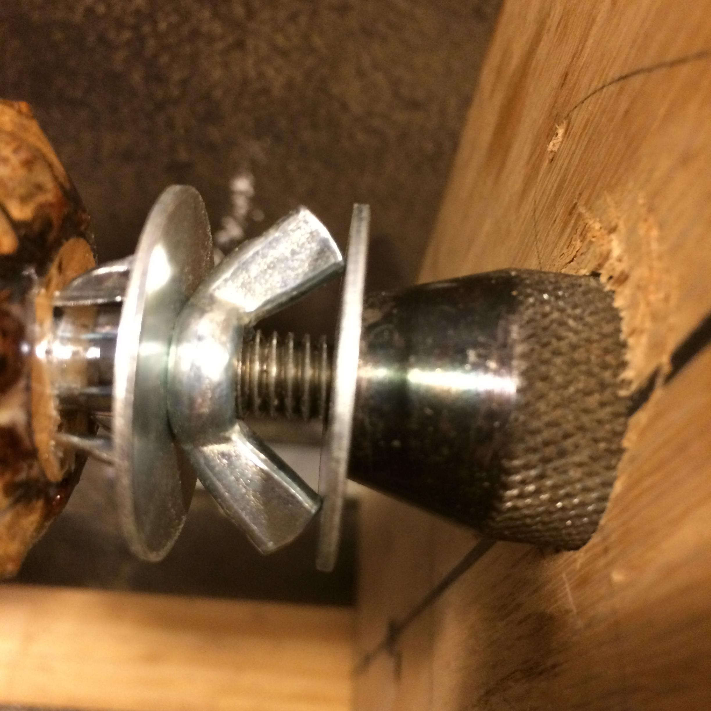

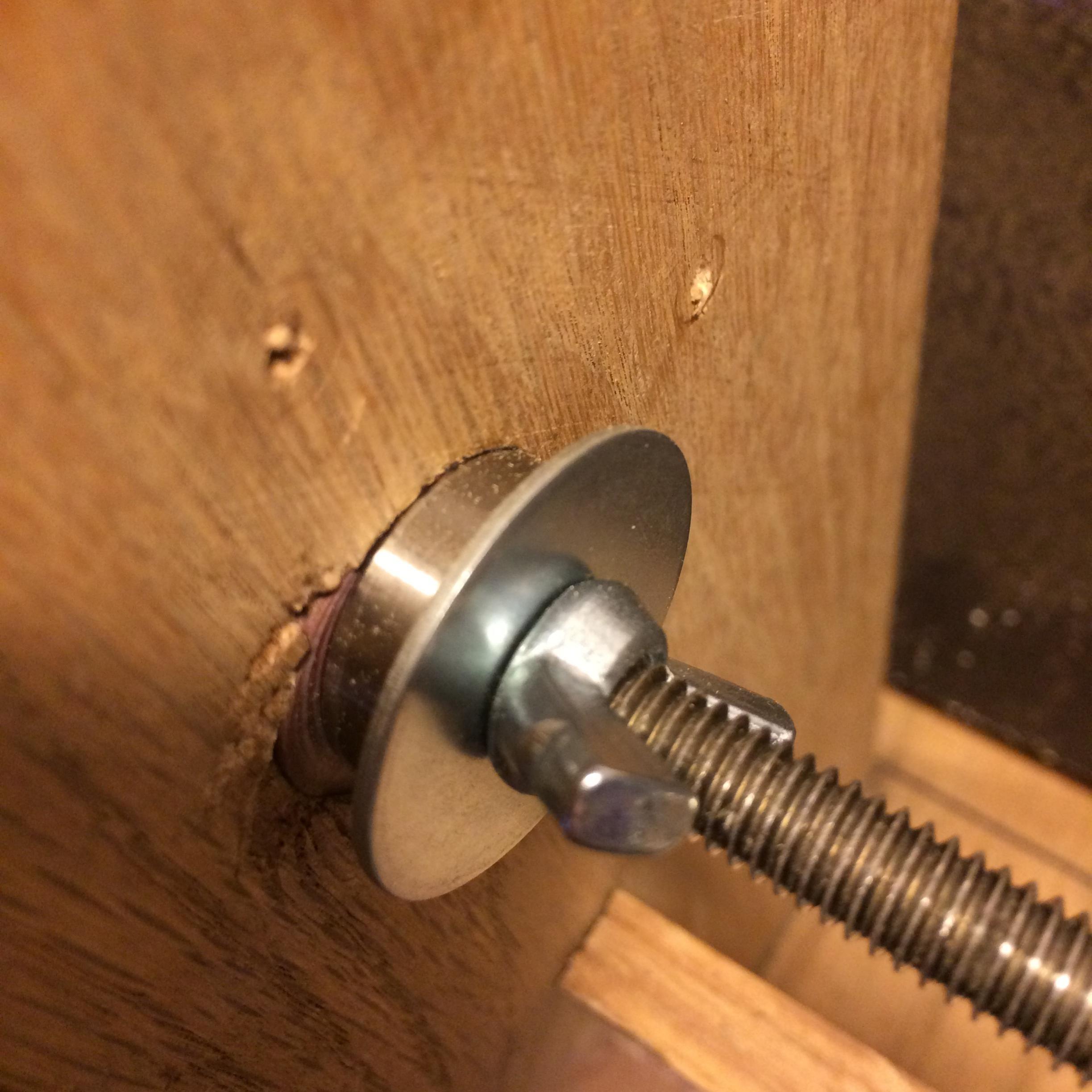

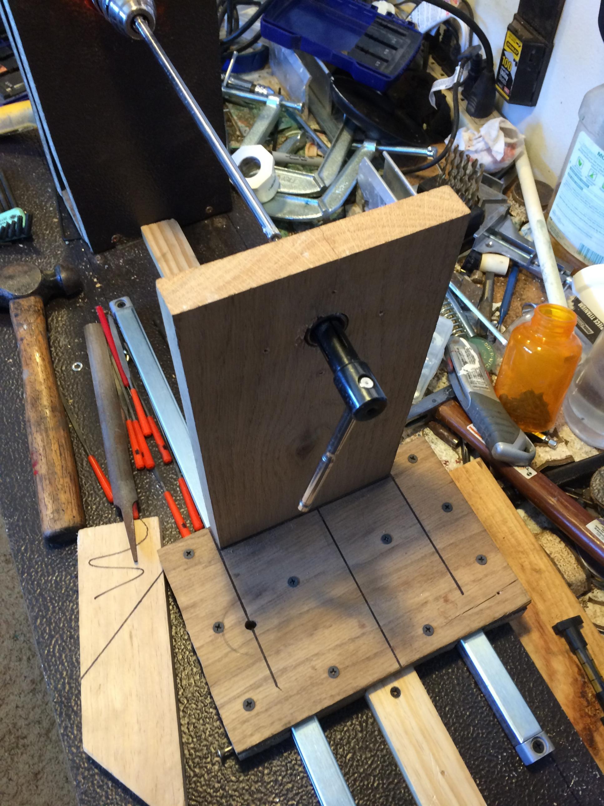

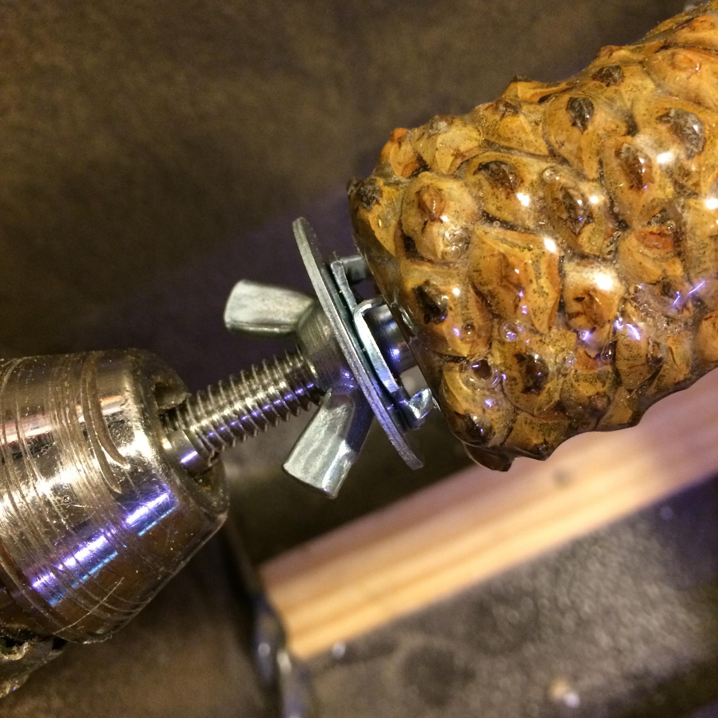

The current tail stock is some scrap oak and a 1/2 tap handle with the point out of a spring loaded center punch, for now. The slide rails are door restrictors I got from my office, after maintenance removed them and was going to trash them! They work great.
Attachment 8104
It took a while to get things level and center headstock to tail stock, but finally I got it squared up. Right now it has a max of 12 inches, but I haven't built a chuck or a spur yet. I plan to make the chuck body using the lathe...

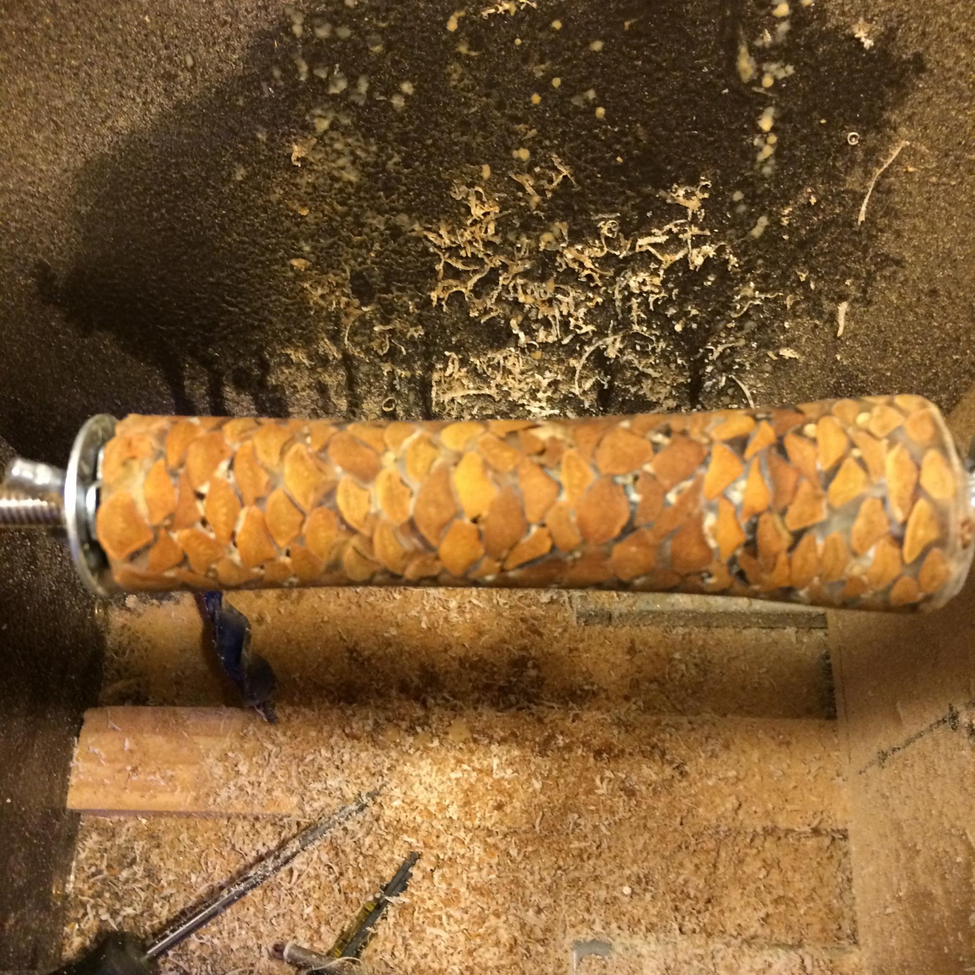

I did some initial testing, but I haven't any turning tools. Since I don't own a bench grinder, that may take a bit of time to get moving
It isn't much, but I only plan on using it to turn fly fishing rod handles, and perhaps even pen bodies. I have to put together a tool rest, which I have a skateboard truck set aside for. I also have an M12 SS threaded rod here, so once I get some nuts for it, I have a pipe clamp that is going to get modded into a crank for the tailstock and tool holder.
