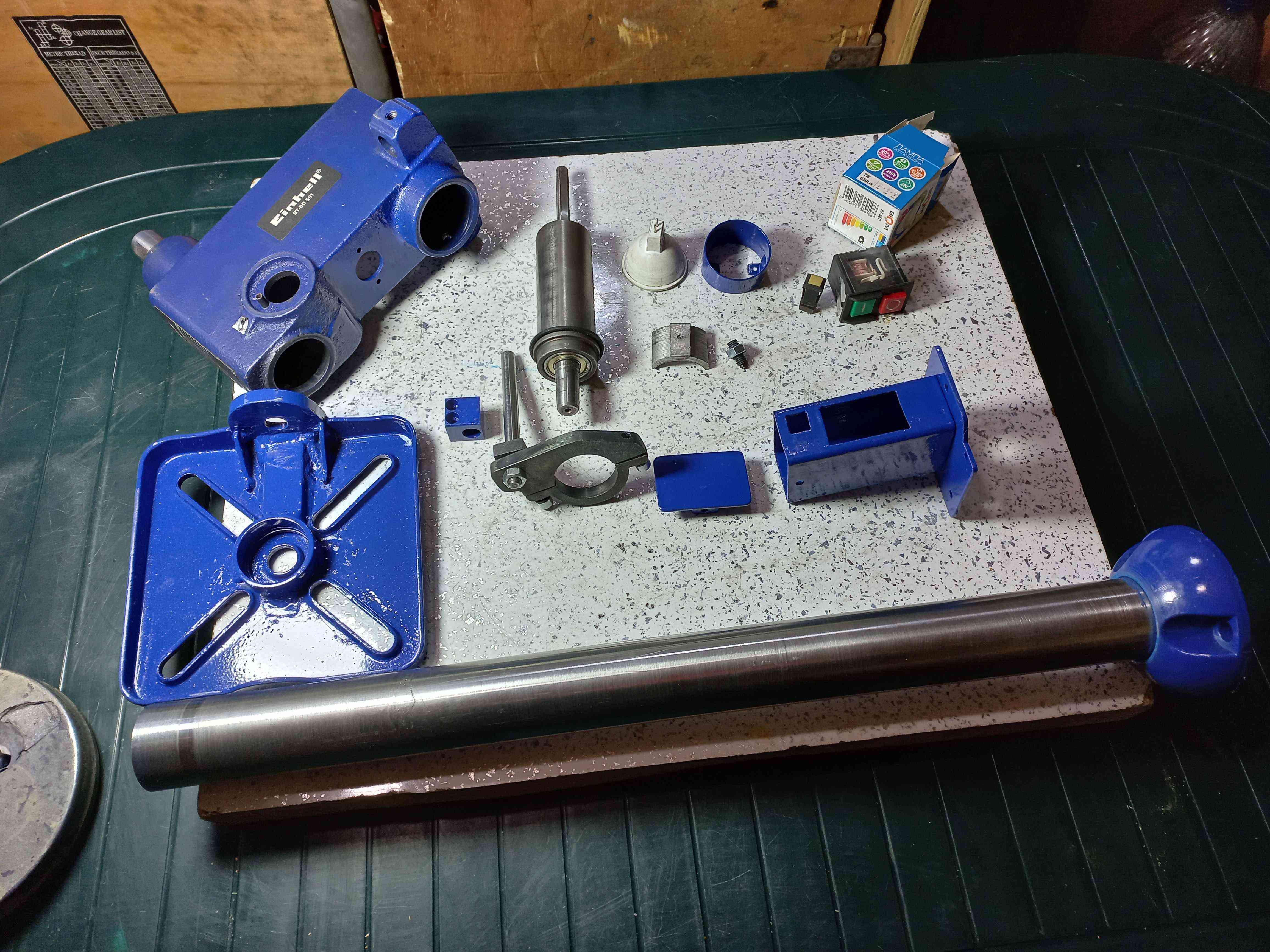

Drilling machine modification.
Attachment 41690Attachment 41690
Attachment 41691
Attachment 41692Attachment 41693

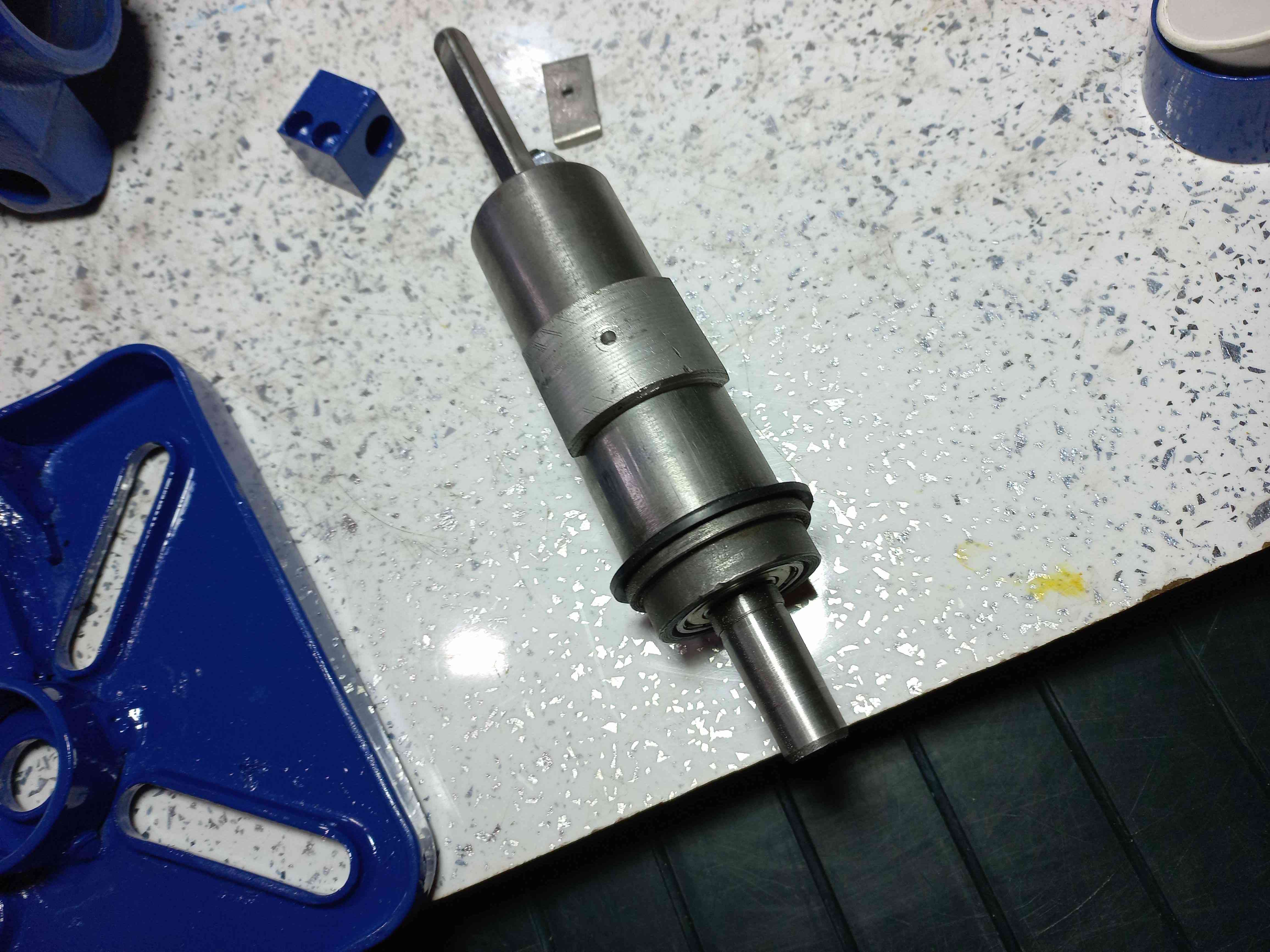

Now I will show a photo of the machine closer in detail.
Attachment 41694Attachment 41694
Attachment 41695

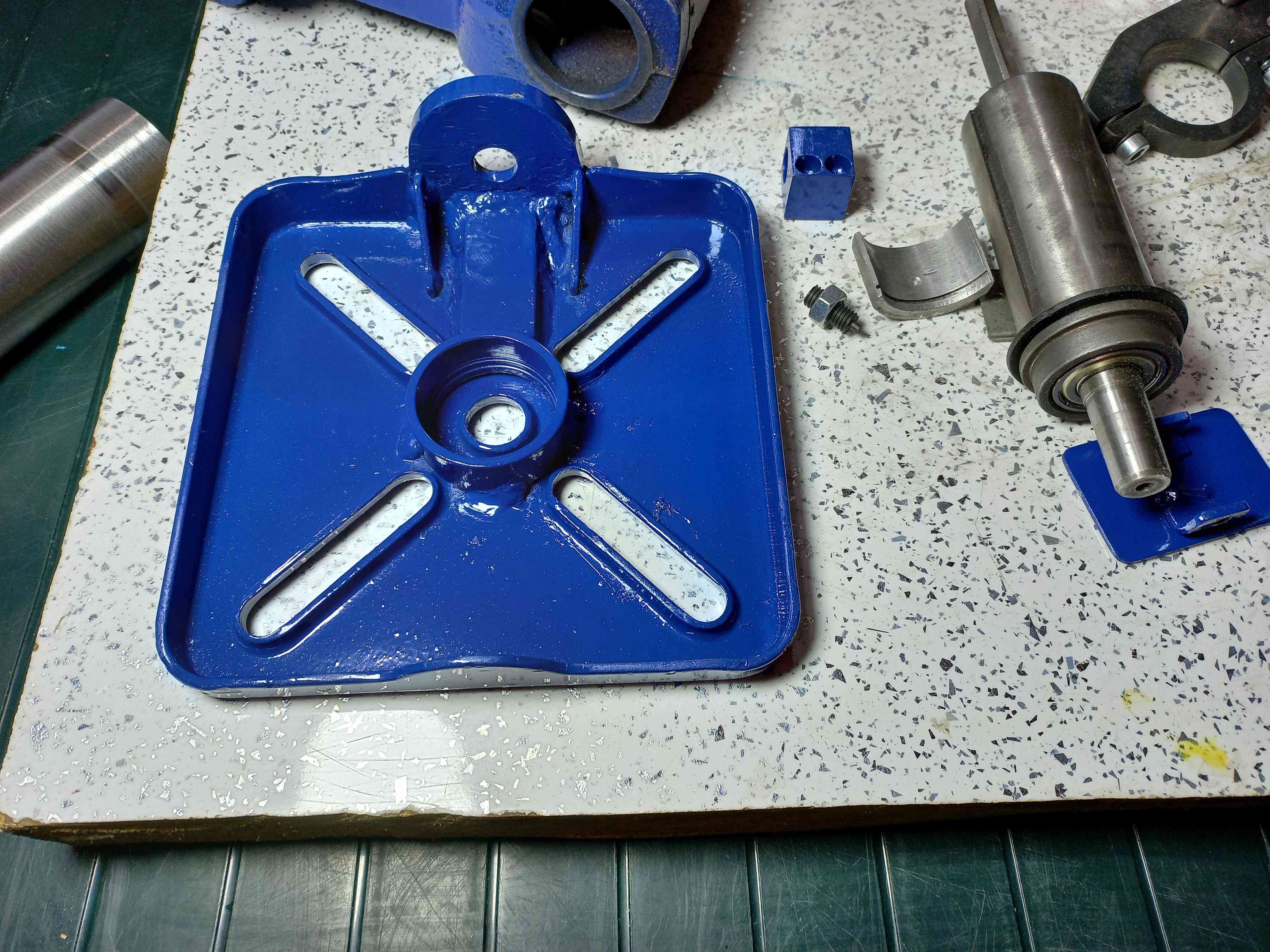

Other photos.
Attachment 41703Attachment 41704

Some well thought out mods there. Love the light but have to ask if you get shadows? I tried one light source but found that two in different planes were needed.
That depth stop looks like a real time saver.

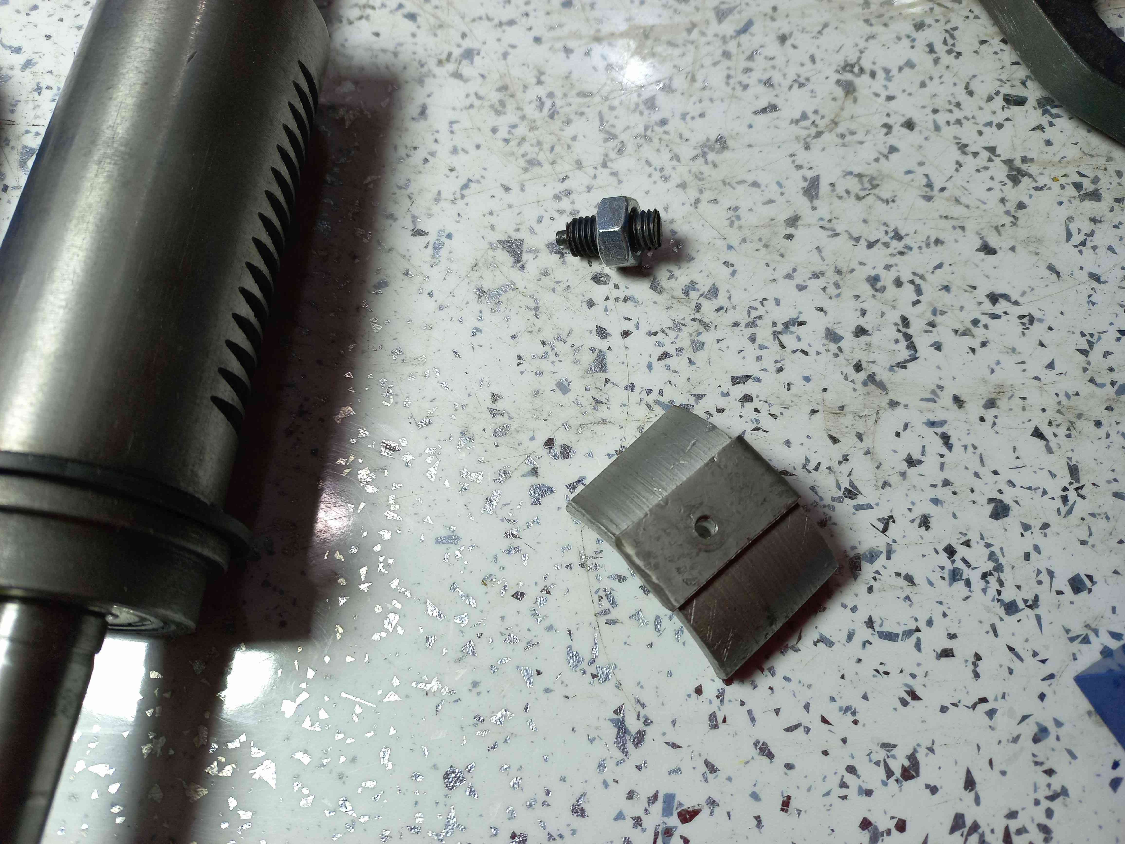

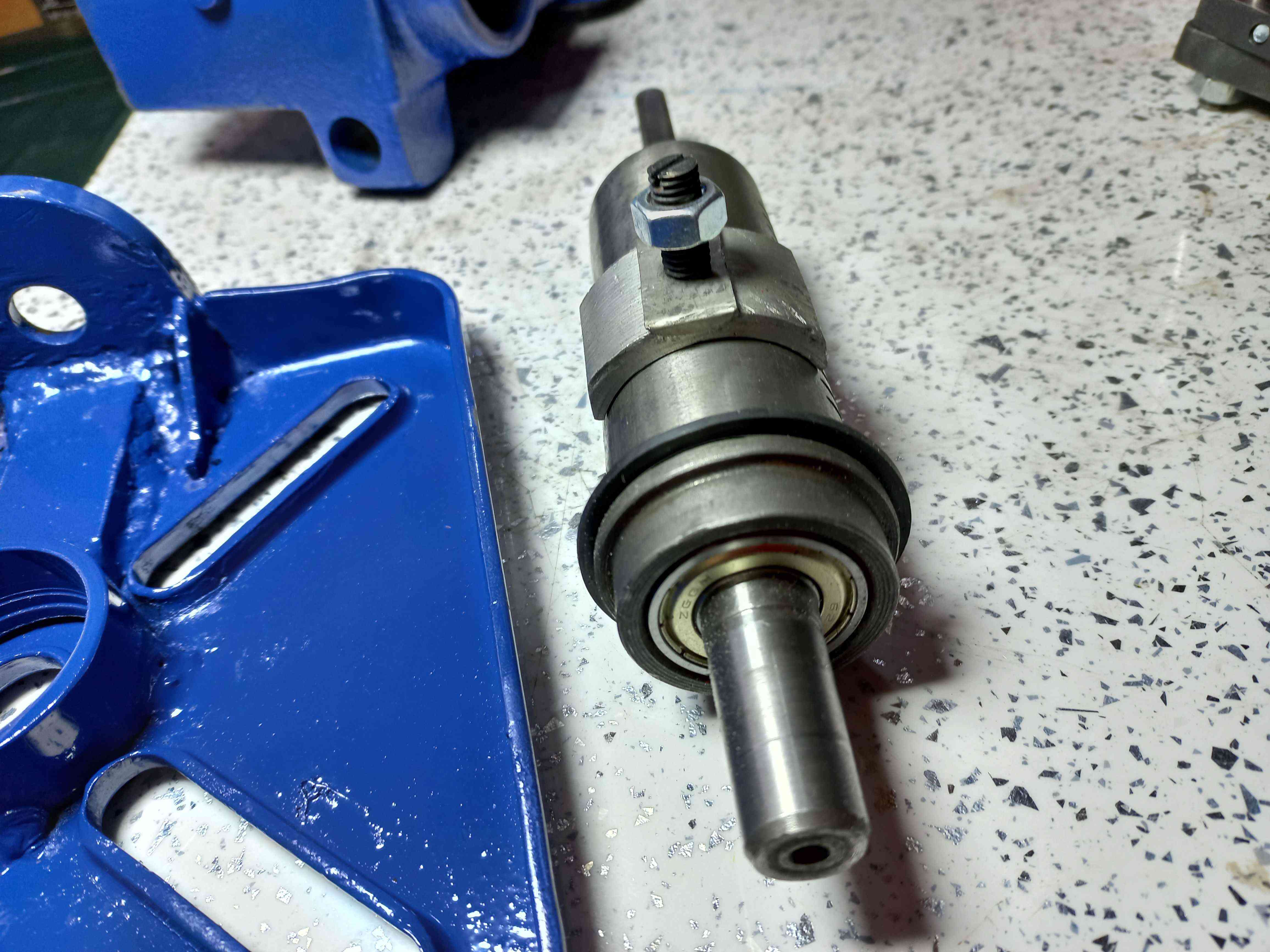

With the help of this insert, the backlash of the quill of the machine is eliminated.
Attachment 41759Attachment 41760
Attachment 41761Attachment 41762
