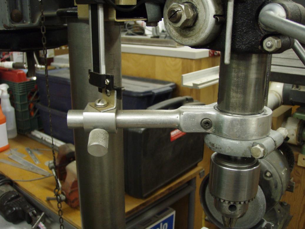

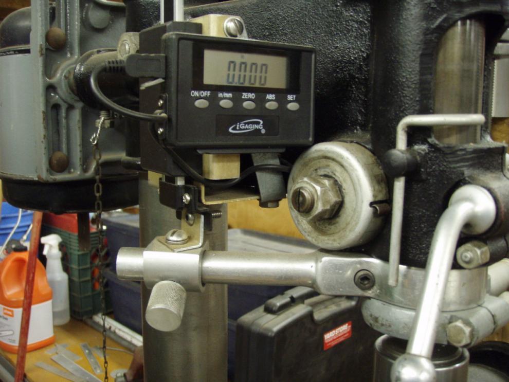

I used another iGaging magnetic DRO on the Quill of a old Delta Drill Press. I used an old drill motor side handle for the quill attachment.Attachment 1080Attachment 1081
