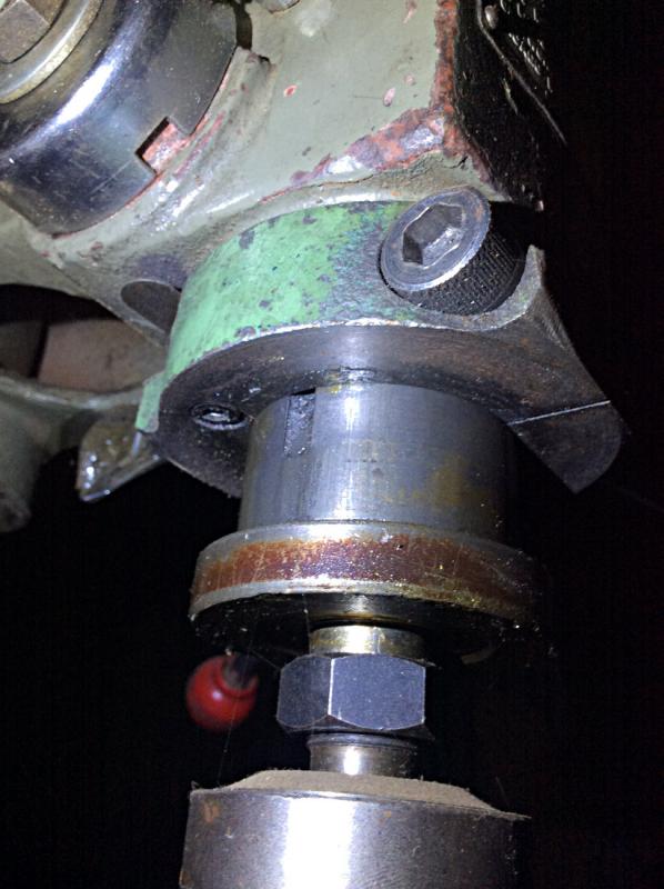

Instead of modifying the casting you could bolt something like a shaft collar that fits the quill to the bottom and this will at least allow you to tighten up one end. You will lose some travel.
Attachment 23012

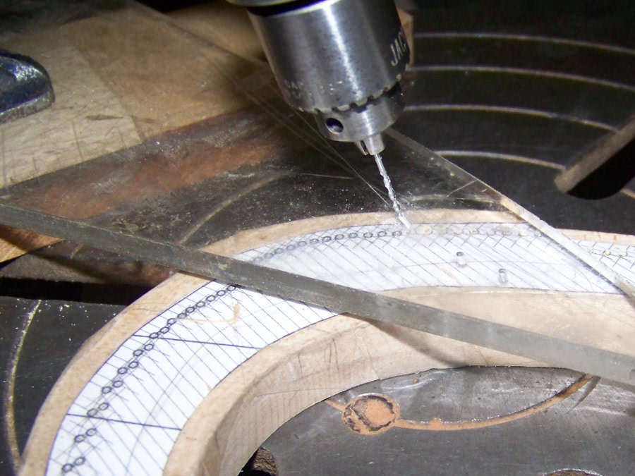

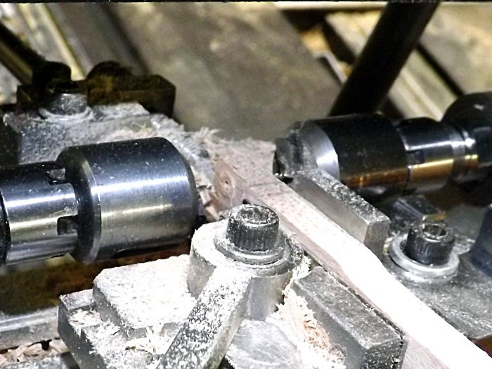

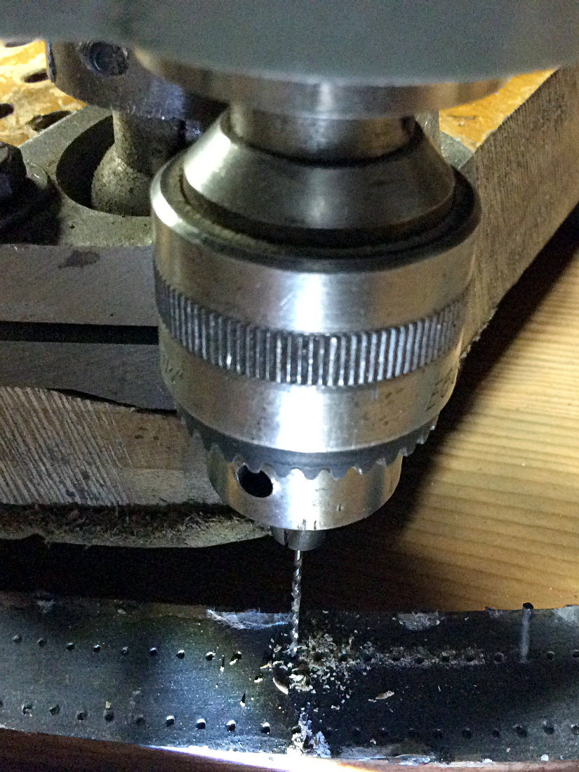

But with little drills that’s only part of the reason holes can end up in the wrong place, especially in wood. Here are some different strategies I use depending on the hole geometry, drill length and point, and what preparation I can do.
- Clark
Attachment 23013Attachment 23014Attachment 23015
