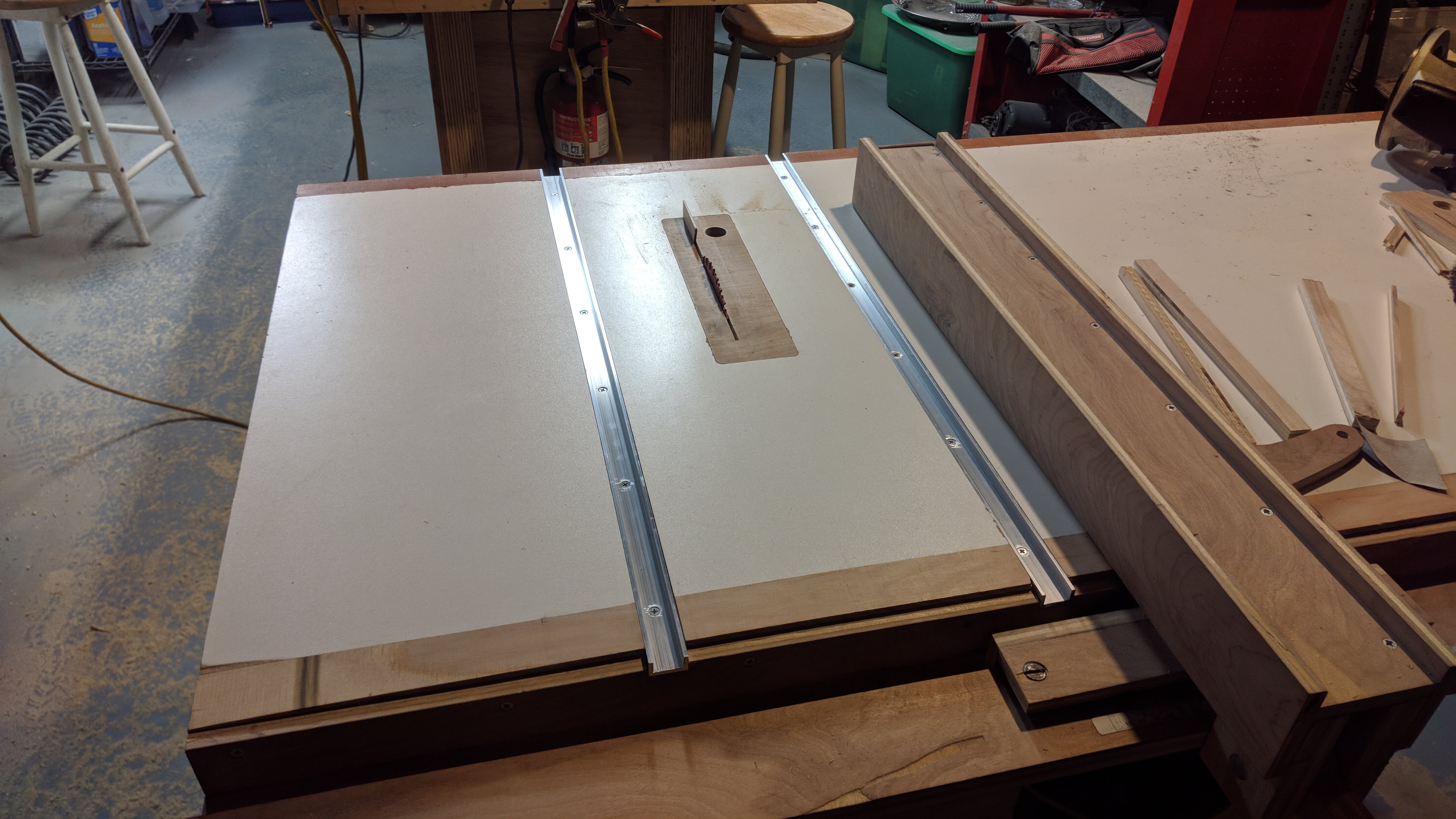

1 Attachment(s)
I had no idea that facebook marketplace existed haha. It seems to be used even more than craigslist and generally cheaper for tools too, just looking at what's up for sale right now. I'll definitely keep an eye out for something that looks good, thanks for the tip!

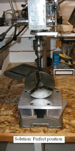

1 Attachment(s)
I have and have had a small, 8" drill press for several decades now. It is probably somewhat less than your HF model as it is only a three speed. It has followed me around the country and I have made several mods and accessories that make it a lot more useful. One is a better depth stop that I cobbled together with one of those speed nuts. This changed the depth stop from a never used thing to one that I use all the time. I also added a lamp for better light on the table. And I have a kit of aluminum pieces which allow me to elevate the base to any level between where the regular table lets off and the where the base itself is. So the vertical range under the quill is greatly extended. You can see a couple of those mods here.
Attachment 25011
I used it for just about everything until a couple of years ago when I purchased a HF floor stand, 20" model. Now the two stand side by side with the 20" one behind a bench and the 8" one on the end of it. I find the old 8" handy for many things, not the least of which is for cutting countersinks on holes that I drill on the big boy. The easy adjust depth stop makes this a quick and repeatable operation. With the depth stop just a bit higher the counter sink cutter does a great job of deburring and chamfering those drilled holes. I think I am going to keep it.

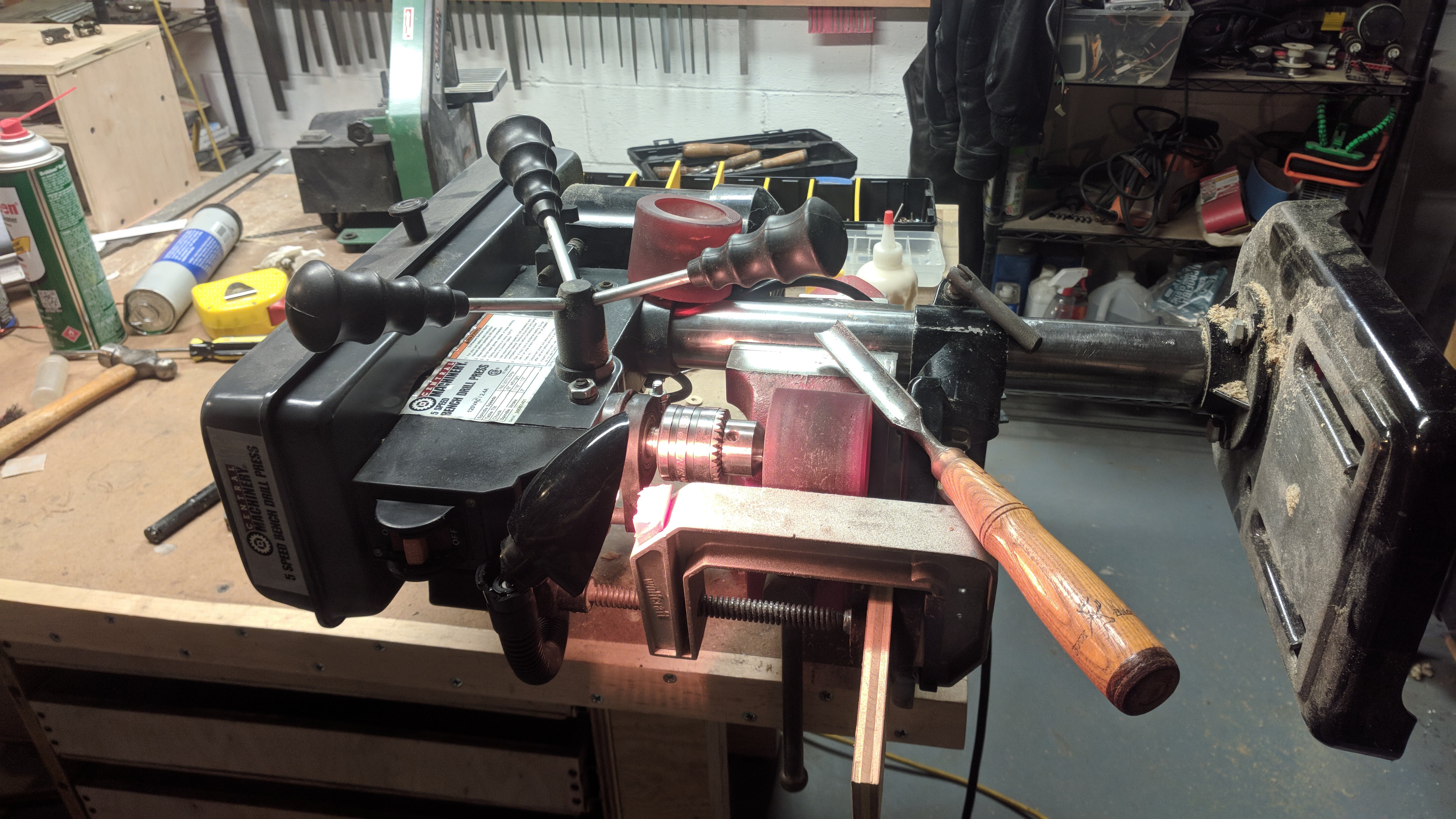

1 Attachment(s)
Lots of good suggestions, thanks!
I briefly looked into trying to get that 3 phase motor working, but the only supply in my shop is a 120V 20A breaker, and this thing needs 3 phase 240V. Just more trouble than it's worth for now, so I'll hold onto it until I decide to get proper power for it.
I finally chopped up a light weight workout bench press that was sitting around for decades, so I'm making a 2x72 grinder out of it. I pretty much figured out the dimensions and design, and I think I'll make a WIP thread for it. Also got some free longboard wheels from a friend, so I clamped my drill press sideways to use it as a lathe to true and crown them. The poly wheels actually cut, sand, and file pretty nicely. I made sure the wheels could slip on their shaft long before the chisel could catch and fly, and checked before I really started.
